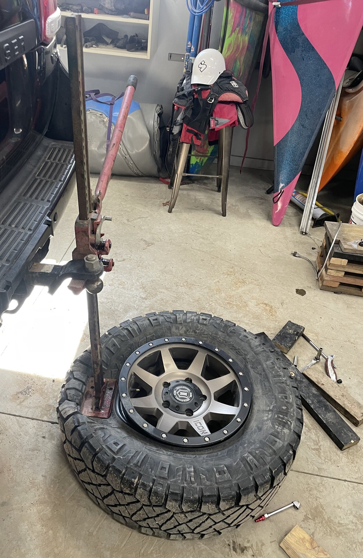

Happy to report all 5 of the Denso sensors I ordered from Amazon were self-installed and they're working without issue.
Happy to report all 5 of the Denso sensors I ordered from Amazon were self-installed and they're working without issue. View attachment 3566900
Very cool, nicely done utilizing the hi-lift to break the bead. Never crossed my mind to use it in this fashion.
Aaaaannndddd... now I won't be selling the farm jack I've had in my shed for years.
