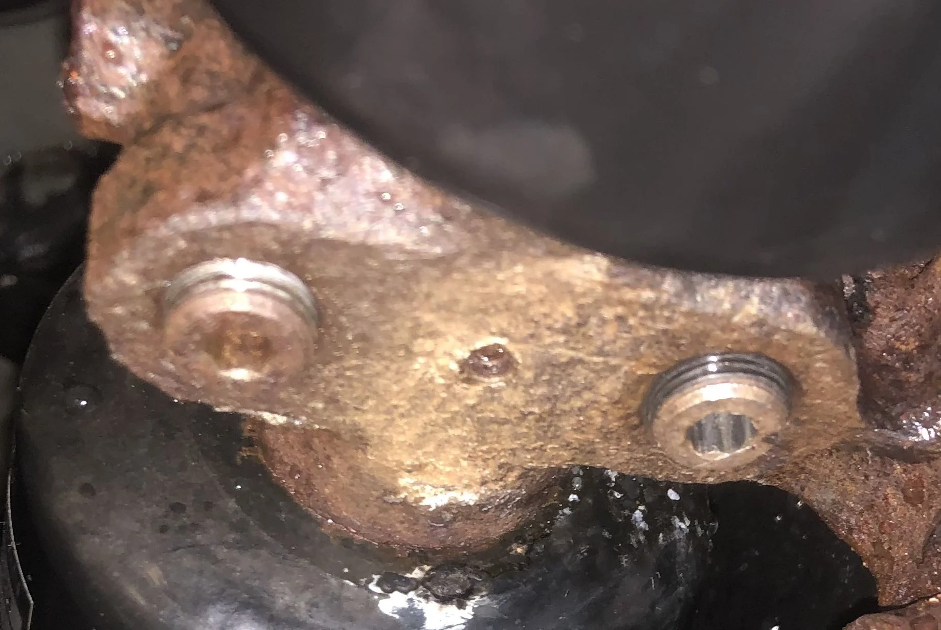

The one on the right side of this photo is the one that stuck. This is on a'16 that lived its life in the NYC area, otherwise minimal corrosion (frame welds only). In four years the kdss valve assembly is already pretty badly rusted.

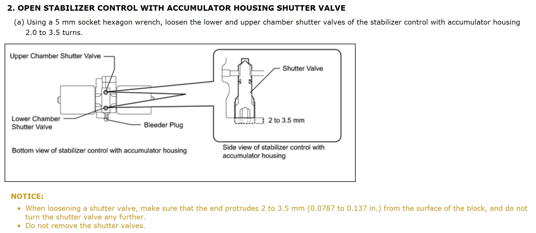

Posted before, but why not again.
Factory info, 2 to 3.5 turns out MAX.
Factory torque specs.
Info directly from the source, Toyota TIS.
TIS (toyota.com)
