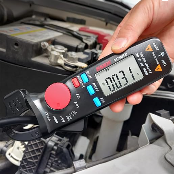

He may have used one of these clamp meters which does not require you to disconnect the negative side and potentially overload your volt meter amp capacity. Or otherwise yet...

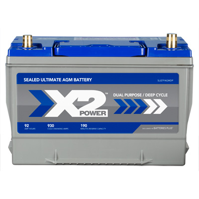

The X2 battery that Batteries plus sells is the best 27F battery. 92AH Even better than the Odessey. I believe East Penn makes it. I just put one in my 2014 I just picked up. I had 2 of them previously last 10 years and sold with my 2004 super duty and they still may be going lol

My hesitation is with bAtTeRIeS pLuS bULbS. They’re not easy to deal with regarding warranty claims. Ask me how I know.

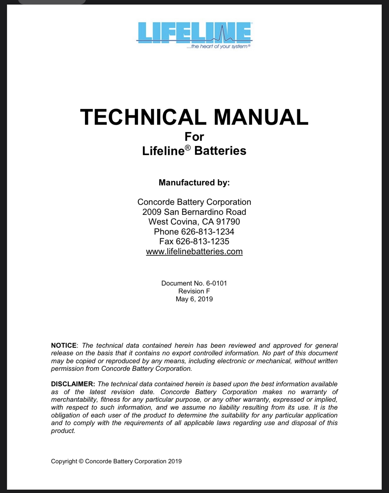

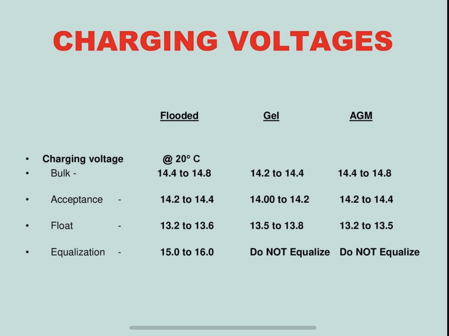

I looked up the lifeline manual as I cannot believe that summary you are showing. Its in fact not in there, so what is the source of the summary? It seems way out there voltage wise or perhaps those are initial ideal charging conditions for a fully empty battery.
As stated before, common available Lead Acid batteries and the one installed in the 200 series have an optimum charge voltage of around 13.8 to 14.0 volt at 15% current of its capacity (i.e. 15 amp for a 100 Ah) and AGM is around 14.5 to 14.8 volt at 25% of its capacity (i.e. 25 amp for a 100 Ah). This does vary when the battery is completely empty or faces very cold conditions. I understand the power management system on a BMW takes care of those differences including the optimum charging current as a function of battery condition, be it they have the battery in the boot at pretty ideal (ambient) temperature conditions, so they do rightly use AGM's. While I have not studied this for the 200 series OEM alternator, i understand at initial ambient temp conditions it will do around 13.8 volt dropping to around 13.3 volt at high temperatures. Not much smartness going on there, which also keeps it simple and arguable more reliable.
I therefore conclude that putting an AGM battery under the hood of a 200 series is low value for money. I would recommend buying a good quality and if you like higher capacity lead acid battery than factory, making max use of the available space and as required go to the effort of modifying the terminals to make it work. Or adding a second lead acid in parallel.

If you dig deeper in those same references
