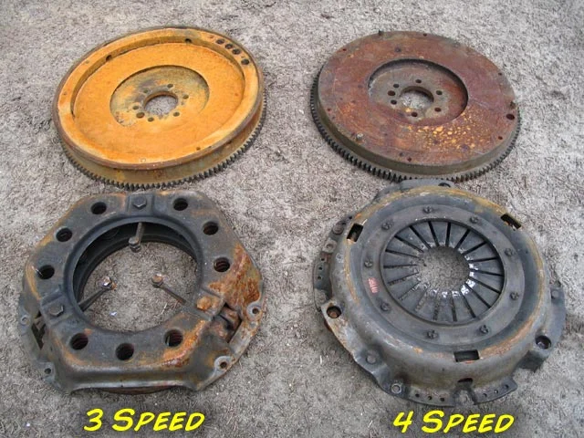

I got out the scale for fun and was surprised that both the 3 speed and 4 speed pressure plates weighed in at 25lbs. The 4 speed flywheel is 34lbs and the 3 speed is 37lbs.
Plus - look at where the mass is located on the 3 spd - out at the edges...
Xactly.
Total mass is about the same, but the early FW concentrates the mass on the periphery giving the unit a noticeably higher polar moment of inertia.
One of those FW's on a 4.4litre 2F is almost stall-proof.
However, that same high polar moment that prevents the crankshaft slowing to a stall, also prevents the engine from speeding up easily. For mud bogs or a quick revving turbo engine, the flat FW is a better choice.
