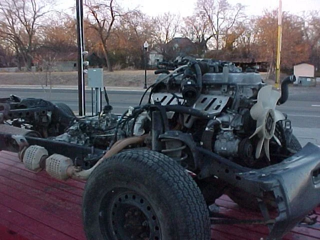

Seems as if it's easier to buy something like this, and skip all this "hot rod tech"
https://forum.ih8mud.com/showthread.php?t=74203
:flipoff2: :flipoff2: :flipoff2:
attachment.php
