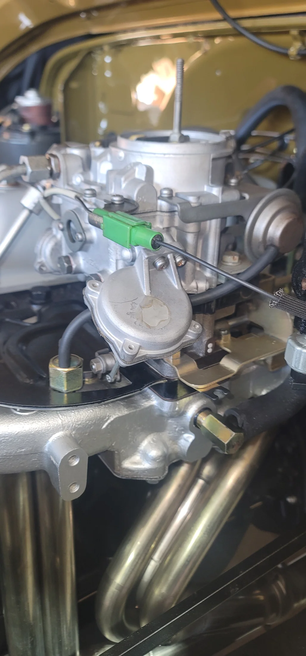

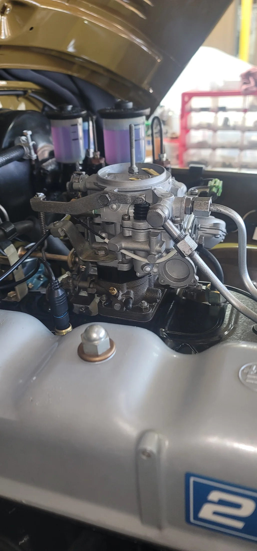

So just a little back round. 10 years or more back, I had Jim C desmog my 77 and at that time we bypassed the vacuum advance by capping off the ported connection on both the dizzy and the carb and the engine ran fine. I recently performed a body off and had the engine rebuilt as well as sending the carb out for rebuilding. I also added a ss header with a Remflex gasket and installed block off plate with gasket on the bottom of the intake manifold. On the initial startup, we notice the vacuum cutoff solenoid was not functioning and replaced it with a single wire Nakamoto part # 21062 61010 I believe from Racer LLC. The plug didn't match so I had to solder the old connector onto the FCS.
At this point, as I read in other posts, the engine will not idle unless the choke is out and around 1000 to 1100 rpms. I removed the FCS and inspected the o-ring and added some grease to it before reinstalling and still no idle. I also retorqued the Remflex gasket since the engine heated up a bit and just tweaked them slightly. The instructions on the gasket was around 27ftlbs and maybe tighten a quarter turn on intake and exhaust bolts.
Correct me if I'm wrong, there is only two vacuum ports on the intake, one to the carb and the other to the brake booster.
1. Is it possible even if the new FCS is making a clicking noise that it is not seating and causing my issue. Is Nakomoto the only supplier of the single wire FCS from Racer LLC??
2. Should I isolate the vacuum line going to the brake booster and see if this could be the issue as far as a vacuum leak?
3. Dizzy was dropped in by engine builder at TDC and hasn't been removed since.
4. Am I missing the any other than the 2 vacuum ports of the intake manifold?
Any suggestions would be greatly appreciated.
Thanks Dave

As per the second pic, I have both the vacuum port capped on the base of the carburetor.
Don't do this, but you can leave them open and it wouldn't cause your issue, they won't make the engine stick at 1100. It just causes air leaks when the throttle plate opens as they are ported vacuum. Sticking at 1100 is caused by the primary throttle shaft being bound up by something or misaligned or another major issue like a vacuum leak.
