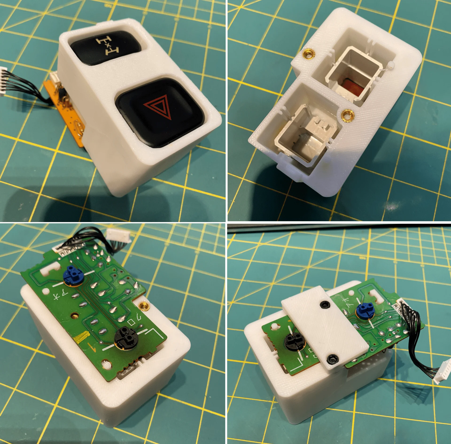

Going to relocate the Hazard/DiffLock switches to the ashtray.

If you’re interested in chasing up new connectors for the PCB connection lead it is a Molex CONN RCPT HOUSING 2MM 7POS SGL part number 51004-0700
Data sheet https://www.onlinecomponents.com/datasheet/510040700-11869134/
The pins are Molex CONN SOCKET 24-30AWG CRIMP TIN Part No 0500118000
Thanks a lot. I was scratching my head on how to extend the cable.
And now you have me rethinking my whole right side - left side swap with the ashtray panel possibility.............
@Ayune is experimenting another way to solve the problem. Our goal is to release the hazard/diflock panel.
