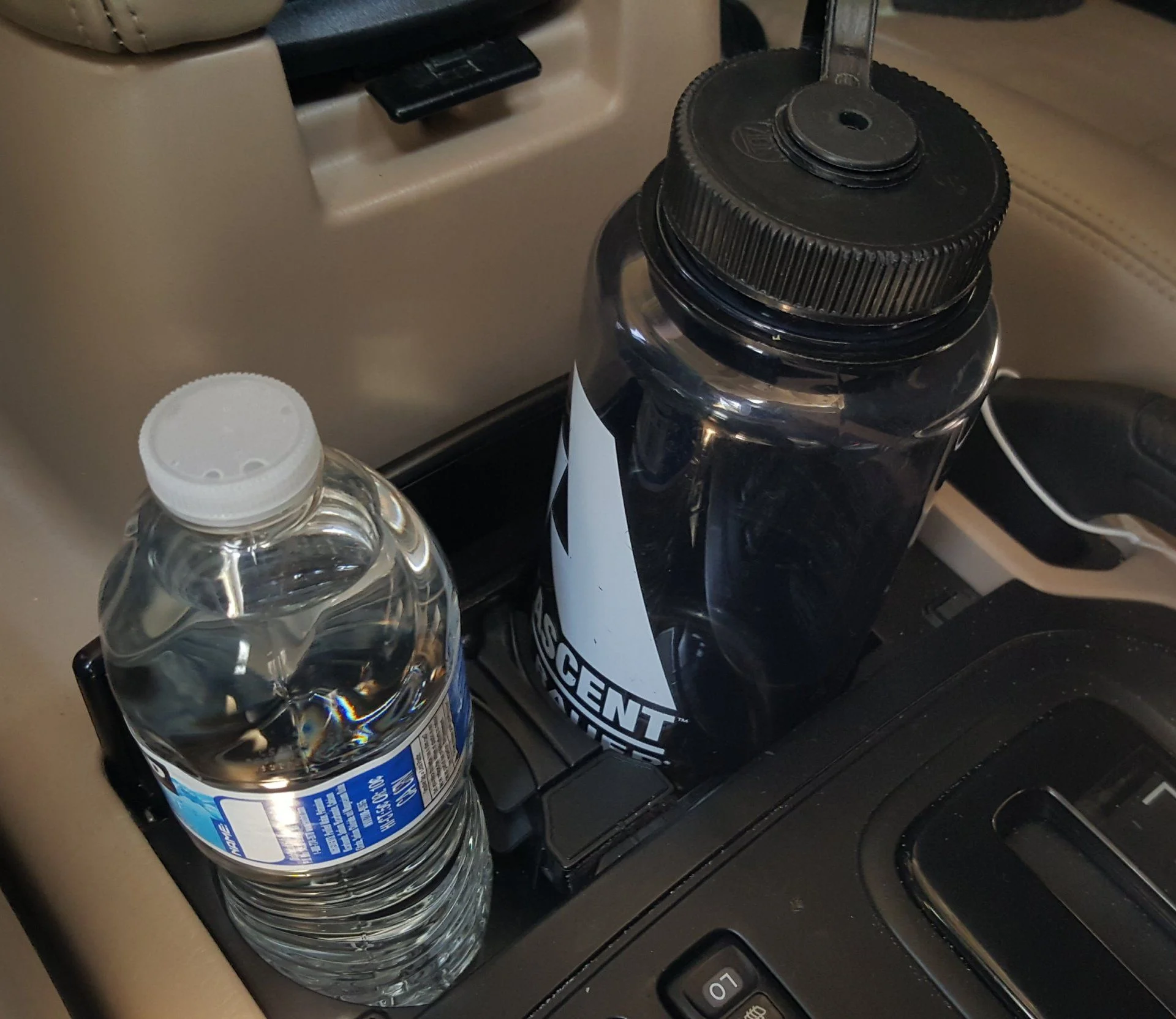

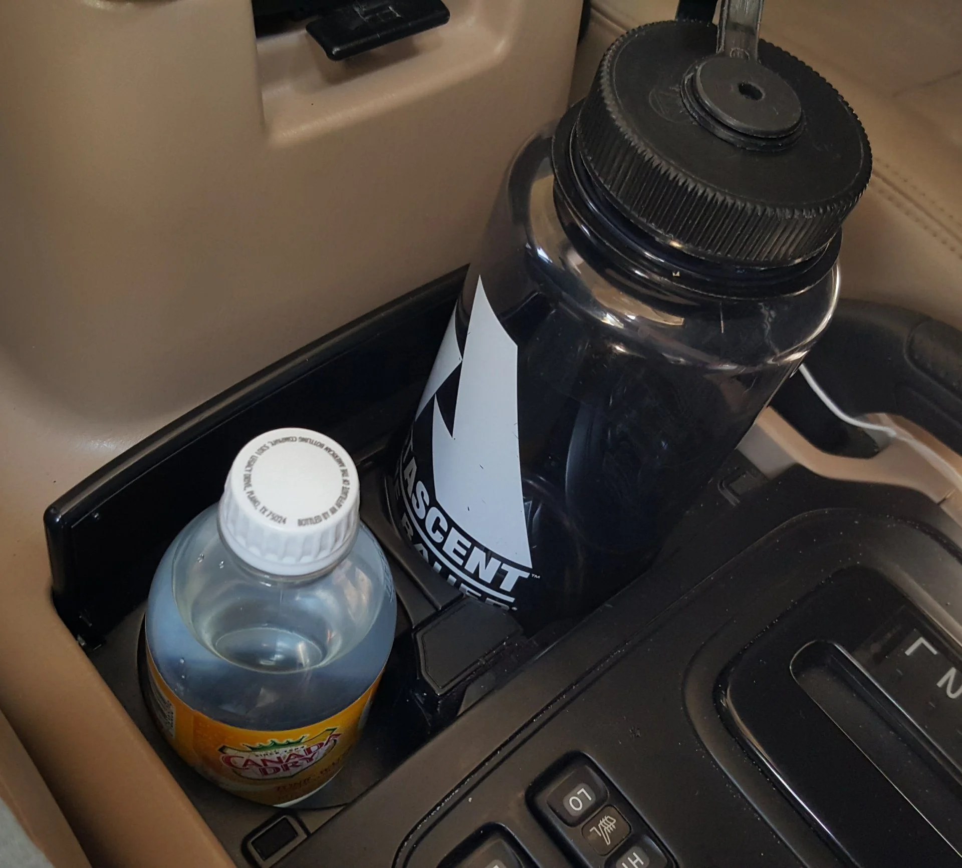

Actually, my 2000 LC has the butterfly. In fact, there are 3 positions for it, left/center/right. If I move it to the right position, it fits a Nalgene bottle on the left perfectly and still room for something on the right like a 500ml store bought water bottle or a soda can.

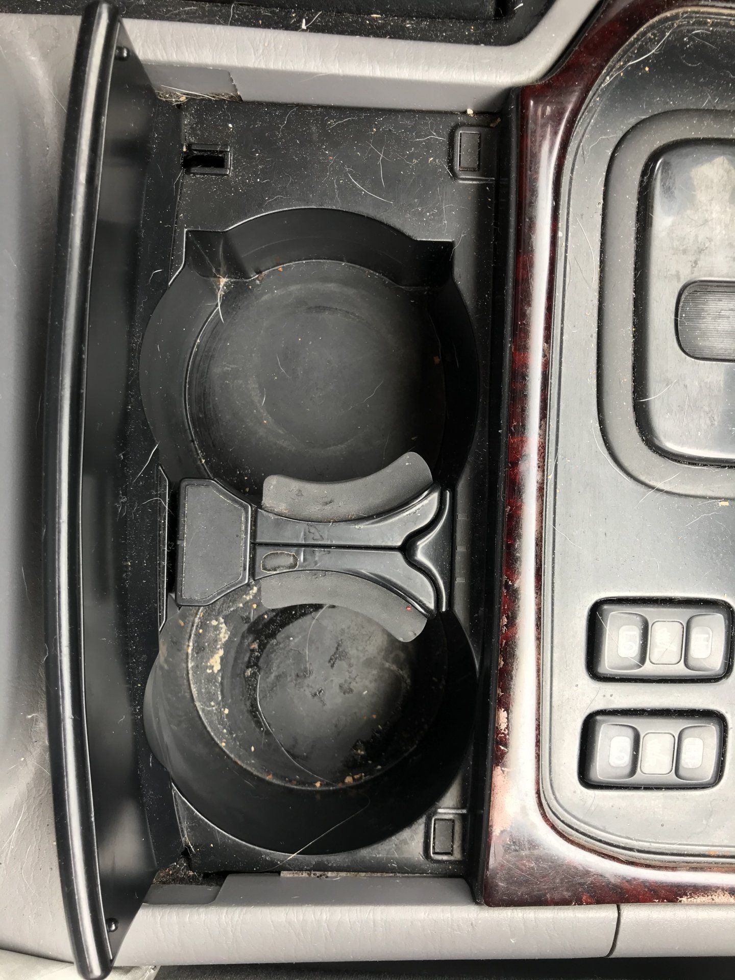

Can you take a photo of your Cupholder? I have the butterfly too on my 2000 LC. But there is only one position.
Huh... ok I thought that when I was researching it that it was 98-02 didn't have the butterfly except for the LXs. But maybe I read it wrong.
Same here. I have a 2002 and it has the 3-position butterfly with rubber wings. We can fit a 32oz Nalgene on one side and a smaller thing on the other. Depth is the bigger concern as with the gear selector in 1, it will interfere with the top of a Nalgene. Also fitting 2x Nalgenes side by side would be fantastic, so the added diameter you are working with is great. I understand not everyone has the same thing in their trucks or their personal wants/needs are the same. I was just giving my $0.02 on what my ideal setup would be - again that is deeper, wider, with one thing that provides adjustability for diameter and not two inserts that have to find a home when not in use. Doesn't mean I'm not still interested in the latter, just personally would prefer the former.

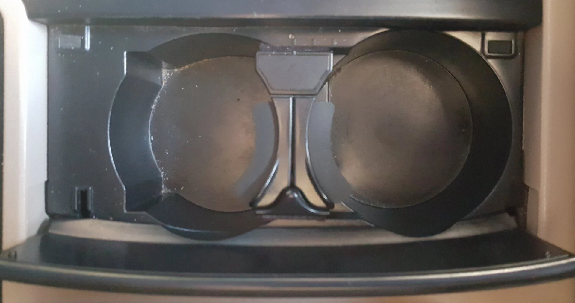

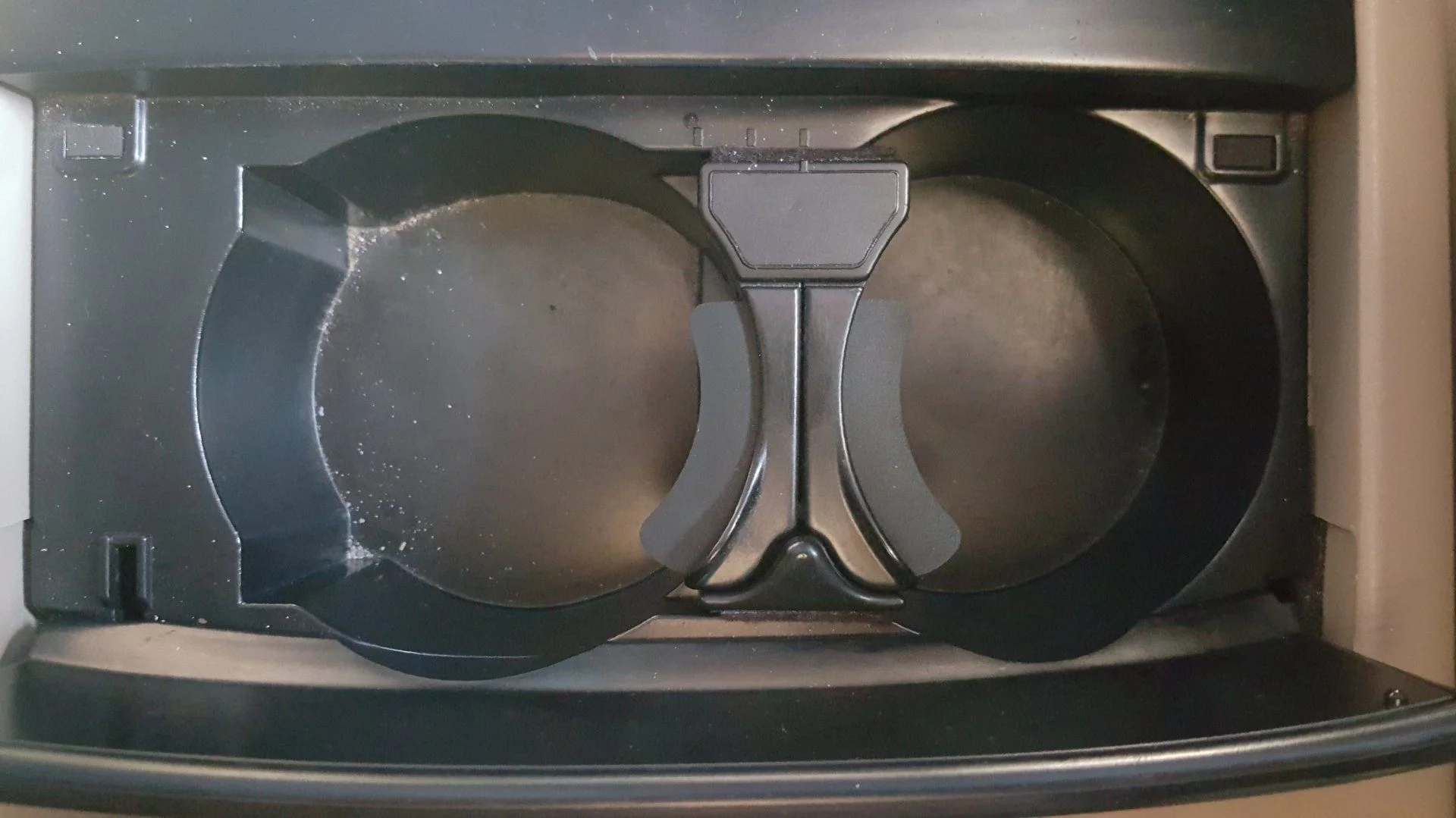

Here is a photo of the 3-position butterfly from my 2002. Please ignore the crumbs and mess. We just got back from a trip and haven’t cleaned up yet.
You can see the three marks for location. Maybe 1/4” between each for roughly 1/2” delta between large and small.

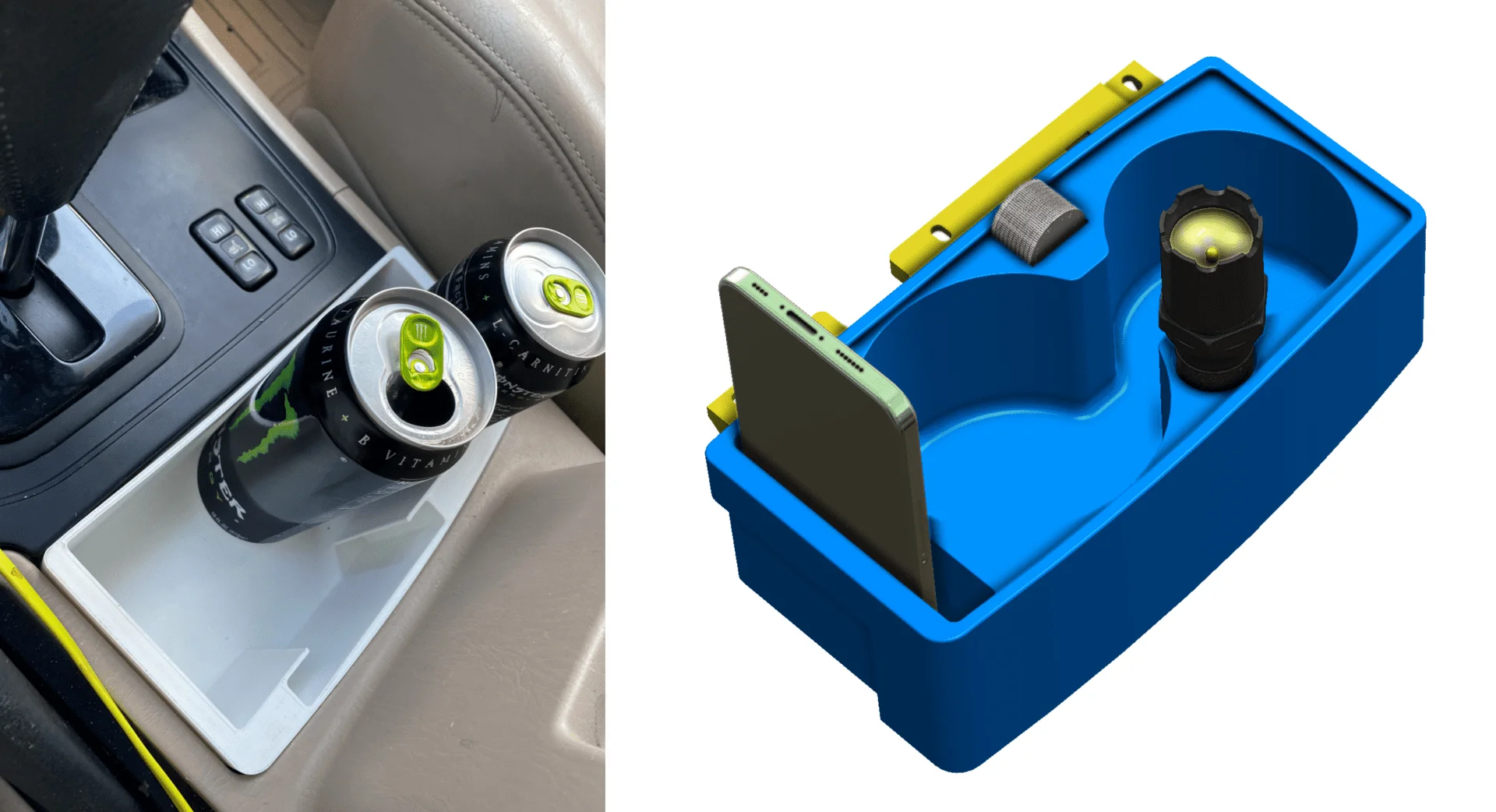

I drove from Columbus OH to Detroit and back today, 450 miles, with the cupholder prototype on my truck. No squeaks or rattles whatsoever. And surprisingly the cupholder is cooler to touch. My factory cuphoder was very hot when driving on freeway.
Thanks for your discussions. I read every one of them.
Right picture is what in my mind. Left hole diameter is 98 mm (3.86 in). Right hole diameter is 80 mm (3.15 in). Depth is 70 mm (2.75 in) and slightly less than 70 mm, respectively. Those dimensions are all larger than the factory ones.
The flashlight hole is 25 mm in diameter. It should hold my Surefire G2.

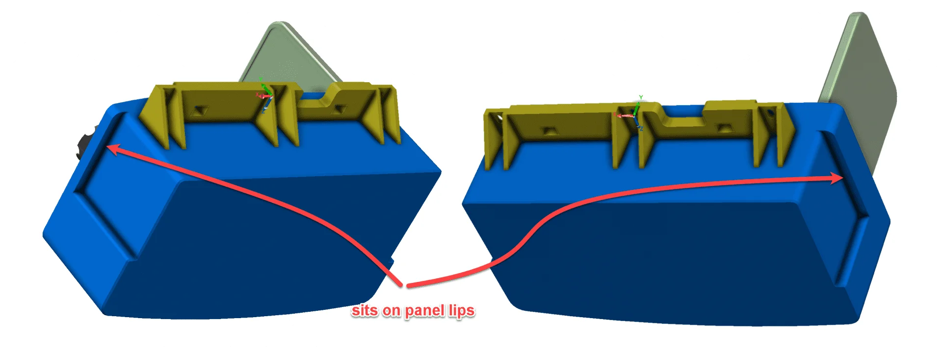

Ben, how does that cup holder depth work with the support bar that is in there? Seems like it would interfere.
The cupholder has mutiple contact areas with the factory structures. In the front, it is bolted to the center console panel. At the bottom, it sits flush with the metal suppurt bar. At left and right, it sits on plastic lips.
LOVE IT!!!! And like the small holder for the thin wallet, phone or whatever next to it!
