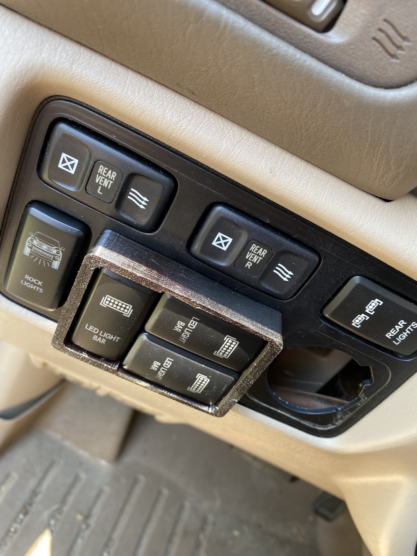

Can fit three Toyota switches in the rectangular plate. And move the mirror control to the blank square plate.
Who sent me this switch? ;)
Not a bad idea, but not an easy change for the RHD 100's - the square blank is LHS of the steering wheel and the Mirror switch is RHS of the steering wheel!

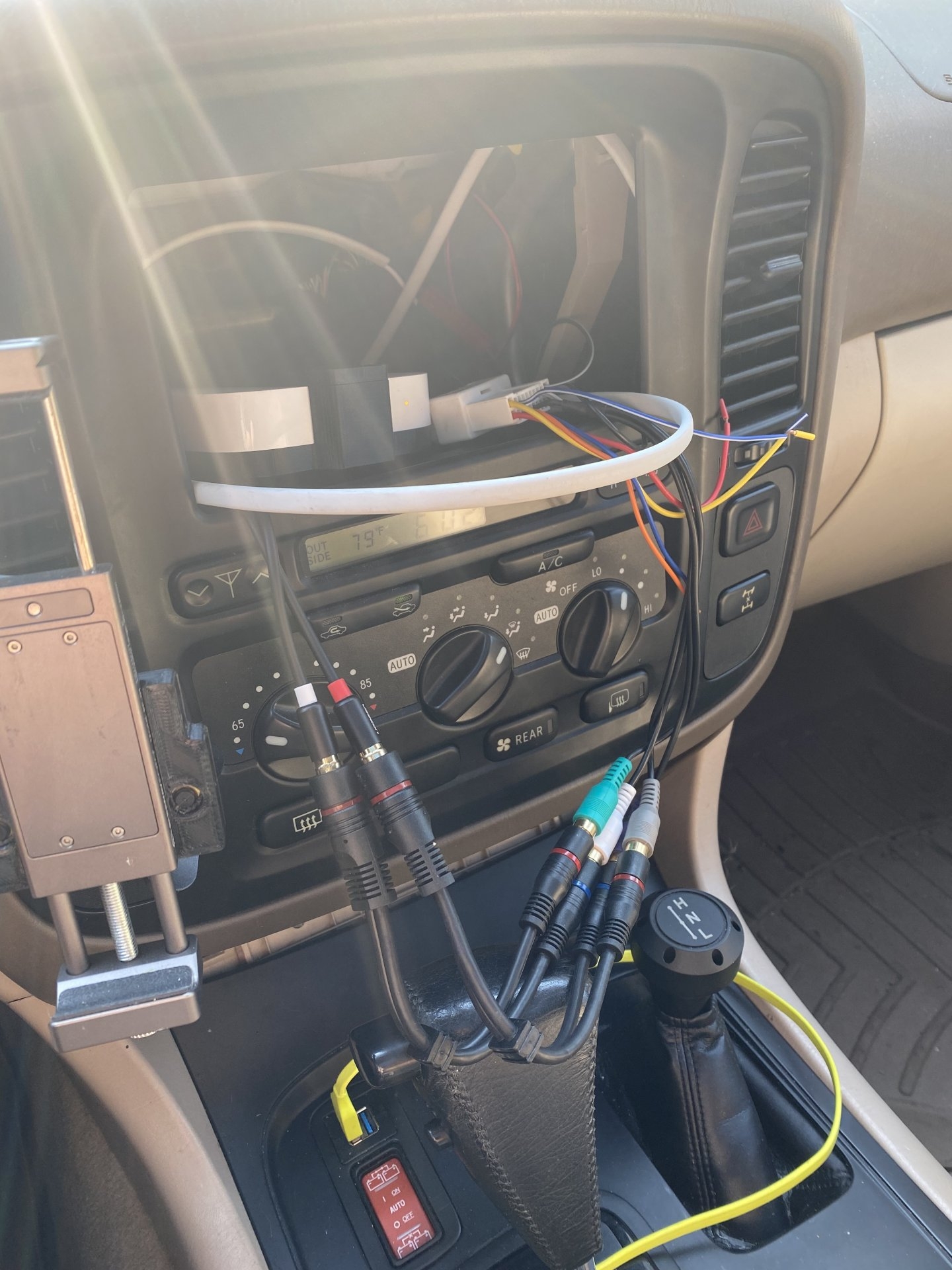

Wired an Apple Express (a WiFi router with airplay) to the truck. The Express functions as a bridge between my phone and the factory amp. Can connect to cellular and the Express WiFi at the same time.
You can stream lossless Apple Music, YouTube, or any online music/videos.
Apple Express uses 3.3V. I put a bulk converter inside the Express stepping down 12-15V to 3.3V.
Need to tug everything behind the console.
This is all I needed from a head unit. The Express does it all, streaming.

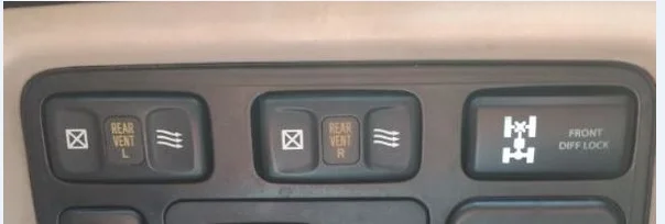

I ordered the Front Diff Lock switch. The switch lights up with headlights on and gets brighter when engaged. I like it because its a push toggle.

Tested the three-switch mount. The rectangular hole is a few millimeters short for three switches. Too bad it cannot be fully recessed.
This is one of the configurations. Planned to have
1. 1V2H (V: Vertical, H: Horozonral)
2. 3V
3. 2V (recessed)
Let me know what you think.

I assume since the small toyota switches are wider it would be even worse off? Any chance the right/left side thickness can be reduced or is it too unstable then? edit: nvm I am sure you already tried that.
