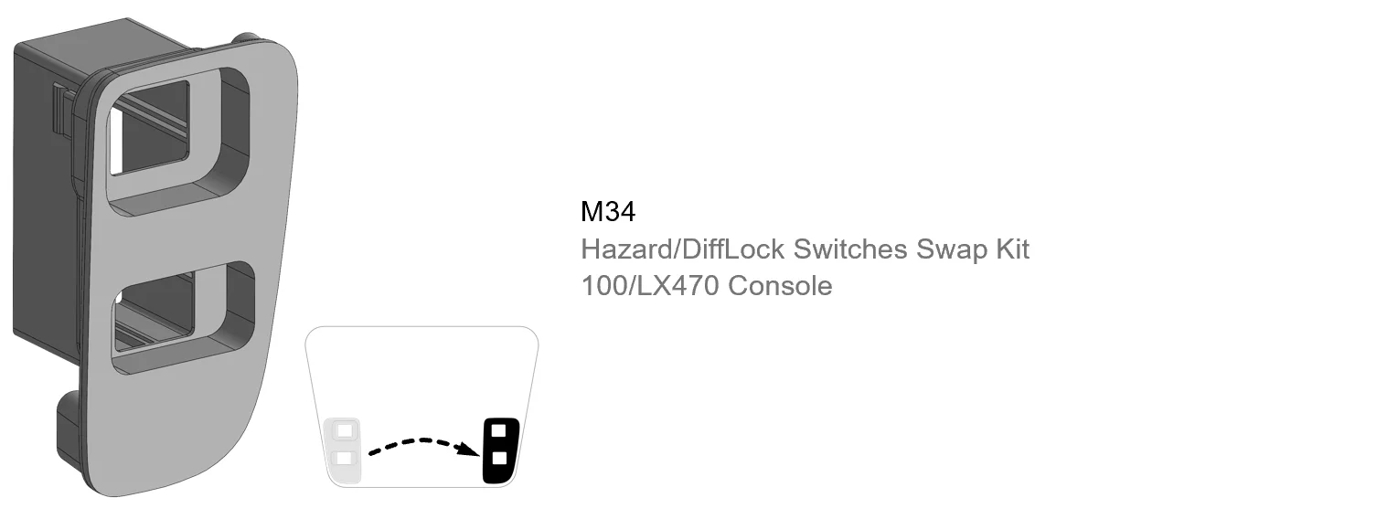

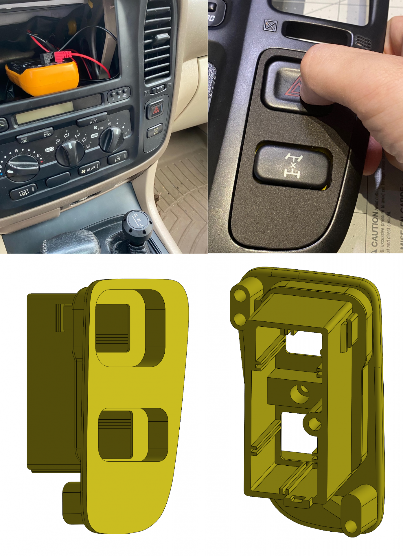

Make 34 Hazard/DiffLock Switches Swap Kit
This make mounts the Hazard/Difflock switches to the passenger side.

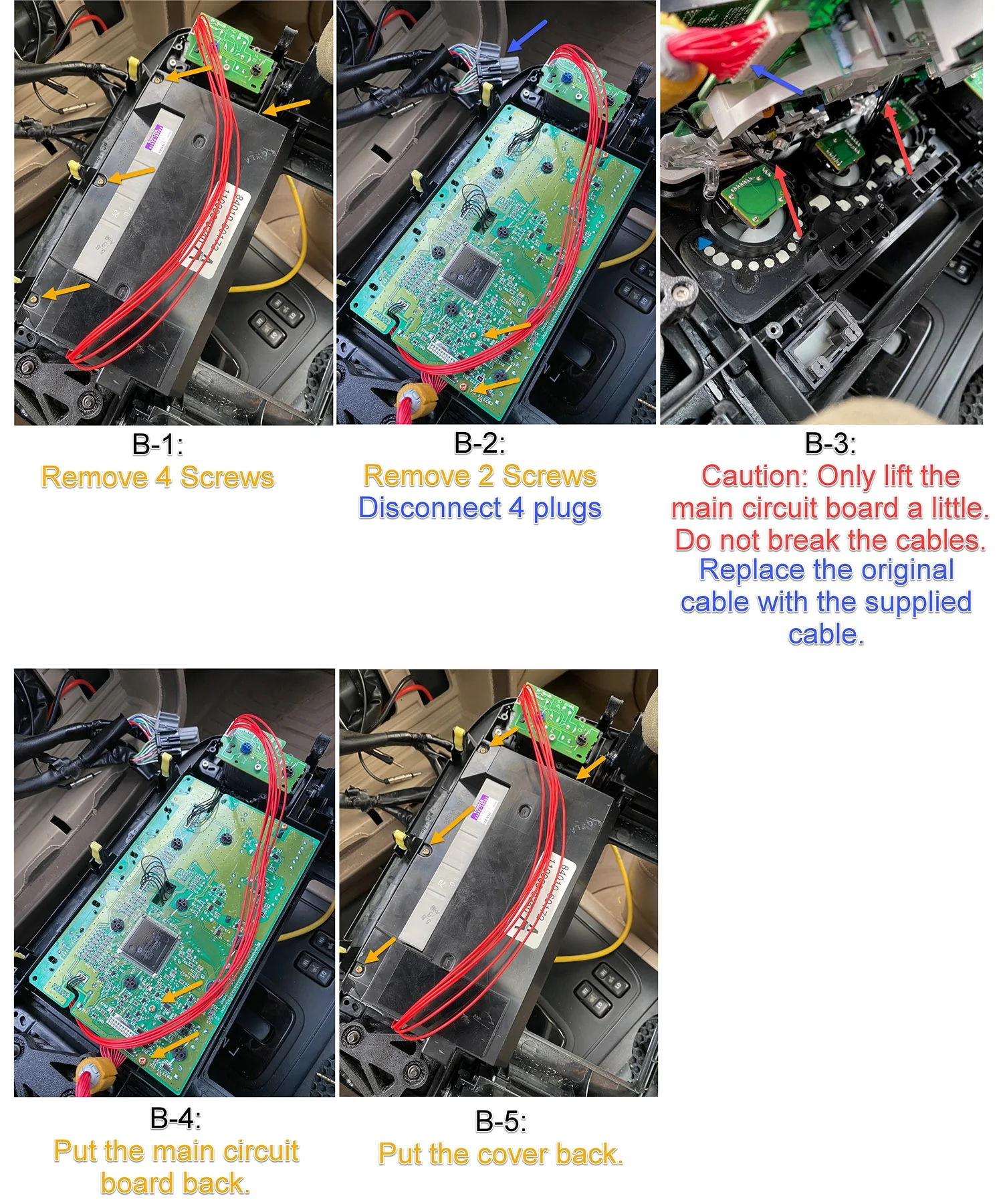

B. Replace the short factory cable.
B-1. Remove the main circuit board.
B-2. Remove the main circuit board.
B-3. Replace the short cable with the provided long one.
B-4. Put the main circuit board back.
B-5. Put the cover back.

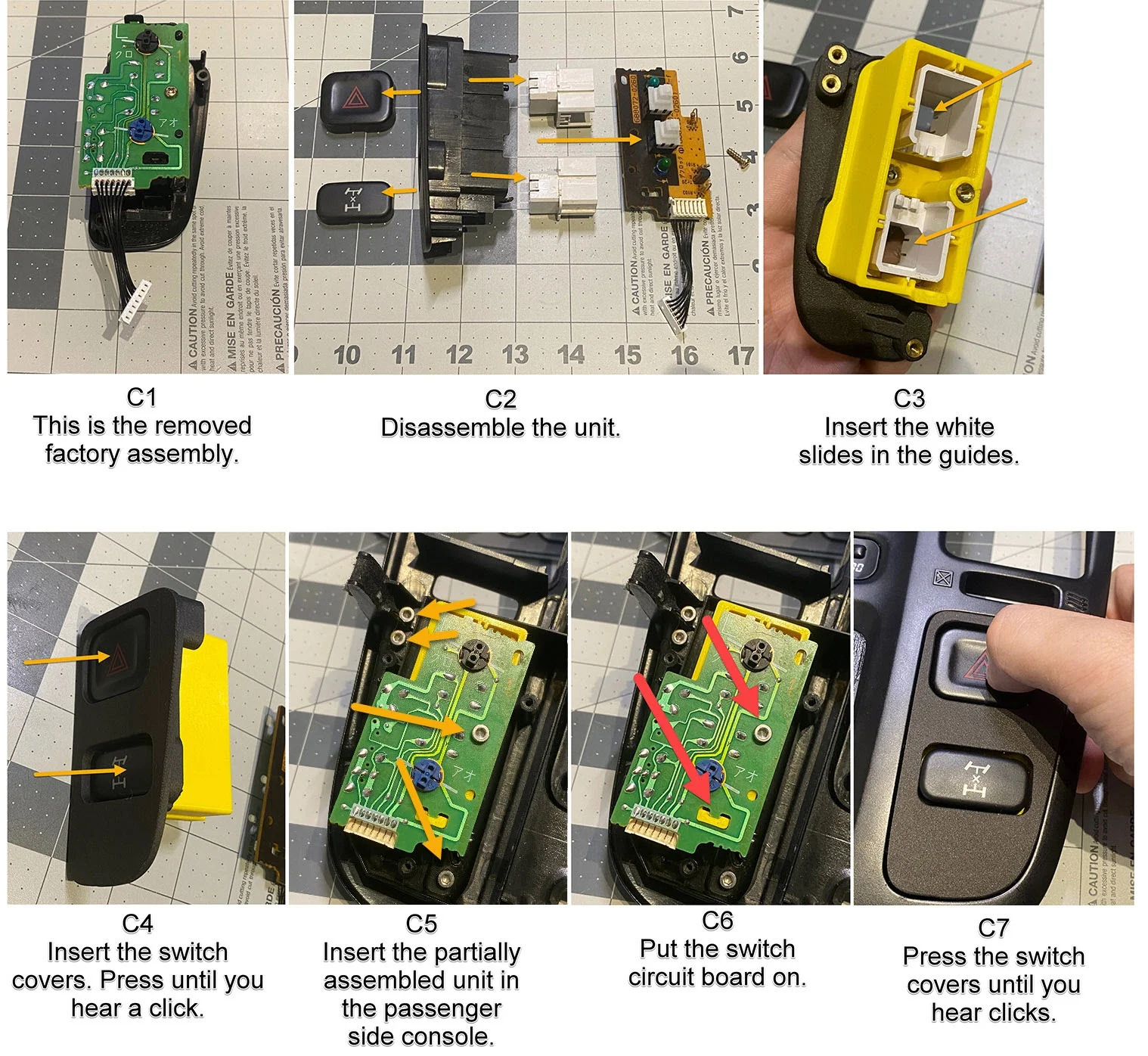

C. Install the swap kit.
C-1. This is the removed switch assembly from A-2.
C-2. Disassemble the unit.
C-3. Insert the white slides in the guides.
C-4. Insert the switch covers. Press until you hear a click.
C-5. Insert the partially assembled unit in the passenger side console.
C-6. Put the switch circuit board on.
C-7. Press the switch covers until you hear clicks.

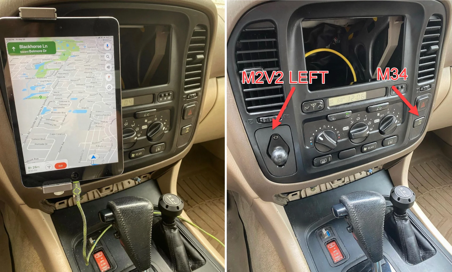

@suprarx7nut
That Make 34 is super trick.
I already have the Make 2 installed so probably won't do it but given the frequency of use between phone and those two switches, this is a brilliant idea.

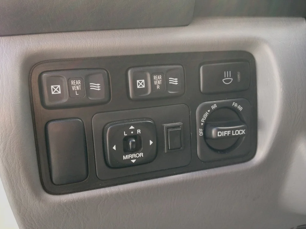

Hello,
Could you consider making an insert that goes where the factory diff lock switch sits - which will then accept a factory Toyota switch? 2 switches would be good even, but dont think that square shape is large enough...
Hello,
Pretty ironic timing for your post. I chatted with Ben about this yesterday. He is going to try to rig something up to accept two OEM style switches for that hole. I’m sure he’ll chime in.
Hello,
Anybody know if this piece has it's own pn? I've tried looking but I can't seem to find anything. Looks like it can only come as an assembly with the whole lower dash. I've cut mine up to accept several different switches and would like to start from a fresh slate.
