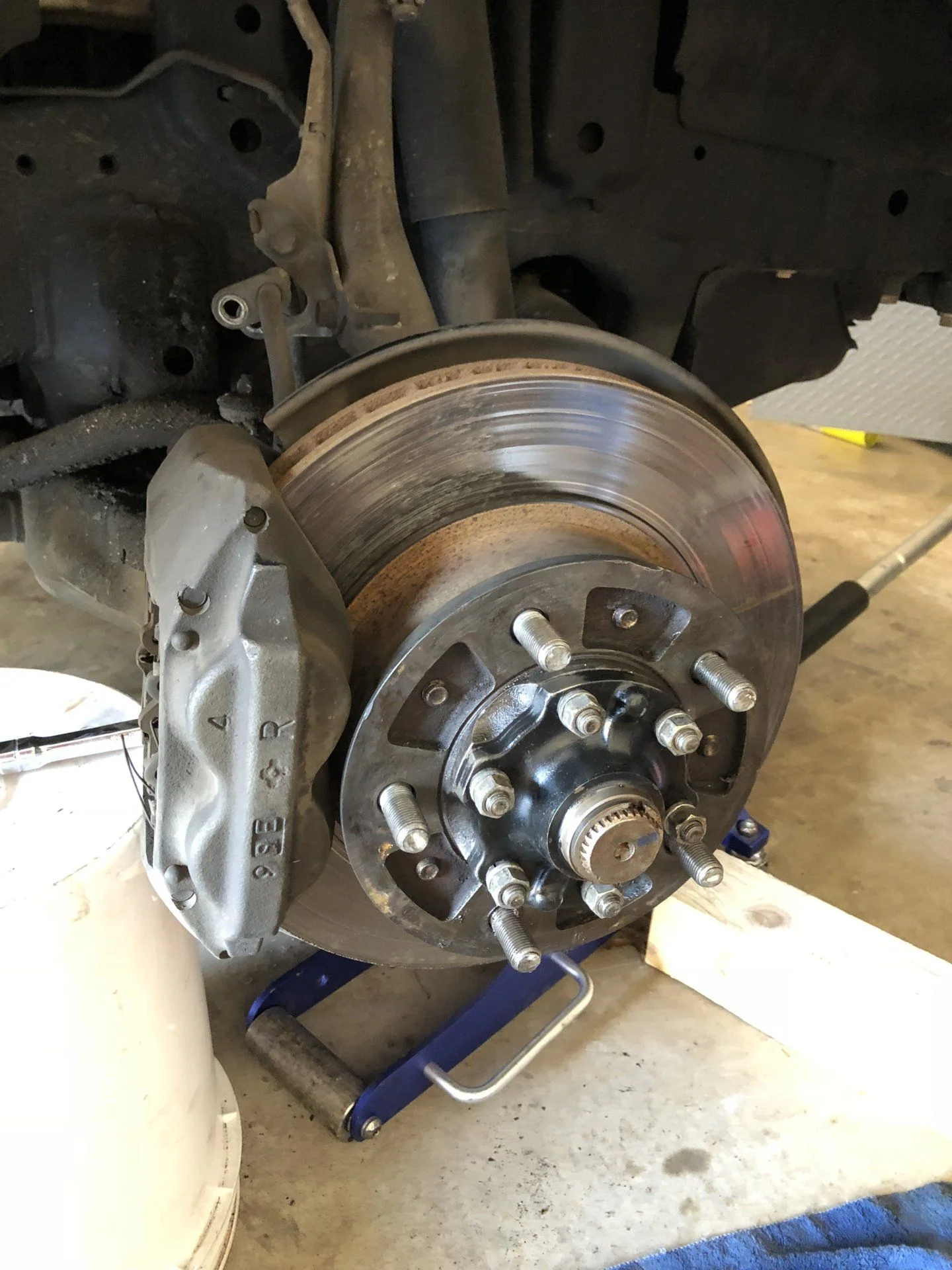

Now for the messy stuff! I had a bad clunking from my passenger front suspension and had a disticnt burning smell after highway driving. We believe my ball joints and inner tie rods could use replacement, however Connor mentioned that often the wheel bearings will wear and have a lot of play and can cause that odor. Upon jacking up the front, a wiggle of the front passenger wheel holding it at 12 o'clock and 6 o'clock revealed that Connors suspicion was absolutely correct! Wow that hing had some play. We didn't have a rebuild kit to fully rebuild and repack the bearings, however we did at least tear into them to clean and re-torque the various fasteners in the assembly. On my drivers side the outer bearing was in great shape so we just greased it well and re-assembled the hub. The passenger bearings, as expected were pretty shot. Luckily Connor had an out bearing we could use to get me by until I can do a full rebuild. I still plan to do a full rebuild, but this will get me by until then. It is much better than when we started!

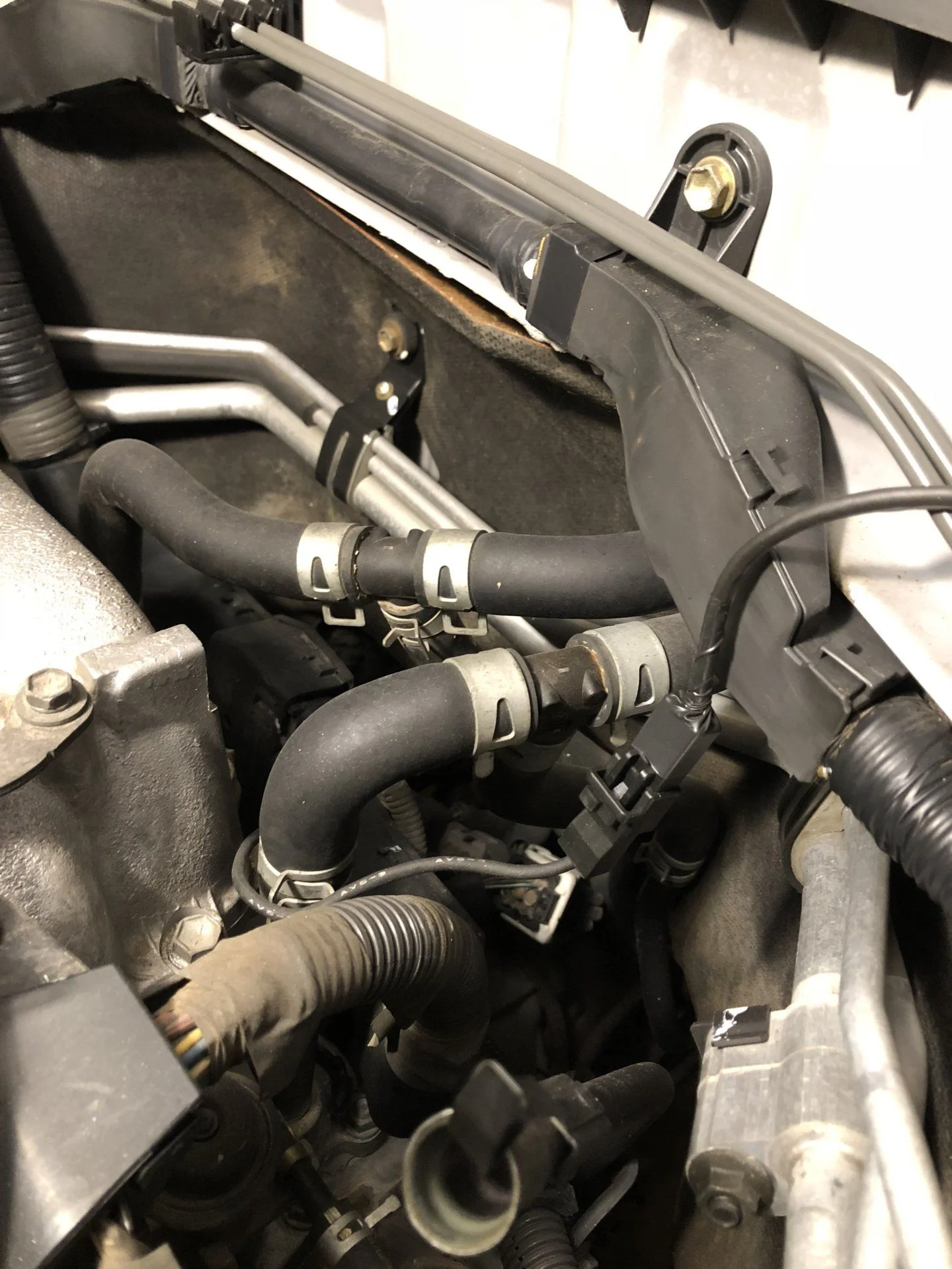

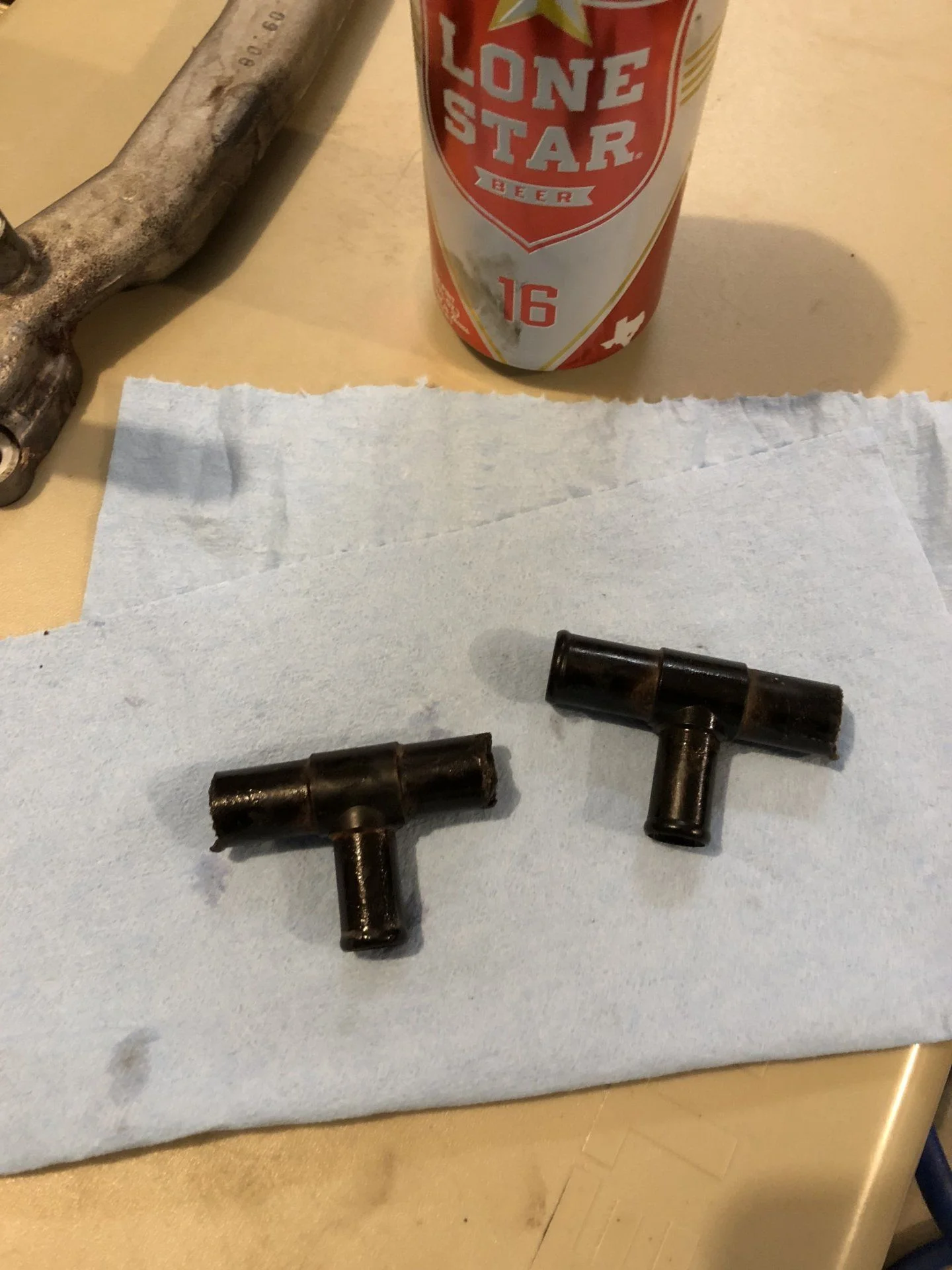

We did the heater T's. I know this has been covered a ton of times, so I won't go into too much detail. They had definitely been replaced before and luckily didn't break too badly upon removal. I took the liberty of flipping all the hose clamps so they could be undone from the top of the coolant lines as opposed to below for next time. I was a touch low on coolant, and we also noticed most of my coolant mixture was just distilled water, so we topped off with some Toyota coolant. You can see in the pic below that the old heater T's were in great shape, especially compared to some I have seen on these boards. Plus a guest appearance from our good friend for the day, Lone Star Beer....we finished quite a few of these!!

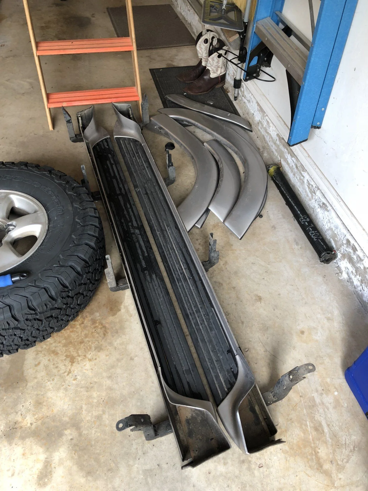

This morning we spent some time trying to detail the truck. I knew this truck had been in an accident or two, but unfortunately the body work done to repair it wasn't ideal. They sprayed the clear coat OVER the faded pinstripe below the windows. The adhesive leftover from a "Yokem Toyota" badge has also been cleared over as well. Nonetheless we spent some time cleaning up the paint that we could.
Throughout the two days on work breaks, we also used a heat gun and a plastic scraper to remove the 20-year old "wood" trim. Luckily, the black plastic underneath is immaculate. I fixed my saggy glove box, removed some black plastic pieces from the top of the liftgate that held a spoiler at one time or another, and dug out the 12" of antenna I had left so I could actually listen to the radio. My antenna was broken at somepoint, but we slid up the 12-ish inches I had remaining and put a rubber stopper on the top to keep it from falling all the way back in the hole. Not ideal but it will work until I get a full antenna.

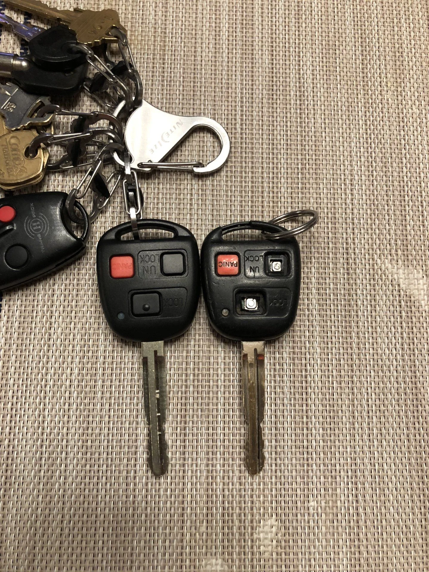

Secondly....this is HUGE for me. My only key I got with this truck was absolutely trashed. It is clearly aftermarket, which is not a problem for me, but it was missing the lock and unlock buttons, the case was cracked and scratched, and the physical key itself was slightly bent. Needless to say, it needed to be addressed sooner rather than later. I rolled the dice on an amazon key/fob blank. I had not gotten a straight answer on mud or other forums as to whether this would work or not. Some said you could program the lock/unlock/panic functions, but not the actual starting of the vehicle.... FWIW this key my truck came with is a master and the link I posted below will outline how to determine that if you do not know already.
Anyways, I had some free time tonight as my wife studied for her midterms (she's in occupational therapy graduate school), so i decided to play with the Amazon key I ordered and see if I could make any progress. Based on some instructions I decided to get the key cut first, as some instructions tell you to put the new key in the ON position. I grabbed the key and my original and headed to Lowes. The gentleman was not confident that his key machine could cut it, but he tried anyways and sure enough it read the old key and cut the new one just fine. He explained that they usually only charge people for their new keys and cut them for free and that he had no way to charge me. He just said "this one is on me." I love my local Lowe's and this is precisely why.
Once I got to the car I figured I could at lest turn the tumbler to make sure the key worked. To my surprise...it not only turned, it actually spun the starter and everything, however it wouldn't actually start the vehicle. I found that odd, every transponder key I have had wouldn't even let you turn the electronics on!
So I got home and found a great website with spectacular instructions. It is critical to note that the instructions for programming the Lock/unlock/panic functions are totally independent from the transponder instructions. Doing one WILL NOT complete the other. The links re below:
Transponder: Transponder Key Programming
Lock Functions: Remote Transponder Key Programming
It also explains very effectively the caps on how many master or valet keys you can have programmed to one vehicle. It conveniently gives instructions on how to erase all your masters but the one you use to erase them. I did not need to do this so I cannot vouch for it....nor can I vouch for the 03+ instructions.
Anyways, lucky for me IT WORKED! and I have a brand new, fully functional key. In fact, I am tempted to get another as my spare rather than this messed up one my truck came with. I can't compare it to an OEm key, because even my original key was not OEM, but it locks and unlocks the doors and I don't have to smash my fingers in it. I really hope this help others in this situation (at least us 98-02 guys), as I know most of us are in this situation having bought our rigs used with who knows how many owners. I will post the amazon link below. You can but 1 OR 2 keys. I went with 1 to be the guinea pig, but now wish I had gotten 2. I would suggest getting 2 as well because it makes the per-unit price much cheaper.

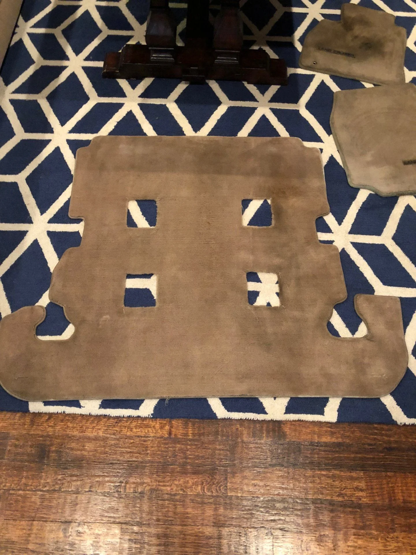

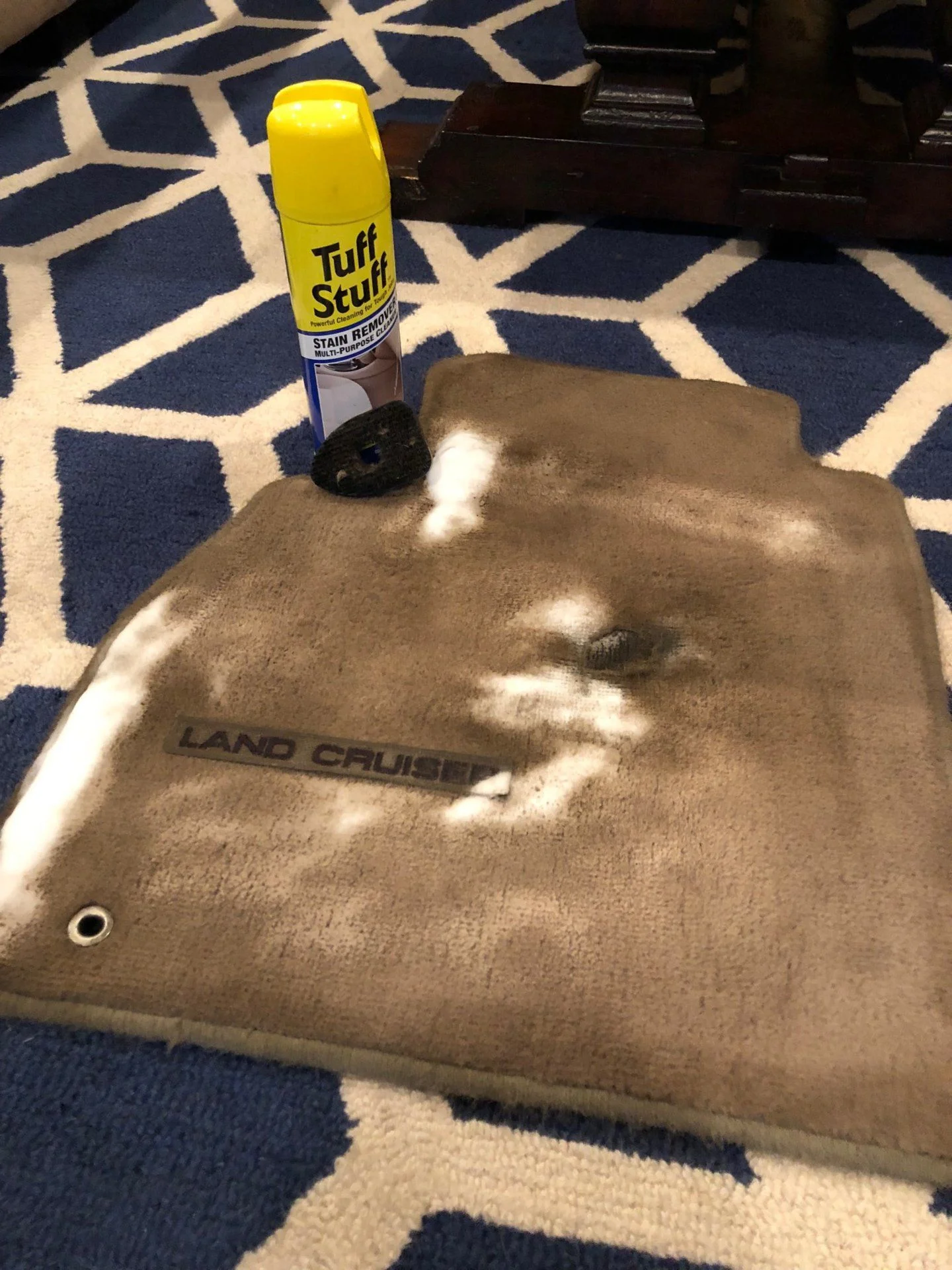

Got a lot of spring cleaning done on the cruiser. I took all the mats out and hit them with Tuff Stuff, scrubbed by hand with a coarse brush, then Shampooed them with the pet stain shampoo/vacuum things which sucked up all the residue from the Tuff Stuff. Back, middle row, and passenger front floor mats look great. Back row had the classic 15-year old Coca-Cola stain down the center where the 3rd row seats meet, and i got literally 99% of it up which is great.. The drivers one has a ton of wear where the driver's heel sits which is fine, but the gunk on this one is THICK. I will just hit it with more rounds as I have time. So far looks 10x better, and better than I could've expected for nearly 20 year old tan carpet. You can see in the pic below of the rear mat....the left side had been done and the right had not. Very clear difference!!
My passenger seat (along with my driver, but drivers seat is perfect) was "reupholstered" but I think the dealer treated it with something that just totally dried it out. I was at Autozone buying my normal regimen of Lexol Cleaner and Lexol Conditioner and found out something awesome. Not sure if its a new product, but certainly new to me, they make a "Rapid Restorer" now. You basically put copious amounts of it on the seat, let it sit for a few minutes, then circle back and wipe off the excess. So far it has done a tremendous job of softening the rock hard leather. I think a 2-3 week regimen of doing this process daily, then follow it with the cleaner and conditioner will go a long way. I will take my "before" pic tomorrow to see if there's a visual difference at the end.

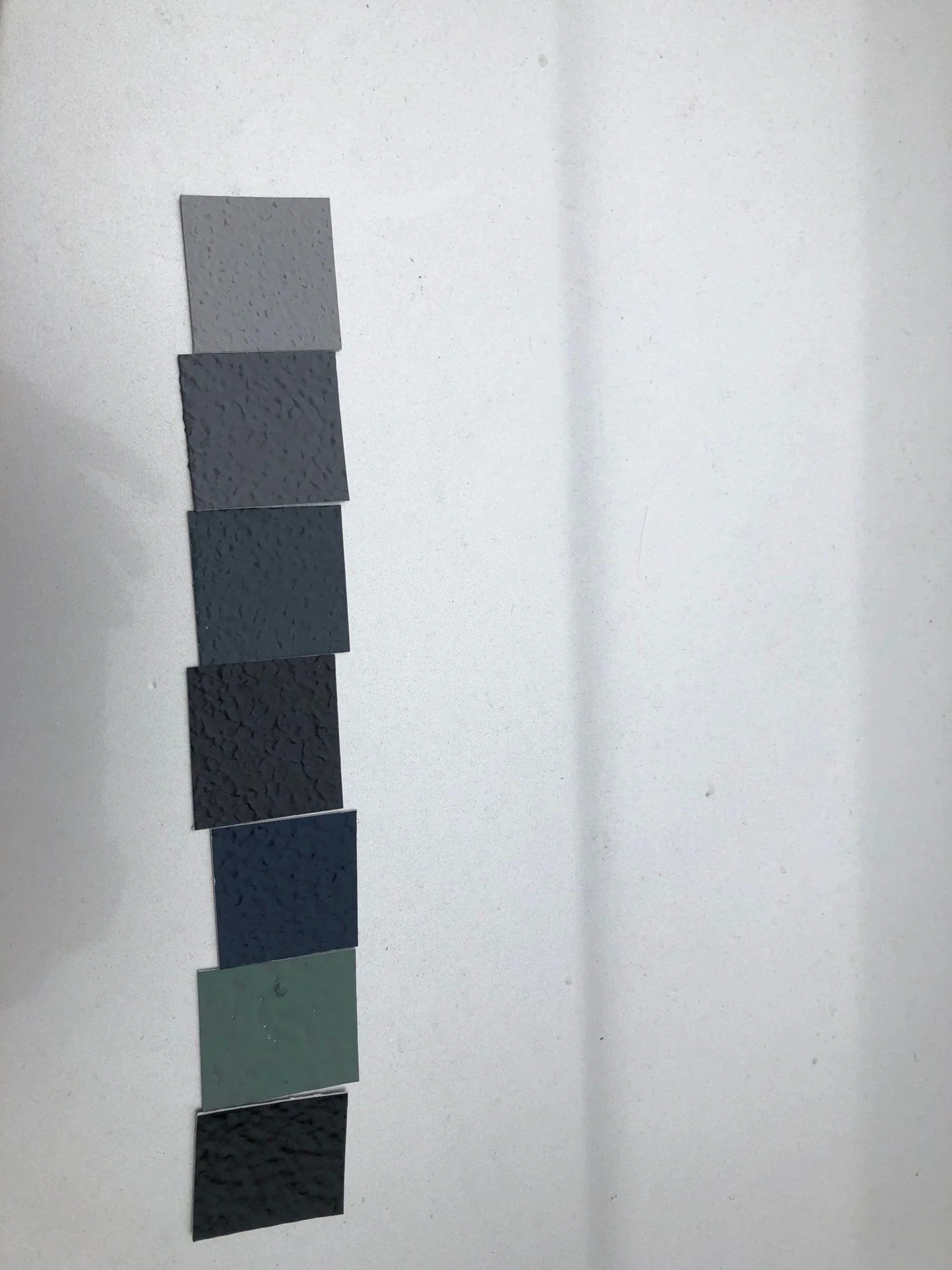

I got my monstaliner chips and determined light quartz grey to be perfect for my rockers/trim.

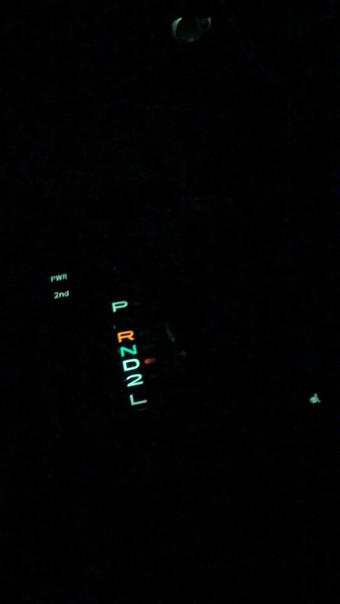

Lastly, the "P, R, N, D, 2, L" have never lit up with my dash since I got this truck. Its always just dark and I rely on the cluster indicator. Ironically my "D" in the cluster is out, but it is the only bulb out so I can tell I'm in drive if none of the lights are on. For some reason, today i got in the car to pick up my parents from the airport (returning from 12 days in Italy) and boom! The gear indicators by the shifter were on....curious to see if I have them illuminated again tomorrow night. One of my buddies has an 80 and the same thing happened to him recently. Interesting. This happen to anyone else?

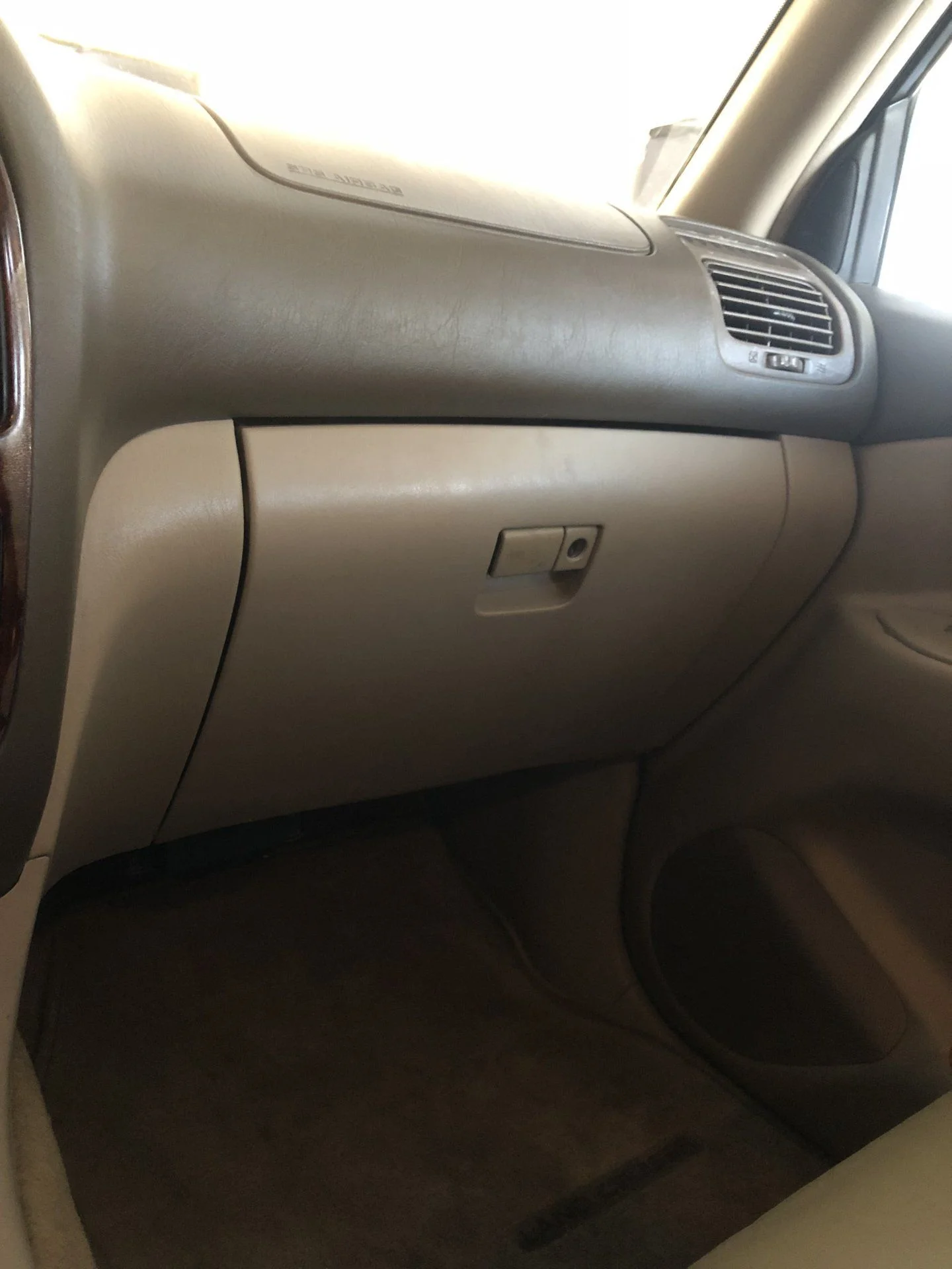

How did you fix the glove compartment... mine is sagging...
I was missing the lower right bolt that holds the trim piece to the metal frame behind the dash. My latch is actually sagging a bit because it is screwed into a plastic backing. I actually plan to just glue the s**t out of it make it lay flush to the glove box itself. Once you inspect and take it apart you will see what I am talking about. I also had to trim that plastic piece to allow the actual latch to sit more nicely. My latch/handle doesn't really match in color so may be out of a newer 100...but not sure on that.

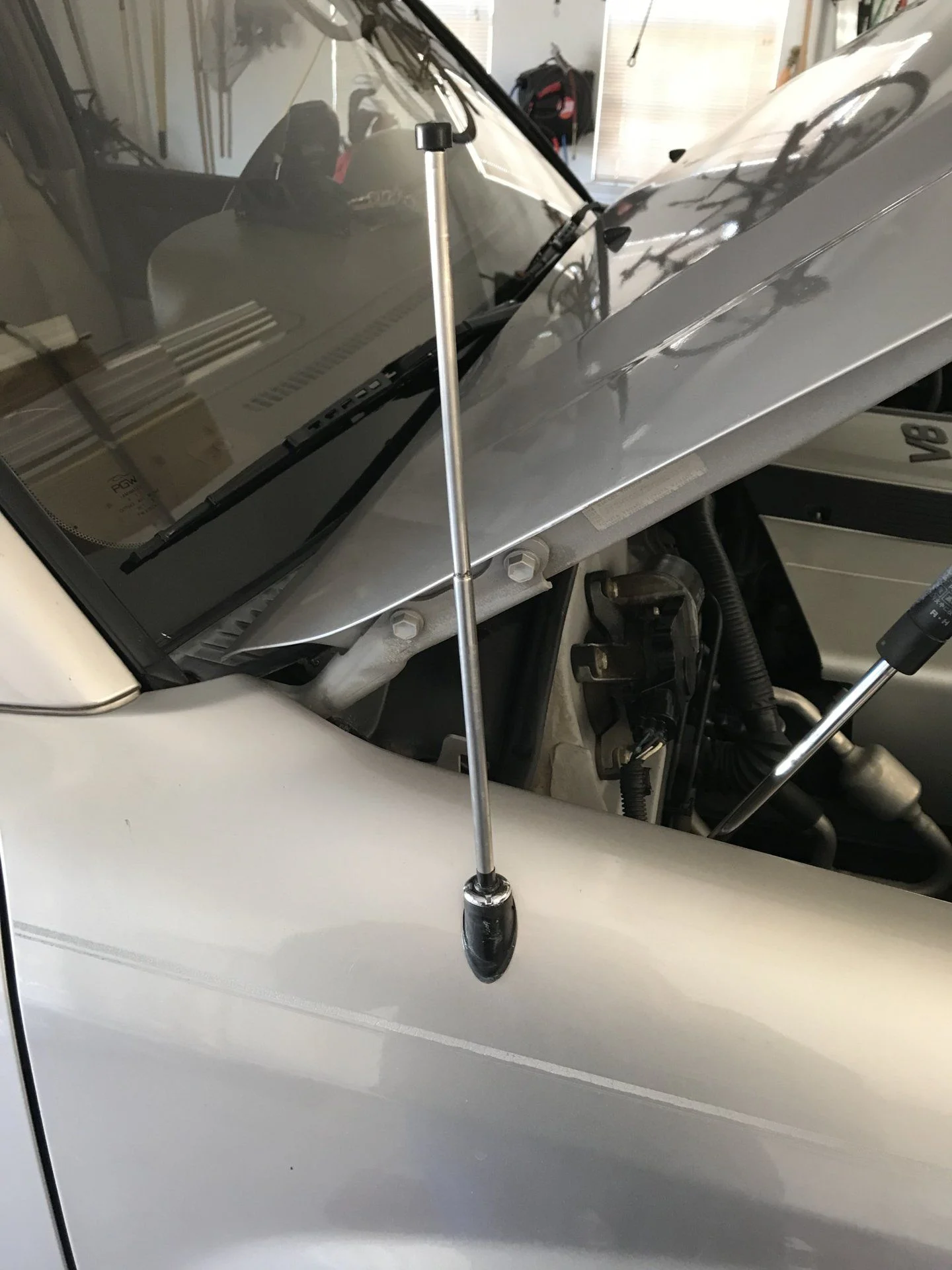

I broke down and got the cheapo hood struts from amazon, a little weary of trusting wooden boards. Hopefully I get at least a year out of them.

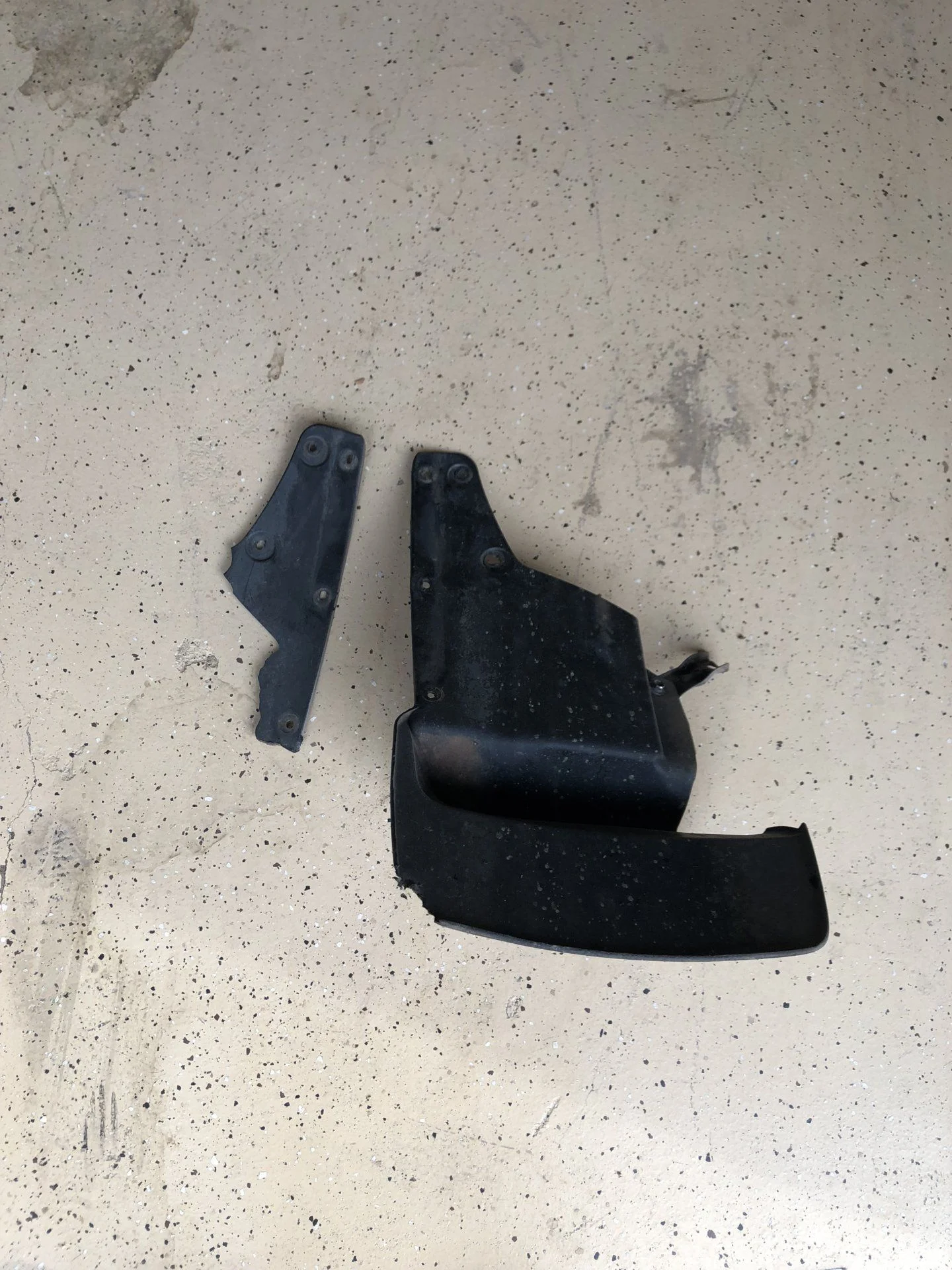

Also just ordered some mud flap eliminators from @LandCruiserPhil which I am very excited about since my mudflaps are destroyed!

Really want the mudflap elmiminators although looking at buying some cheap material and doing it myself...... on the other hand they dont cost much and I dont have to drive to get material lol. You look into the Trekbox tailgate cover yet? They look sweet and functional I think... looks like your build is coming along nicely. Post pic of steering wheel once done as I am sure you will, I did they wheelcover route that you stitch on and its nice but interested to see yours.
As for the mud flap eliminators, I like that I was able to support a mud member/General TLC community member who is willing to provide these niche products. Plus cheap price, fast shipping, and they're galvanized, and having a silver truck I plan to just leave them raw. Literally I ordered them yesterday AM, Phil had a shipping label made w/in minutes, and they'll be on my doorstep tomorrow. I will report back with my impressions once installed. based on reviews I will assume that I will be very happy with them and recommend them to you.

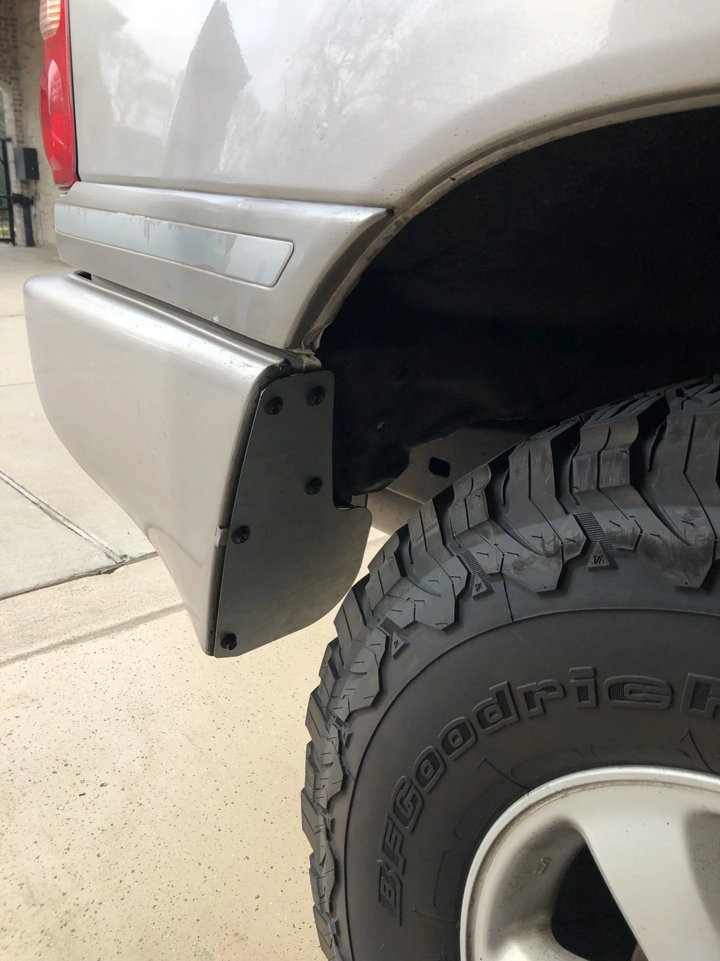

Got my mudflap eliminators from @LandCruiserPhil yesterday and they are PERFECT! Amazing product. Thanks for the idea Phil I will post in your classified thread as well with a quick review. nothing but positives literally no complaints.

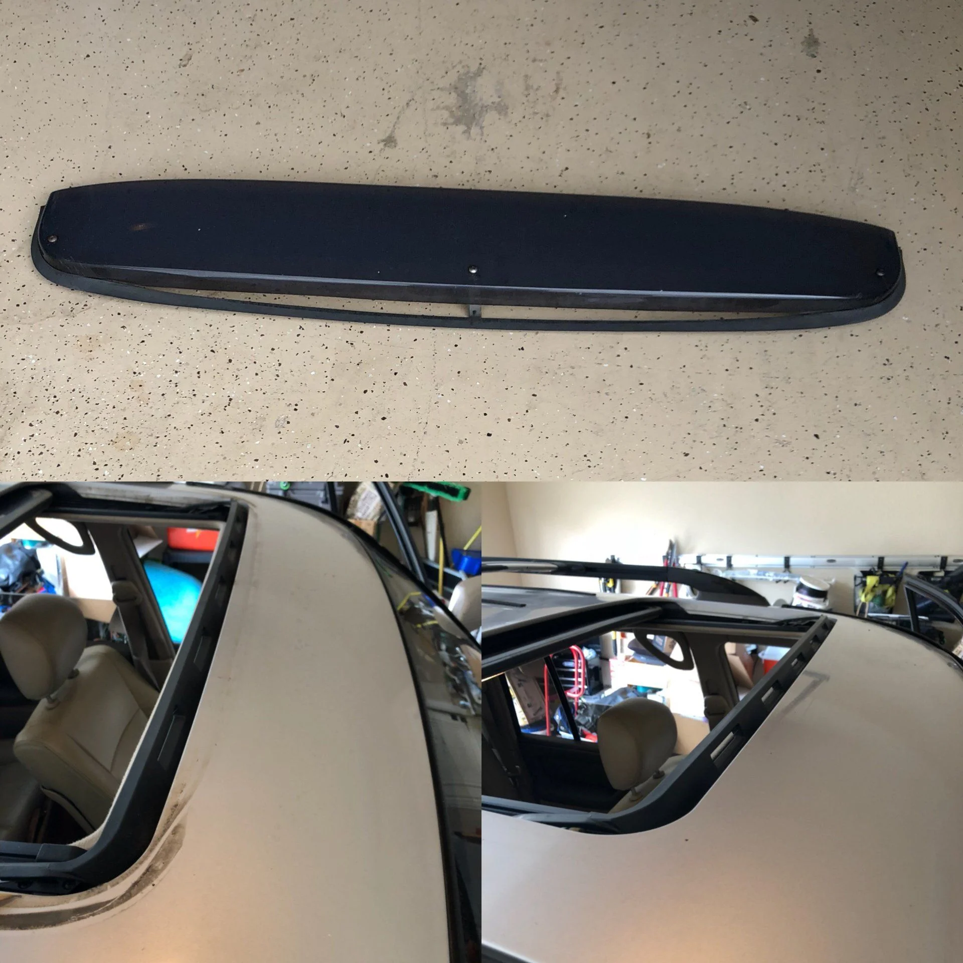

Removed my tinted sunroof visor and luckily had no paint damage underneath and all the dirt wiped right off.

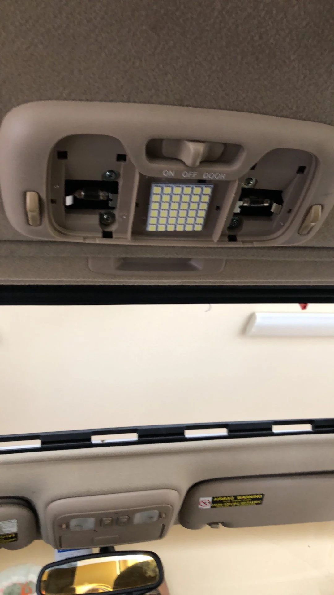

I added some of those big grid LED lights off amazon in my domes. They come with a universal dome light adapter and some adhesive backing tho stick them up in the dome housings (middle and cargo). The light isn't blue, its more of a stark white which I really enjoy. I wouldn't be happy with a really blue light. These things are BRIGHT I'm pretty happy, but I will wait a few nights to give a final verdict.

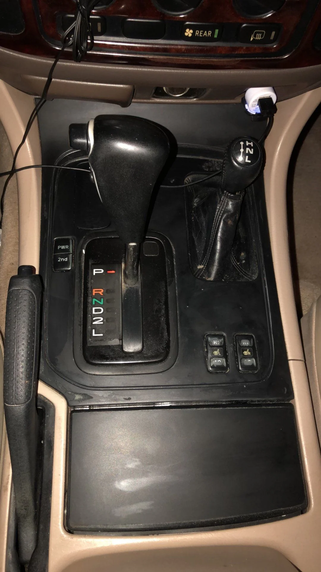

Lastly, I made the little jumper to replace the ACC relay, which allows 12v power even with the ignition off to the power plug in center stack, the one in the console, and the one in the cargo area. This will allow me to run lights or charge my phone with the vehicle not actually running. The cigarette lighter is NOT included in this loop, but mine is broken anyways so no big deal! Easy mod but something that make me super happy. I kept the relay in my glove box just in case my little jumper gets damaged or stops working.
