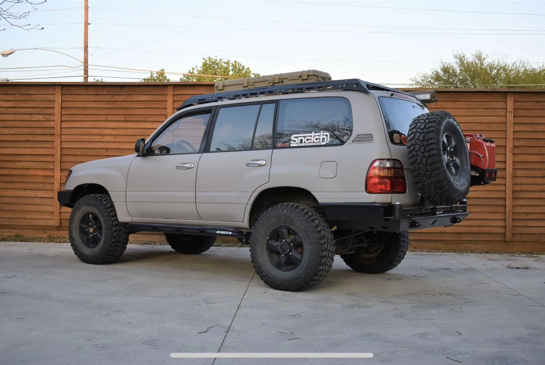

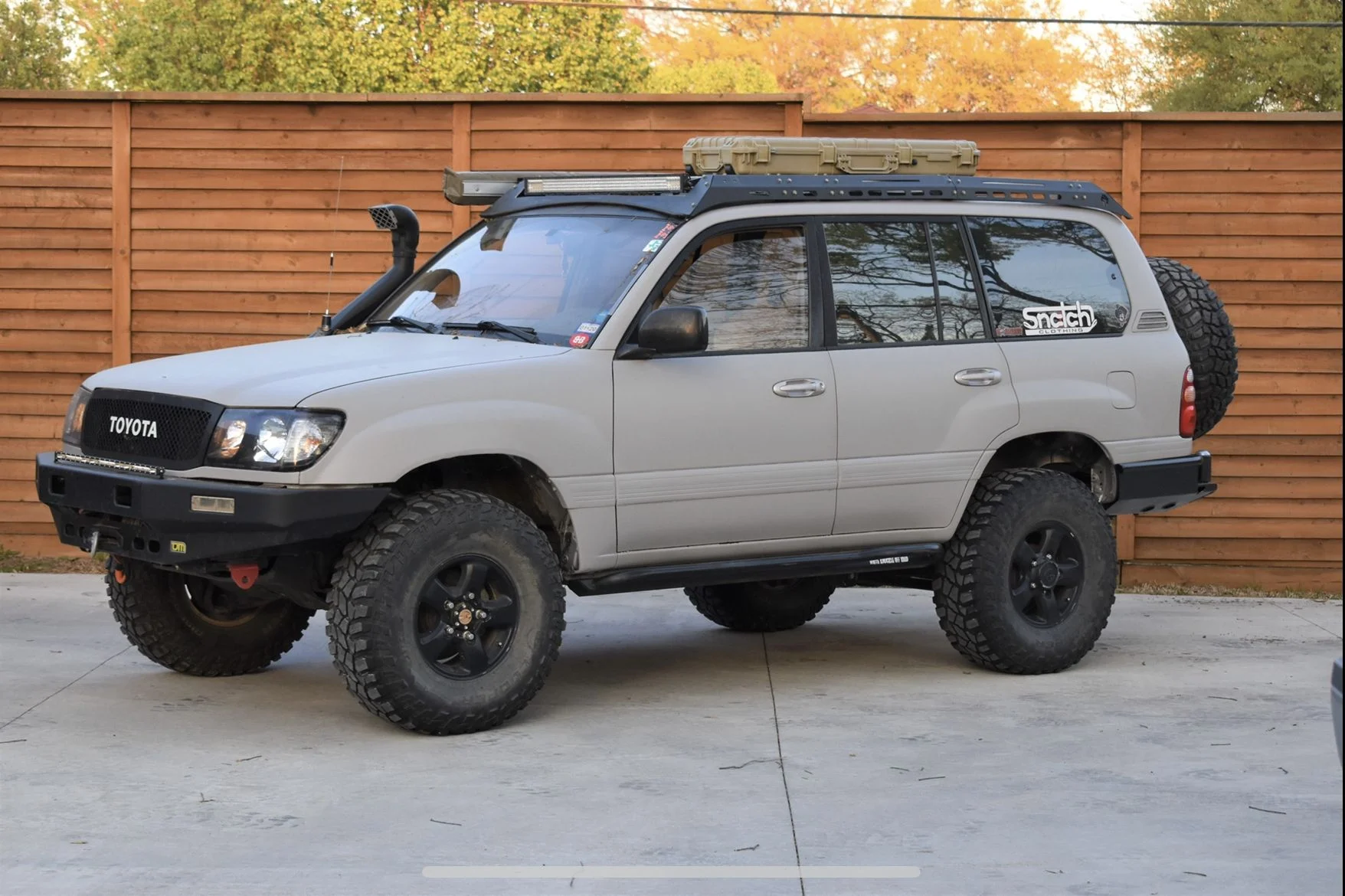

Front is TJM T17 TJM T17 Bumper is coming Back!
rear is Dobinson's
Nice, I had the Dobinson's on my GX470, just spoke to Jose at the main office and they have em in stock. I love your dual jerry can setup, way better than the one they offer. What's that holder? Was it a straightforward weld/bolt-on?

Since last updated, I bought a 4x4 labs rear bumper kit which I built and painted myself. That was a tough but rewarding process. My cruiser sat the last couple months which zapped my already weak battery, so I got a group 49 AGM to replace it and the truck runs like a champ. I noticed the wild Texas weather in February claimed a passenger side axle seal in my front diff, and I need to reboot that CV anyways. So that’s on the docket.

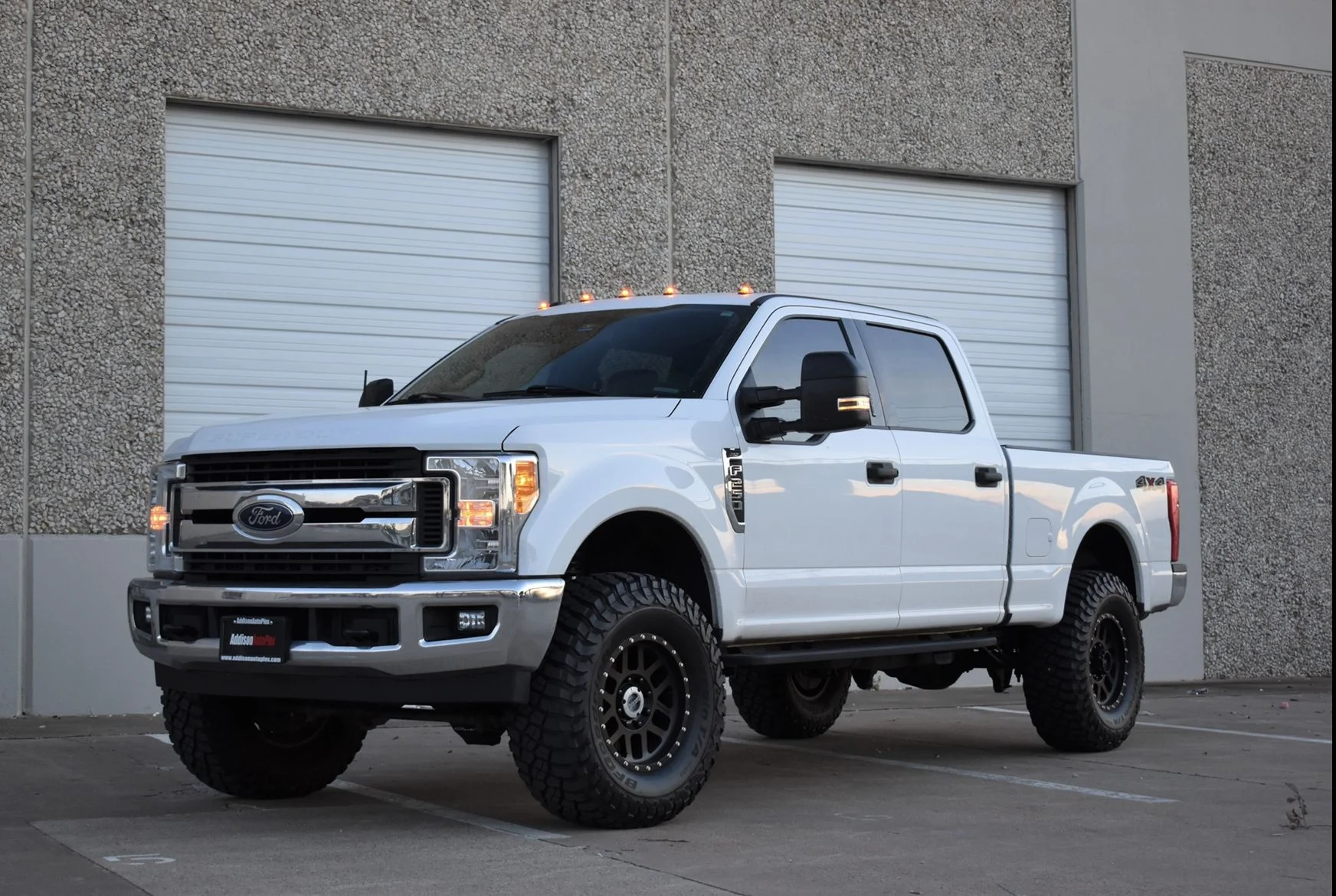

The cruiser admittedly has been sitting a lot the last few months. I traded in my Lexus LS460 on a 2017 Ford F-250 which got a full Carli suspension, method wheels, BFG KM3 37x13.50s. So the big truck has gotten most of the love the past few weeks. I’m vowing to start driving the cruiser more, as I want it to be ready to go and reliable for Colorado this summer.
Nice looking stable! I bet the F250 is nothing like the LS460 :D
Would you share your thoughts on how 4x4Labs compare to the Dobinson's rear bumper?
The Dobinson's swingouts were way more sturdy than these. These wobble a lot. I really do not like this latch mechanism how the arms "float" in the center. I am going to sort out some kind of footing for them to sit on. Otherwise the quality is great on both. I haven't beaten on the labs yet but my Dobinson's went thru hell and back and held up perfectly. It was incredibly stout. I definitely notice more "flex" in this labs bumper. Clearly the looks and clearance of the labs bumper is superior. We will see how it holds up.

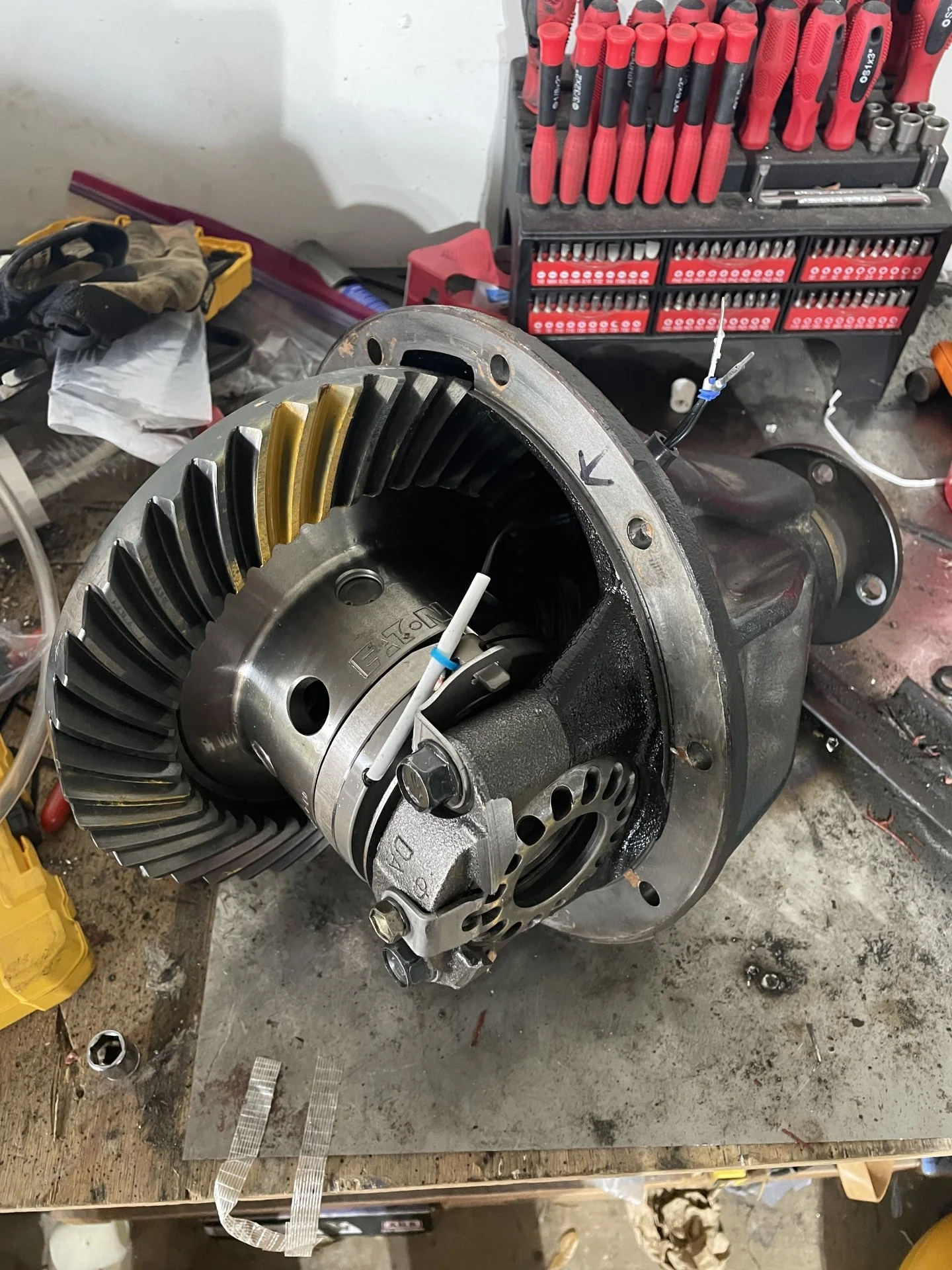

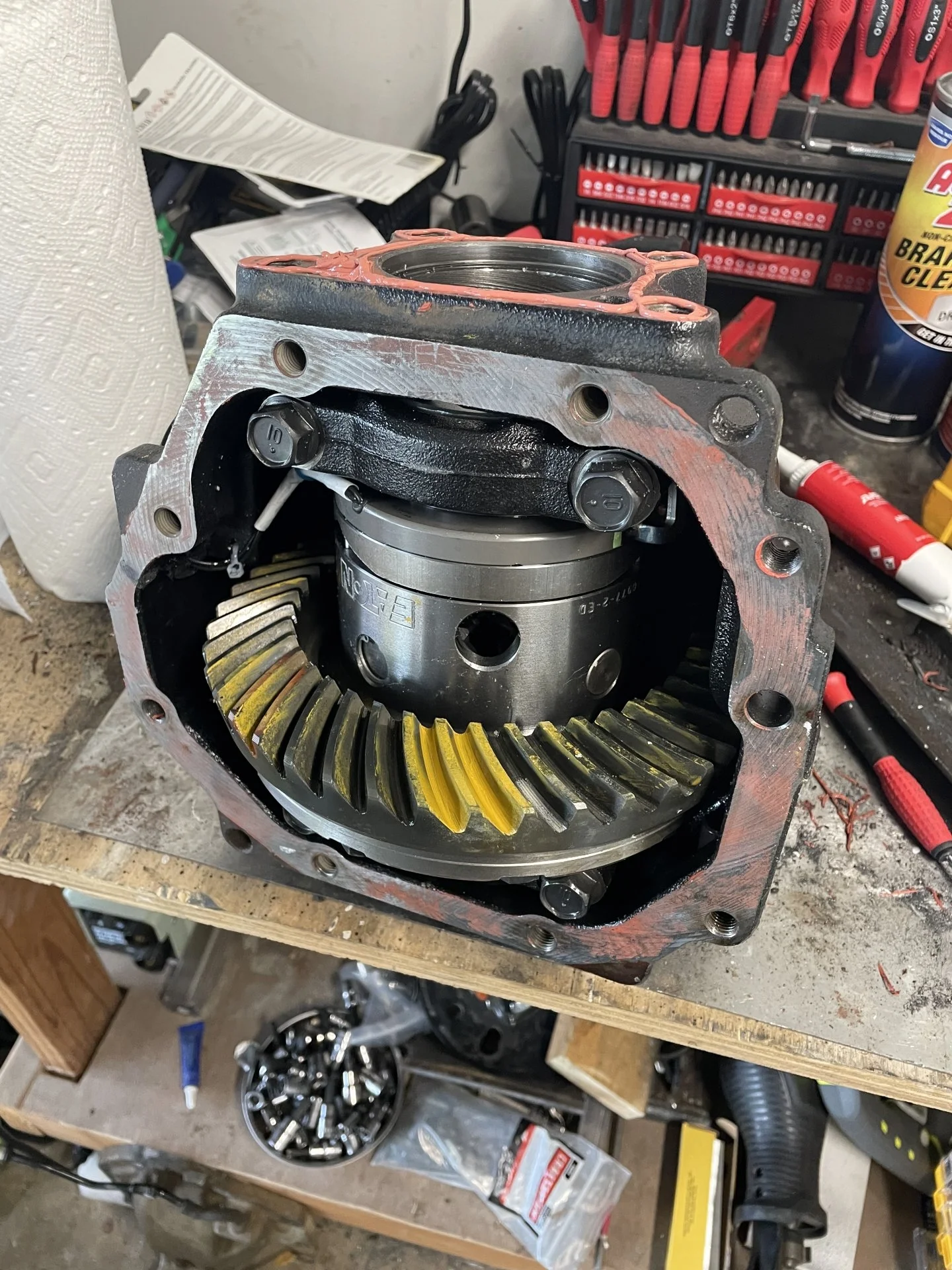

Remember how I said my front passenger axle seal was leaking and the CV needed a reboot anyways…well one thing led to another and I ended up sending both of my diffs out to Zuk (gearinstalls.com) to have lockers put in. Oops. Colorado should be extra fun.
“while you’re in there” is a dangerous phrase.
