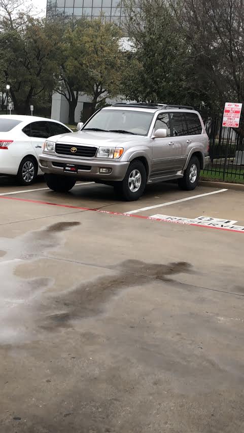

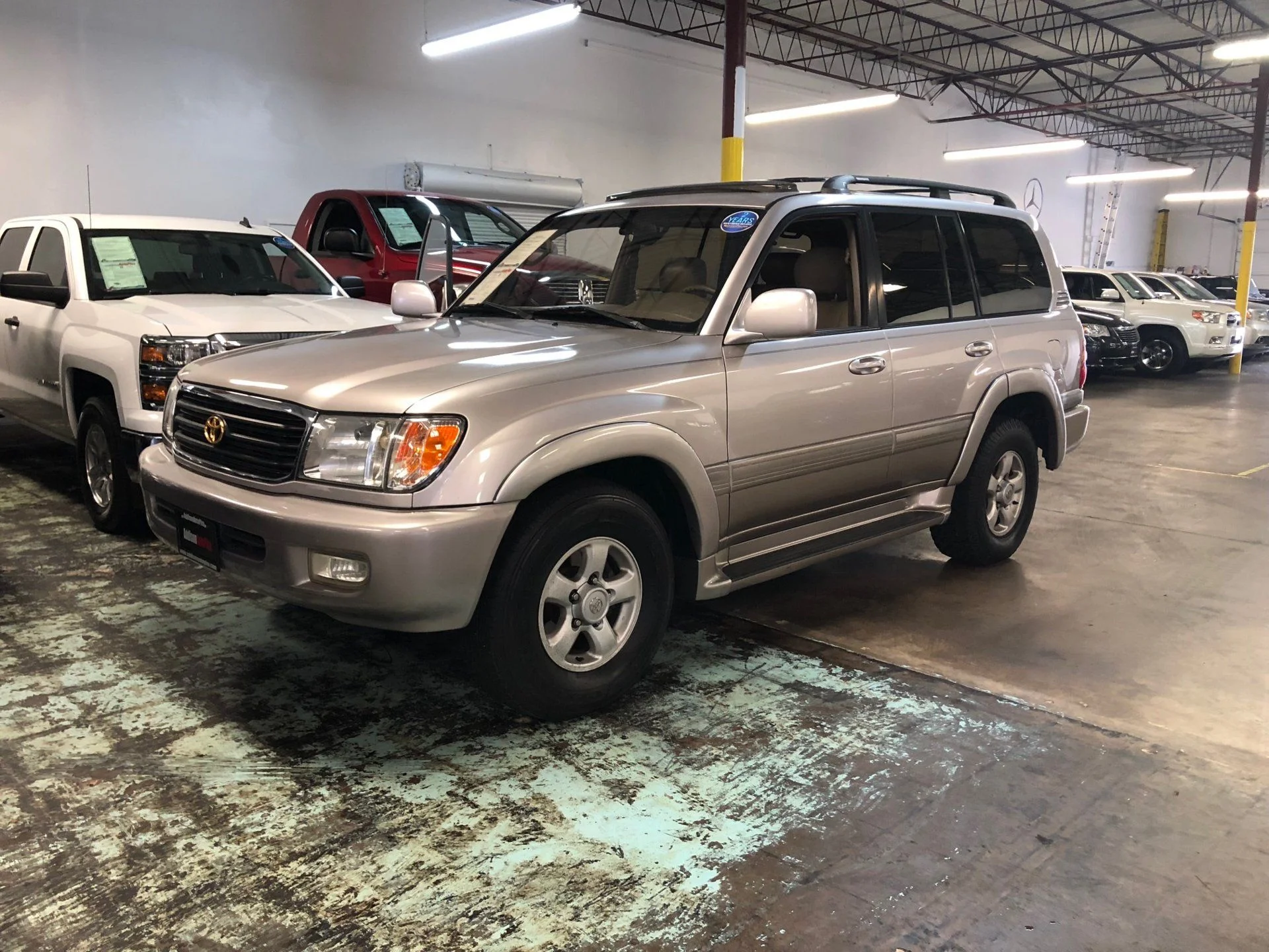

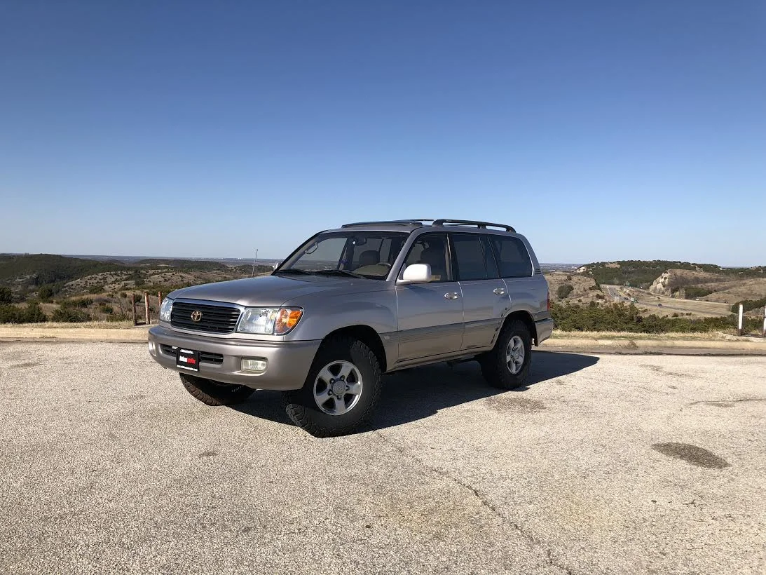

My name is Andrew, I'm from Dallas, TX but also lived in Oklahoma for about 4 years recently attending Oklahoma State University. One of my best and closest friends (who is a member here on Mud @DirtDawg ) has always been a Toyota 4x4 nut, and I've worked on his 2000 LX470 a couple of times with him. But he has also had multiple 4 runners. After all these years of playing with Ford half tons and Powerstrokes, today was the day I decided to buy a 100 series!
Here she is, a 2000 Toyota Land Cruiser in silver with 235k. Not a spec of rust, reupholstered interior, and a great color. It need love in a few spots, but that's why I'm excited to get involved here on Mud.

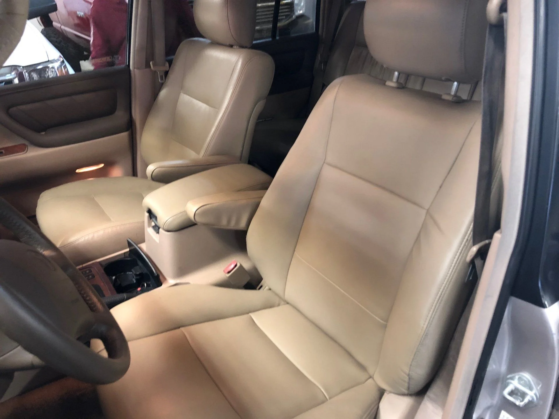

Great looking rig! I also purchased my first 2 weeks ago.... I need to fix my front leather any ideas on who to go to? I dont want to spend $1000.... would love to spend under $300.

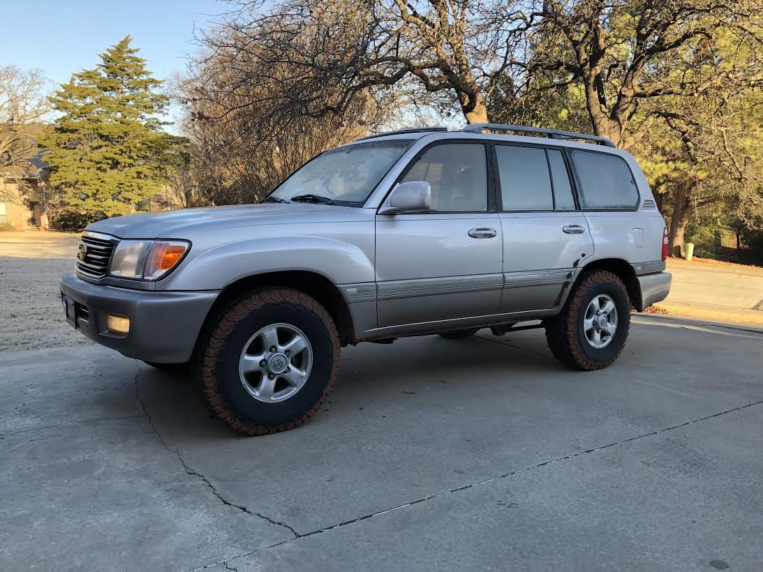

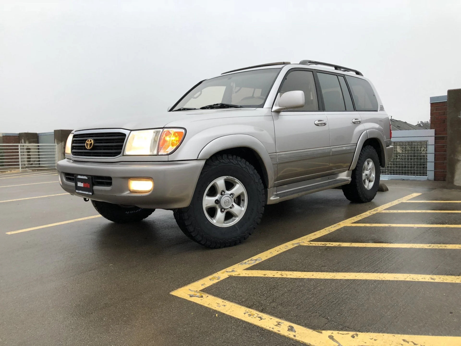

I couldn't help myself so last night I bought a set of 4 BFG KO2's in 285/75r16 at Discount Tire. The tech said there was NO WAY they would fit. But at the advice and experience of many people on these boards I had him press on, and surely enough they fit like a glove! I'm really happy with the size, as they look great now and will still be perfect with a 2" lift.
To be honest I don't really even have a guess. i would check locally and price it out. I know its a ways for you to get to Dallas, but on both sides of I35 just south of 635 there are a ton of used car dealers, so there are a lot of shops for things like upholstery, PDR, Parts, etc. Call around to some of them and get quotes.

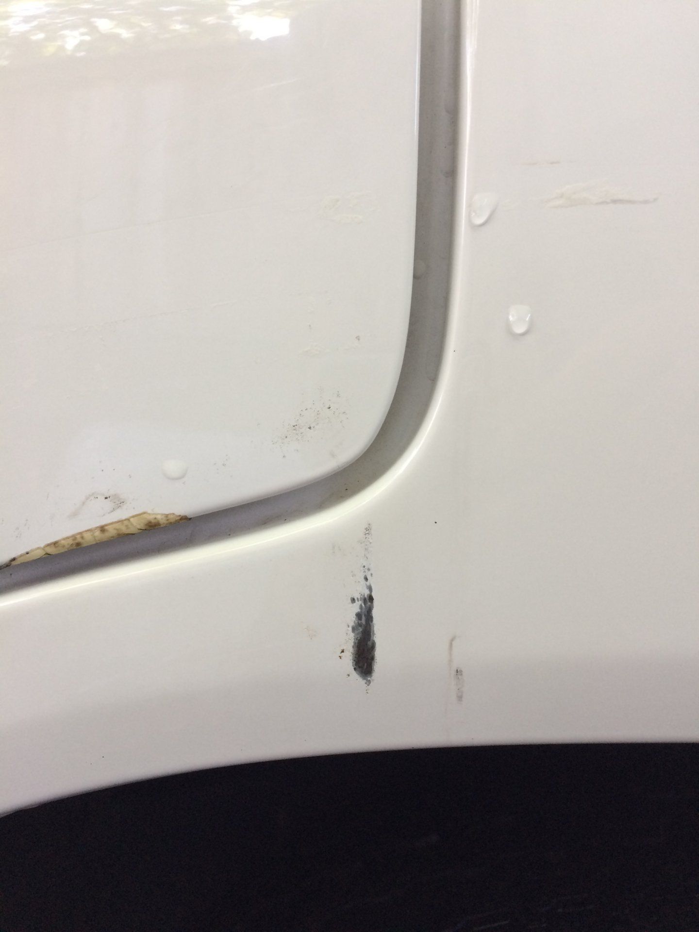

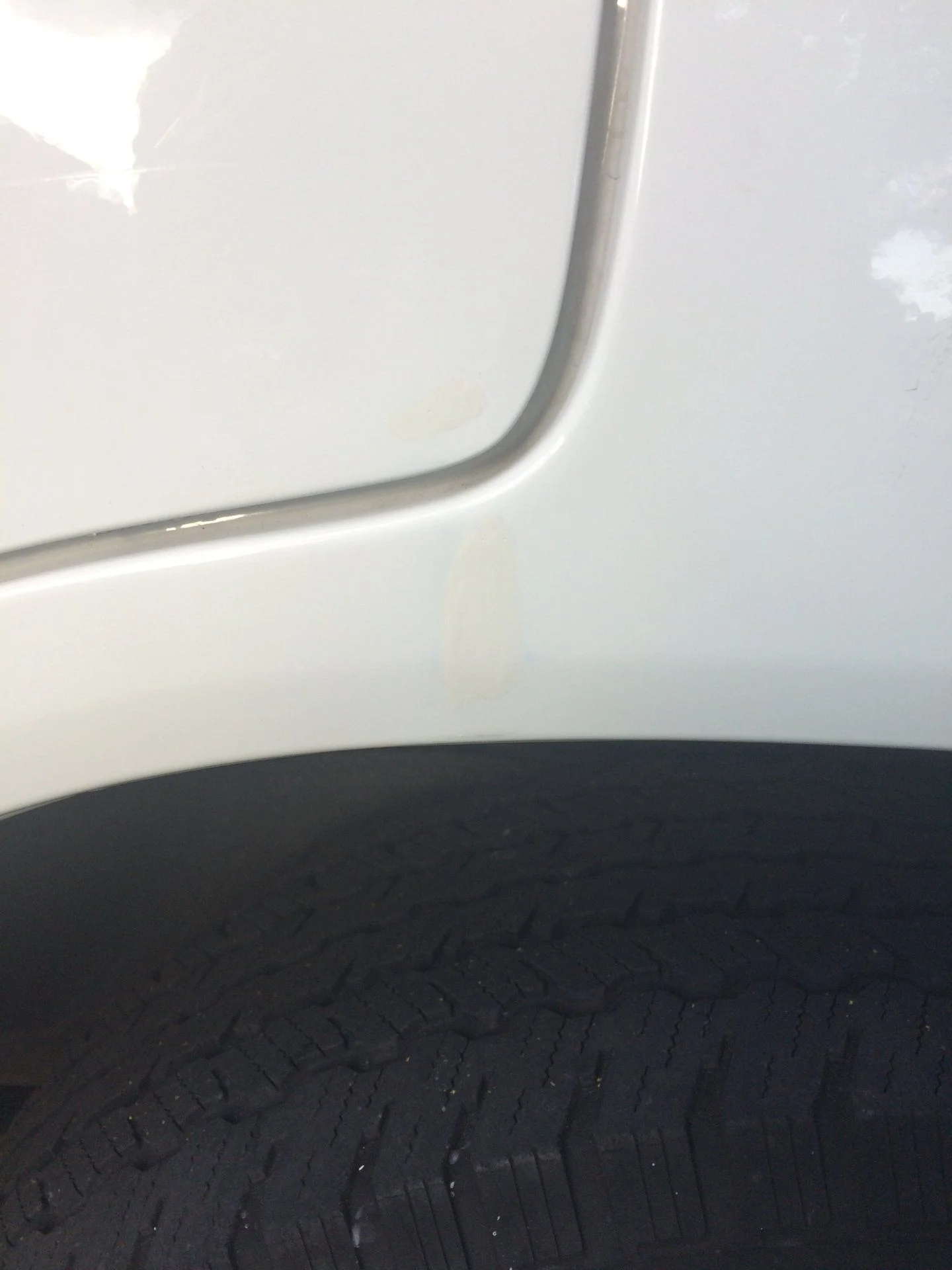

Welcome to Mud. When you remove those fender flares you may need to do a little touchup painting. Here is what mine looked like.
Before
And after I tried my hand a being a body and paint guy.
You can still see it if you look close but at first glance it is unnoticeable.
BeforeView attachment 1640022And after I tried my hand a being a body and paint guy.View attachment 1640023You can still see it if you look close but at first glance it is unnoticeable.
Thanks for the tip! I'm hoping mine are ok as the dealer I bought the vehicle from just put them on.

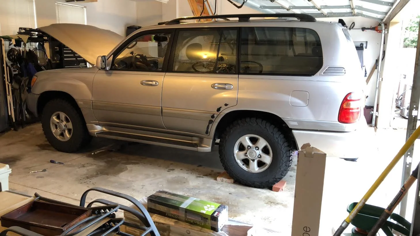

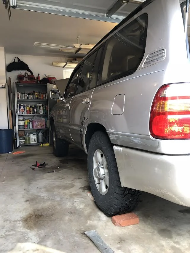

First things first, we took off the running boards and fender flares. The boards were a touch harder than expected but used some ingenuity and they popped right off. The flares came off easily enough, and the paint damage below was very minimal. The front flares were held on with 3 screws each, and the back half of the rears was the same. The front half of each rear flare that goes on the back door was a bit of a pain. The dealer I just purchased the cruiser from was the one who installed these flares. In their infinite wisdom, they installed this portion of the flares with thick, black, giant globs of silicone epoxy. we were never able to remove these fully, and on a couple of spots on the lower trim, the paint was actually ripped off along with the silicone. Very frustrating, but I reminded myself, this truck was a steal and its not the end of the world. I think the plane will be to just sand the rest of it down and monstaline my lower trim in a matching color. If not I will find someone who can paint them for me. This is the only really bad thing we found about the truck, nothing but great news coming up.
The other cosmetic item we addressed was my saggy, 235k mile front end. We took hub to fender measurements on all corners as our benchmark and these were our results:
DF: 19.5"
PF: 19.75"
DR: 20.5"
PR: 20.75"
Because the Passenger side was a tad higher we turned the passenger torsion bar adjustment bolt twice, and the drivers side we turned 3 times. After driving around the block, we re measured and it turned out perfect. The Measurements are as follows:
DF: 20.25"
PF: 20.25"
DR: 21"
PR: 21"
Overall, the flare/running board removal coupled with our minor torsion bar adjustments really helped show off the 285s and give the truck a great stance. I included a little "before" pic for reference.

Pics... sorry my first post they didn't work right.
