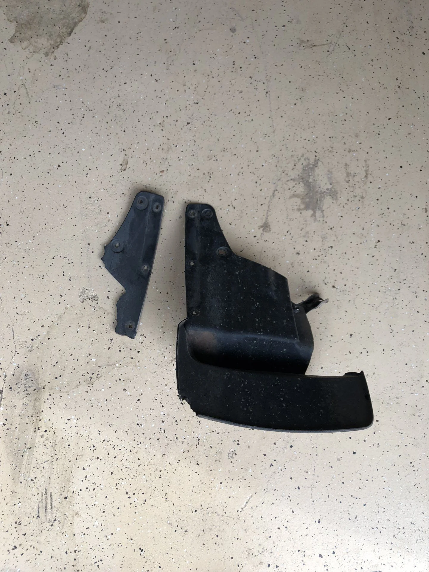

Got my mudflap eliminators from @LandCruiserPhil yesterday and they are PERFECT! Amazing product. Thanks for the idea Phil I will post in your classified thread as well with a quick review. nothing but positives literally no complaints.

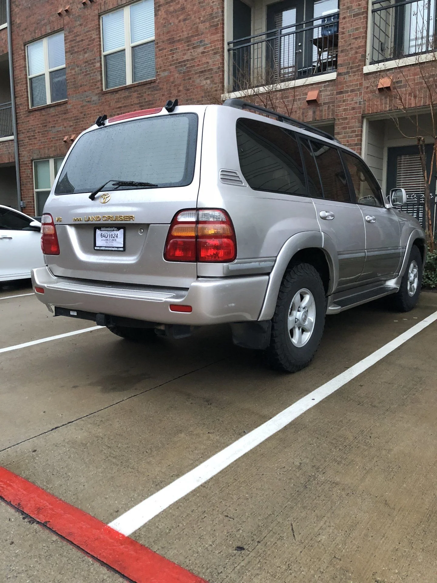

Removed my tinted sunroof visor and luckily had no paint damage underneath and all the dirt wiped right off.

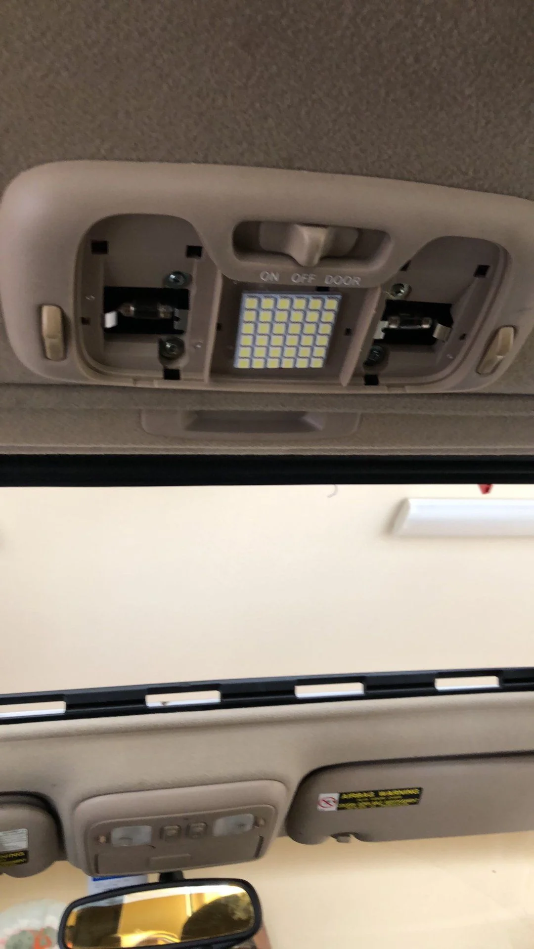

I added some of those big grid LED lights off amazon in my domes. They come with a universal dome light adapter and some adhesive backing tho stick them up in the dome housings (middle and cargo). The light isn't blue, its more of a stark white which I really enjoy. I wouldn't be happy with a really blue light. These things are BRIGHT I'm pretty happy, but I will wait a few nights to give a final verdict.

Do you have a link to the lights?
https://www.amazon.com/gp/product/B00IXKTW6C/?tag=ihco-20
Oops for got to add the link @lazarus18 . I'm glad its a 4 pack because I only needed 2 and 1 was smashed in the mail. Came will all necessary adapters and adhesive, etc. Very straightforward. Very worth it so far. I closed the garage and made it super dark and when the back doors/hatch are open these things are crazy bright... there's literally 36 diodes on each panel, and usually these interior LEDs have 3 small ones....so the light output is phenomenal.

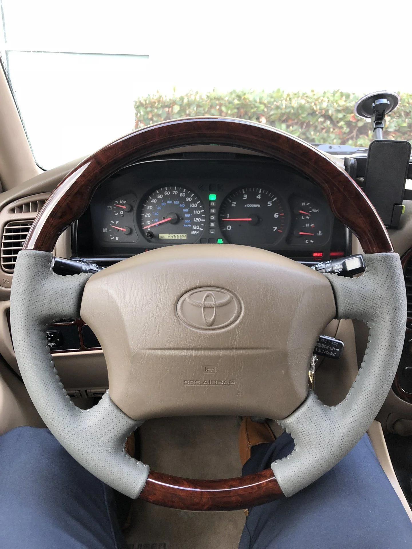

Oh wow I totally forgot to show off my fancy steering wheel. I am very impressed with the quality. The color is obviously a little off, but I think a quick dye will make it perfect. Even still its not awful The feel and quality is 10/10 and 3 day shipping from taiwan is obscene! I love how the fake wood feels in my palm. And the little paddles at 10 & 2 are absolutely amazing.

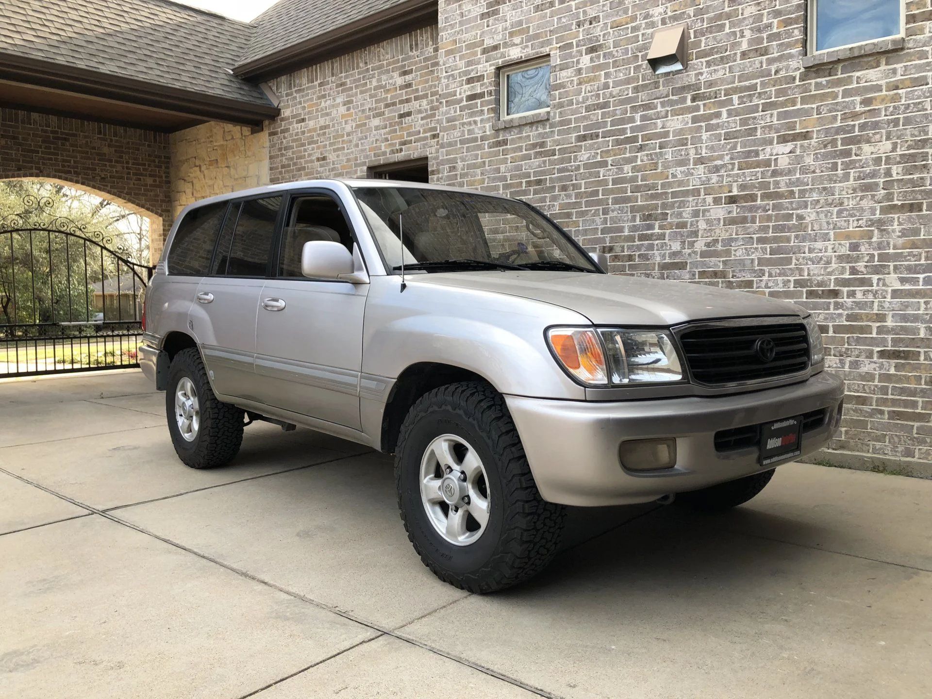

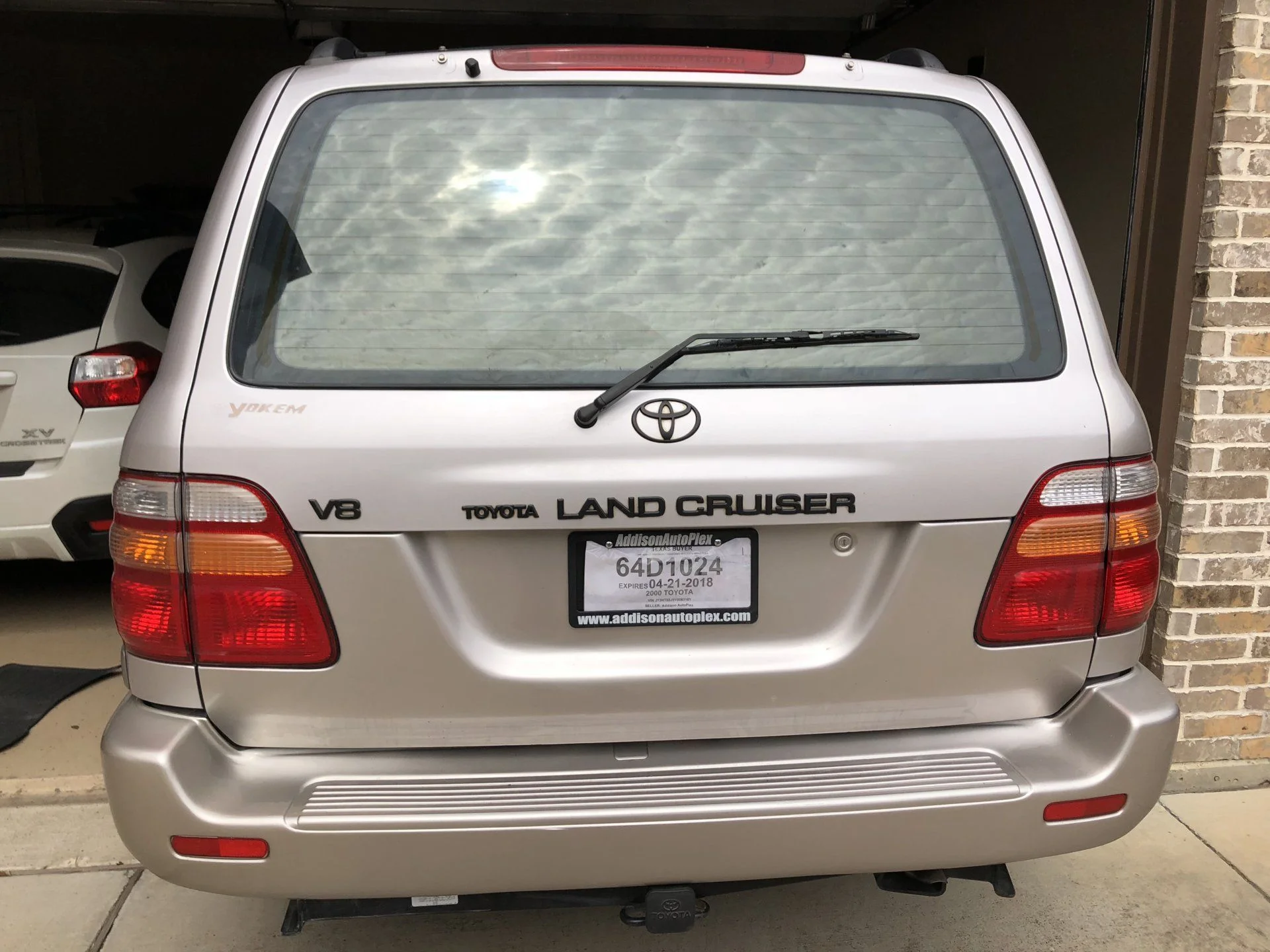

I have planned on black emblems since I got this truck. I HATE the gold emblems... I went ahead and did the cheapo plasti dip method for now. When I paint my wheels in the coming weeks I will also remove my emblems and properly sand, prime, paint, and clear them. There’s some peeling on the emblems themselves that you can see if you look really close, and I will correct that before they are paitned. I really did the plasti dip to get a taste of whether I’ll like the look or not and so far I really do! Looks much more modern and clean.
Inspired by @DirtDawg I pulled my roof rack and I’m actually super happy with it! You can see my matte black Toyota emblem here too, which turned out great.
Love that classic look @atnolan94 ! Want to take mine off as well but I potentially will be using it for some upcoming trips. Also see that yours doesn’t have the black guard above the rear cab light..... did you take it off? Thinking of pulling mine off but haven’t researched what they really do yet.
Like that weird spoiler thing? Mine had been broken off and the brackets were still on it. I just unbolted the brackets and threaded the bolts back in. You can see in the rear pics of the truck on either side of the third brake light. I attached an old pic to show what I’m referring to. Is this what you’re referring to?
Yea that’s exactly what I am speaking of. I like the classic look a lot that has no roof rack and no spoiler.
Ok great. Yeah from what Connor has told me, the roof rack is pretty unique to the US market. Obviously other markets around the world had them, but I guess all of the US spec ones did. The spoiler thing is just ugly! Haha. I’m sure a quick search will help you with that.
Like I said I still wasn’t 100% about taking the roof rack off, but I promise you the pics don’t do it justice. It looks so good. I also noticed a reduction in wind noise too, which Connor didn’t report. However he has an LX and the front foot of the roof rack was well behind the driver window, whereas our LC’s the front foot is basically right above your head next to the sunroof.
My advice on the roof rack is just get help from someone else to physically lift the rack off the roof in one piece. And make sure they’re talll enough to reach. It’s annoying to take apart on the roof doing it by yourself. Also you’ll need 12 m8x1.25 bolts and some silicone sealant because those holes go straight to your headliner. Lastly you need 12 little black plastic blanks to fill the holes in the roof trim, at $8 a piece. So you’re looking at about a $55 project in total which isn’t bad! Whenever you get time to do the rack removal feel free to PM me with questions.

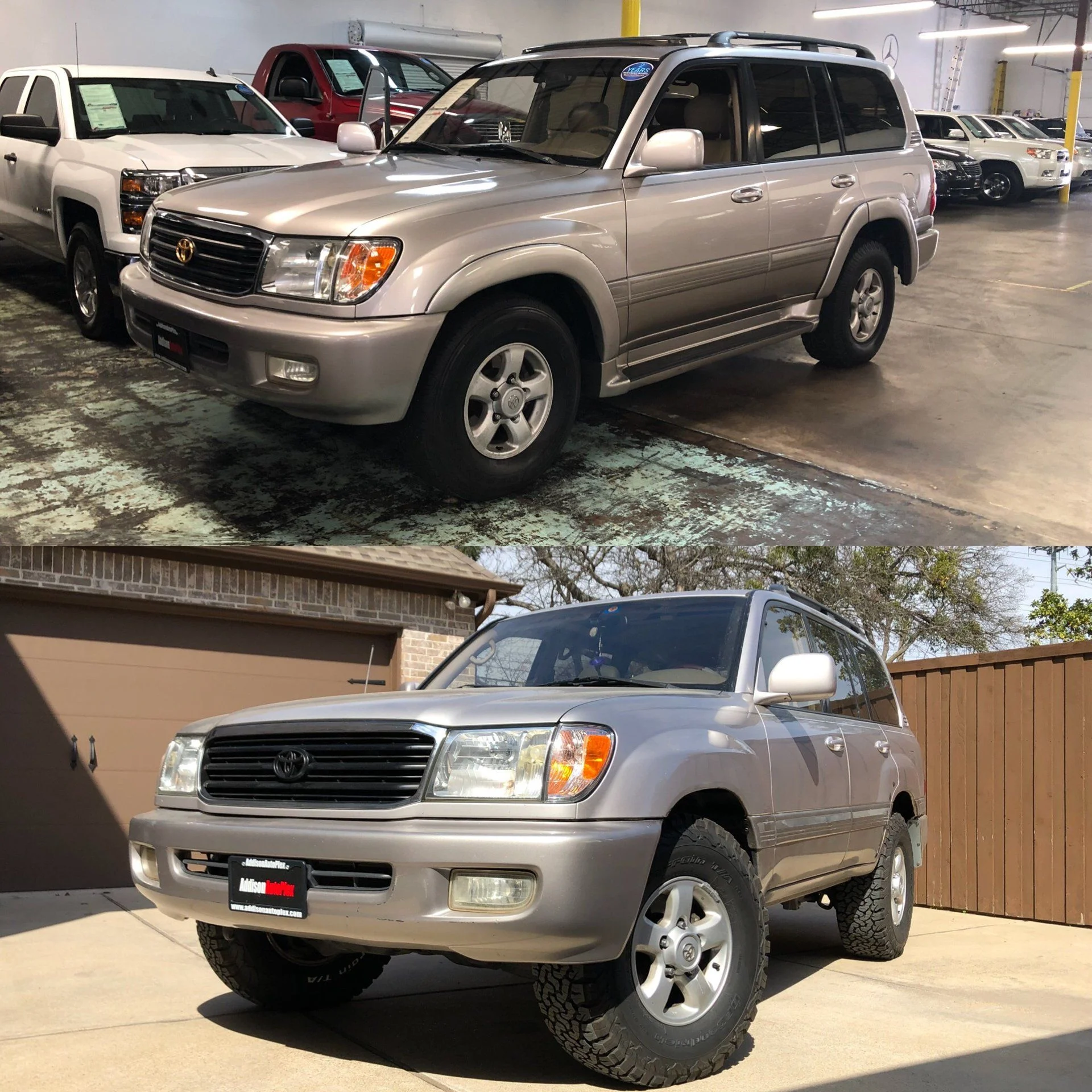

This was before I took my rack off, but I’ve now had the truck 3 weeks as of tomorrow. We have come a long way!!

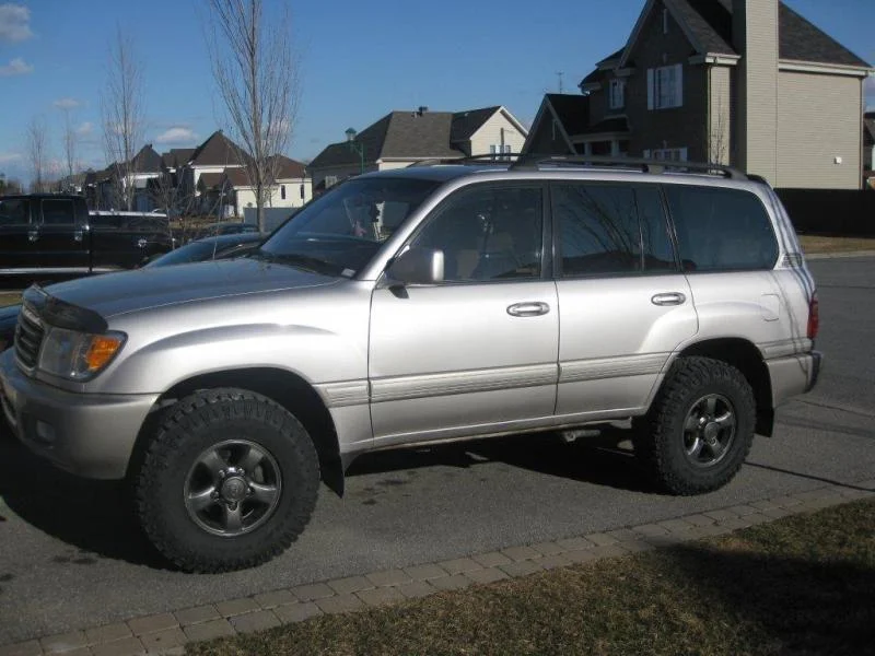

@OSTATECRUISER found the pic....
This guys is much cleaner than mine. but once I monstaline my rockers and trim we will be in great shape!
Also if anyone knows who this is, credit to him. I found this saved on my desktop but can't find the thread it was posted in.
