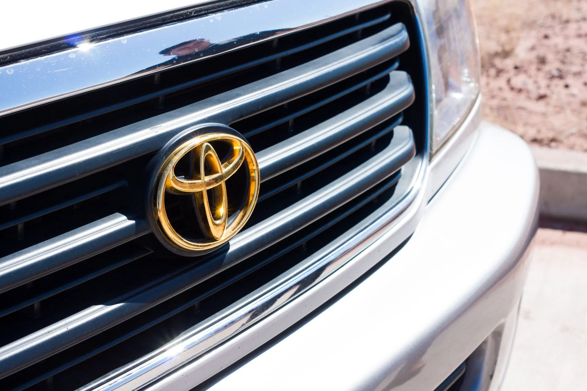

BTW @DirtDawg I did a great job of photo bombing that pic via grille reflection.

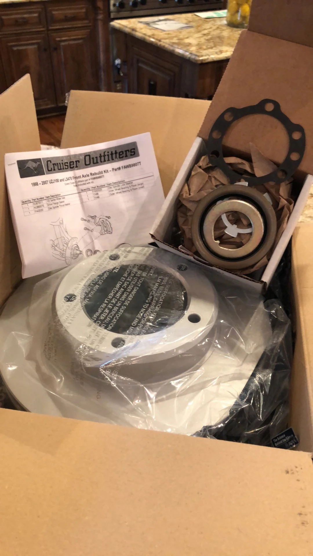

I also have a wheel bearing rebuild kit coming in from Kurt at Cruiser Outfitters. We tightened mine on the big baseline day a couple weeks ago, but you could feel most of the bearings were absolutely cooked...except my outer driver one was actually in decent shape. Nonetheless, all 4 bearings are getting replaced and all the necessary washers and such that come with Kurt's kit. i am also planning to swap out my warped rotors while I have it all apart! This reminds me I need to order a hub socket, a brass drift, and a spring gauge to set the inner nut on the hub....amazon has all of these.
Got all my parts in. Went with Bosch rotors and pads cause they were just stupid cheap on amazon and mostly no complaints from mud members who have used them.

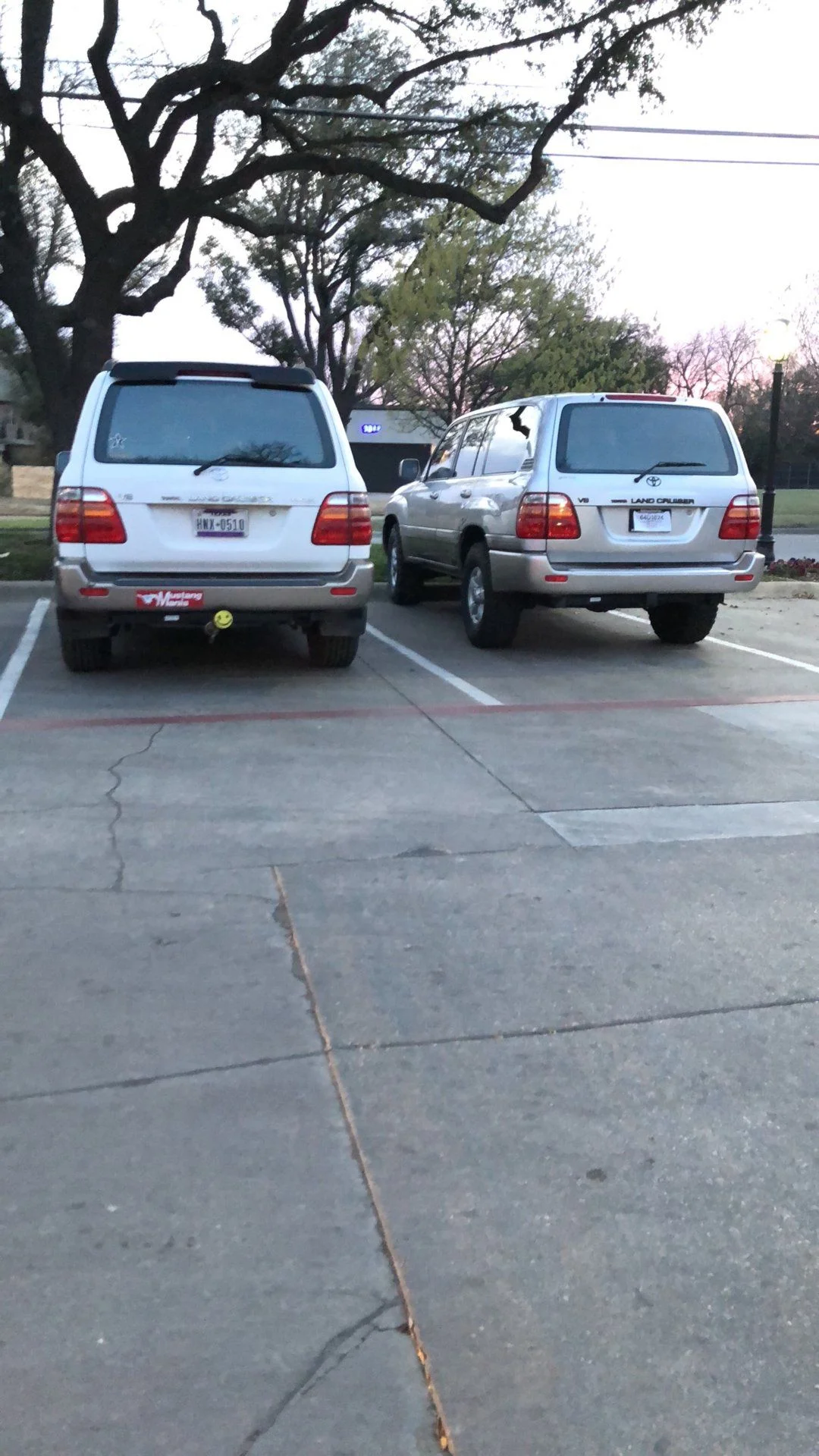

Also parked next to a 98-02 brother at dinner last night. Turned out to be a group of older ladies but loved to see them rocking the 20 year old cruiser. Also saw 2 LX470s and 2 LX570s in the same lot. Like a mini HIH....with no mountains.

Rotors were like $58 each or something free shipping with prime. $37ish for pads also from prime. And the bearing kits are $85 EACH I think...from cruiser outfitters. Then obviously a little more here and there for tools. But we may be able to meet us so you can borrow or something.
EDIT: That's all 4 pads BTW, the rotors come in singles.

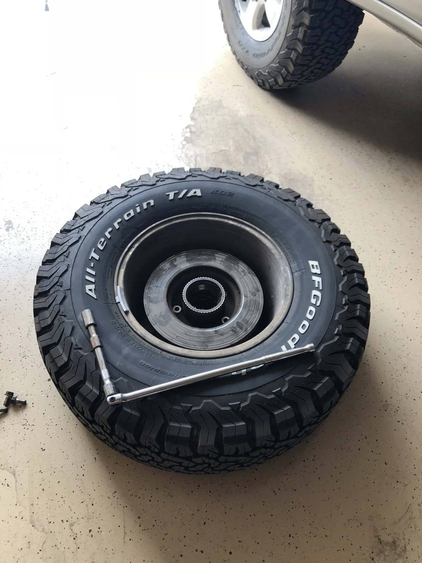

Wow, that bearing job went super fast. I am glad @DirtDawg walked me through this a couple of weeks ago or else I would've been lost. Once you understand how this hub works this job is really not hard at all. Whoever designed this is a genius, very serviceable without sacrificing reliability and durability. I'm used to ford trucks with non-serviceable bearings which can really leave you in a pinch if they fail.
I'm not going to do a write up because there are great videos, write ups, and the very useful FSM. MAKE SURE YOU HAVE THE FSM HANDY! It really helps to double check each torque value. And while many people here say the fishing scale process for setting the torque on the inner nut is unnecessary, the FSM says to do it...so I did it, and added a tad extra torque since I'm running load range E 33's. FWIW many people set these to 35 ft/lb regardless, and this would have been WAY too tight on mine.

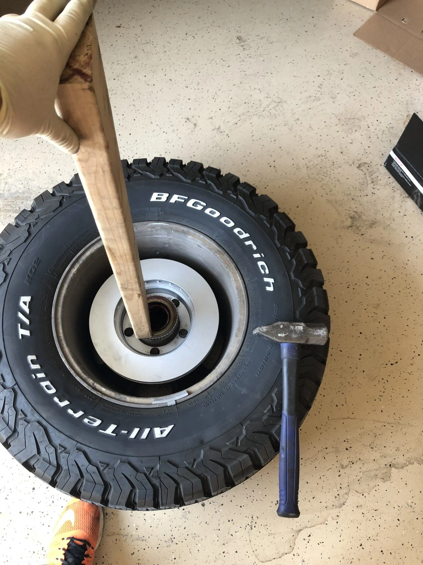

Anyways, here's a few tips if you are doing your rotors, put your removed wheel face down and place the lug studs in the wheel, this is a makeshift vice to help you remove the bolts in the back of the hub assembly to install the new rotor. The rotor actually gets pressed in place as you tighten the bolts, so you'll need a pry bar to separate the hub. Luckily there's gaps in the mating surface and my Kobalt pry bar worked like a charm. It also help the opposite process of reinstalling the rotor.
Once I cleaned the cavity and swapped the races, the inside bearing goes in, then you have to press that rear seal in. Again I used the face down wheel trick and then put a 24" piece of 2x4 on the back of the seal and tapped it in with a hammer. Honestly a 4x4 would be absolutely perfect for this job, it would span the seal perfectly and it would set easily.
I also found that a brass hammer was way easier for me than a drift when getting the cone washers out of the flange.
This is a messy job. Don't buy the 10-pair pack of disposable gloves. Buy the 100 pack. I used probably 25 pairs to try and avoid contaminating the new bearing grease. And they would get so caked I literally had to change them out.
While I was down there, I inspected my steering rack bushings, and honestly they don't look bad. i may put that project on the back burner until a more convenient time.
Overall, my steering slop was cut by probably 75%. My ITRs still need to get done, but overall drive-ability has greatly increased. I also did my rotors and pads since my fronts were clearly warped...my suspicions were confirmed on that....below is a pic of my passenger rotor. You think that's a bad rotor???? Lol. When i took my pads out they were cracked and destroyed. They weren't down to the metal, but the wear indicators were nothing but a memory. Some pics in no particular order.

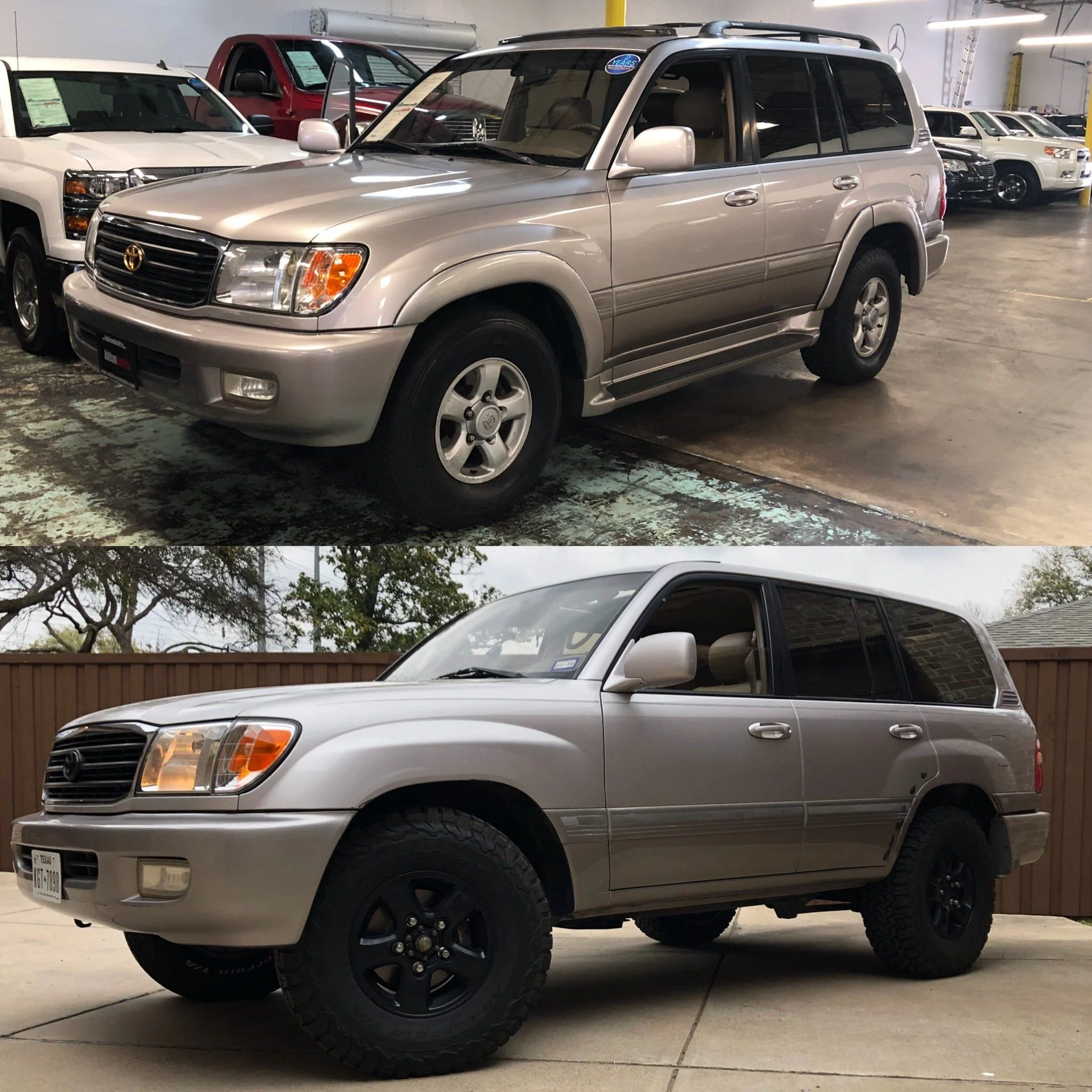

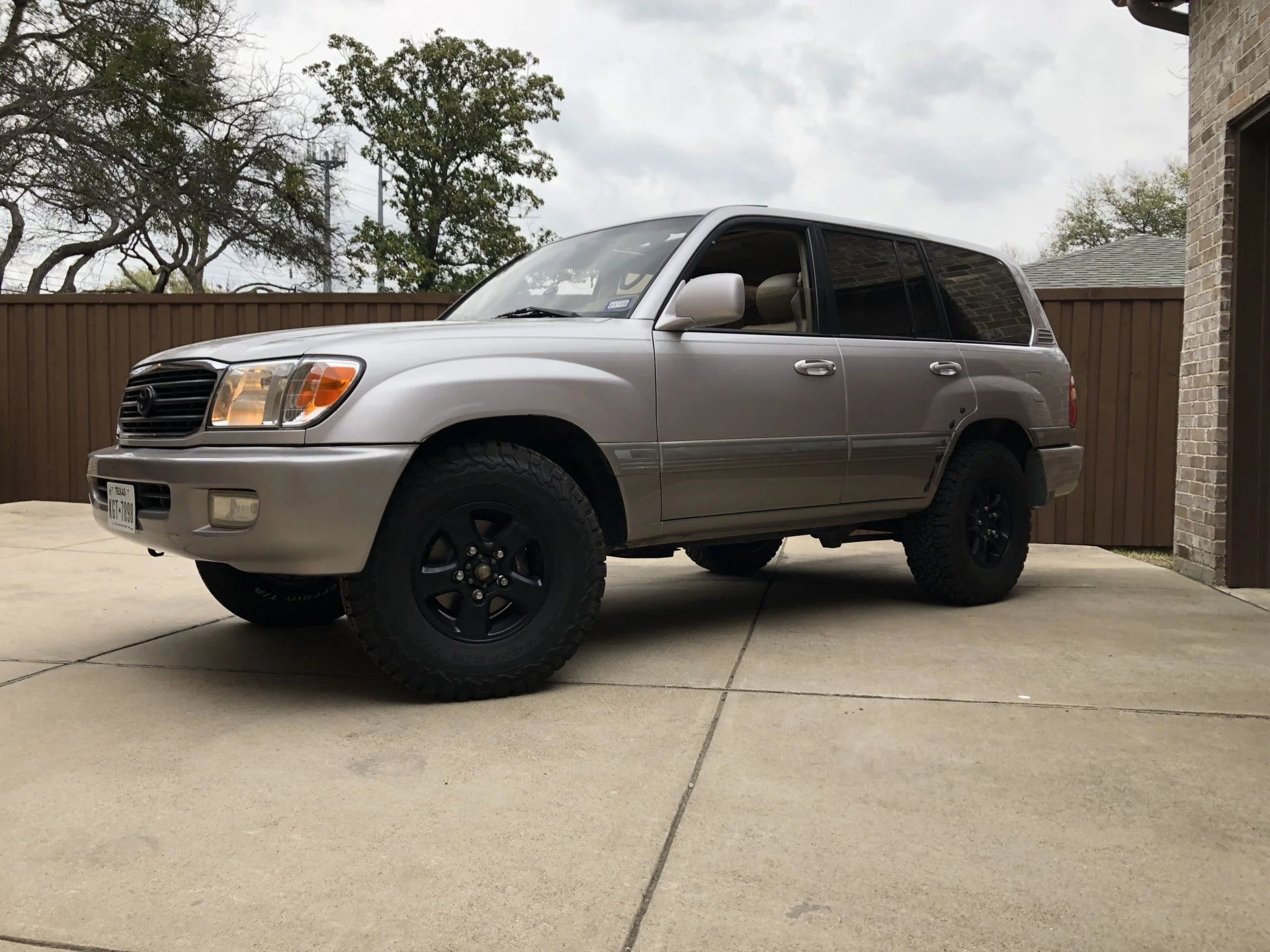

Since I finished my bearing/rotor job in 3 hours, and I budgeted the whole day to do it, I decided to tackle a project that I’ve been waiting on for a while. I finally got to paint my wheels black!
Basically I used 800 grit sand paper just to scuff the top layer, cleaned as best as I could, then did 3 light coats of sandable primer. Just a rostoleum product from autozone. It went on really nice so I didn’t actually end up sanding it. Then I did 3 coats of VHT black, the first row being light with the color just trying to cover the surface, then the third coat went on heavy. Then I hit it with a ton of matte clear coat, like half a can on each wheel. The paint has a semi gloss to it so it’s got a nice satin finish. Overall very happy with the look, curious to see how durable it is!
