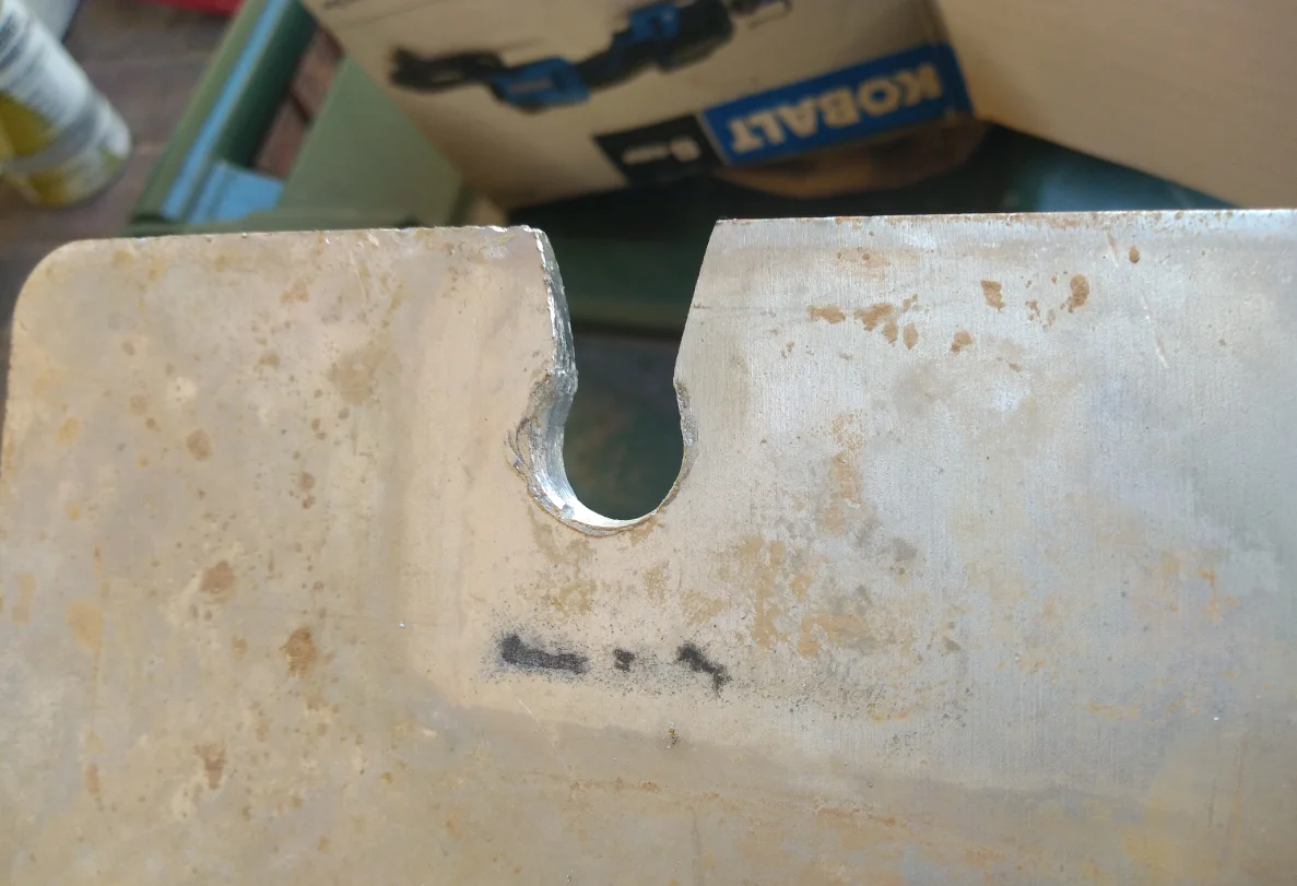

I had to slot my rear holes so that it'd mount to my slee diff drop
Also, for folks looking for hardware.... with a diff drop, you'll need one M8-1.25 x 110mm bolt in the center. The remaining fasteners and spacers that came with my diff drop worked just fine.
Another "slot club" member here. I'm all about ease of removal and installation. I used a larger washer for the bolts with the slot.
