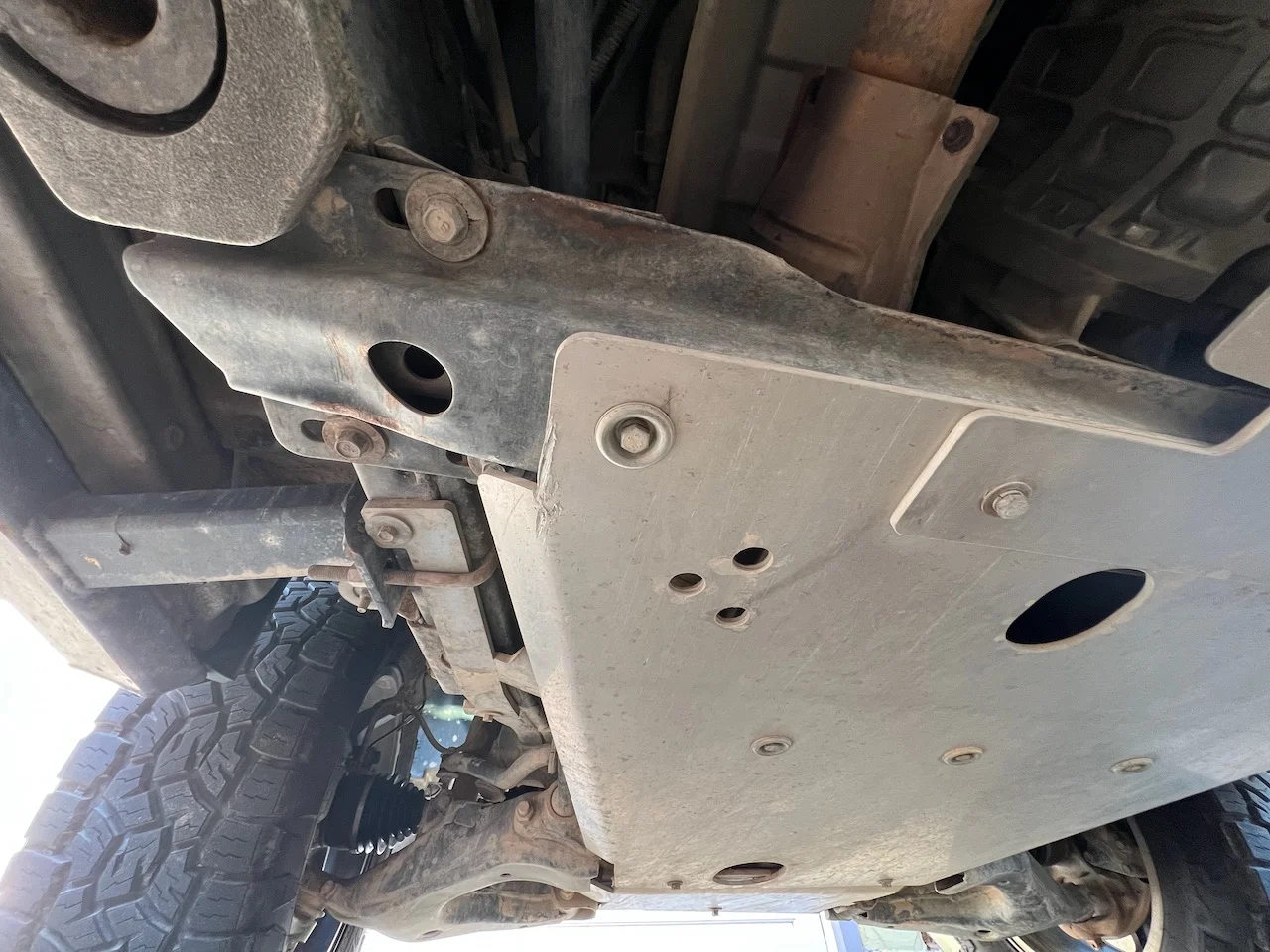

I like the ASFIR Aluminum Skid plates... They seem to be strong yet still light. I did take a file to all of the edges as they were very sharp when they came in from the factory. Took about a half hour per plate but they are nice and smooth on the edges and I don't worry about slicing myself...

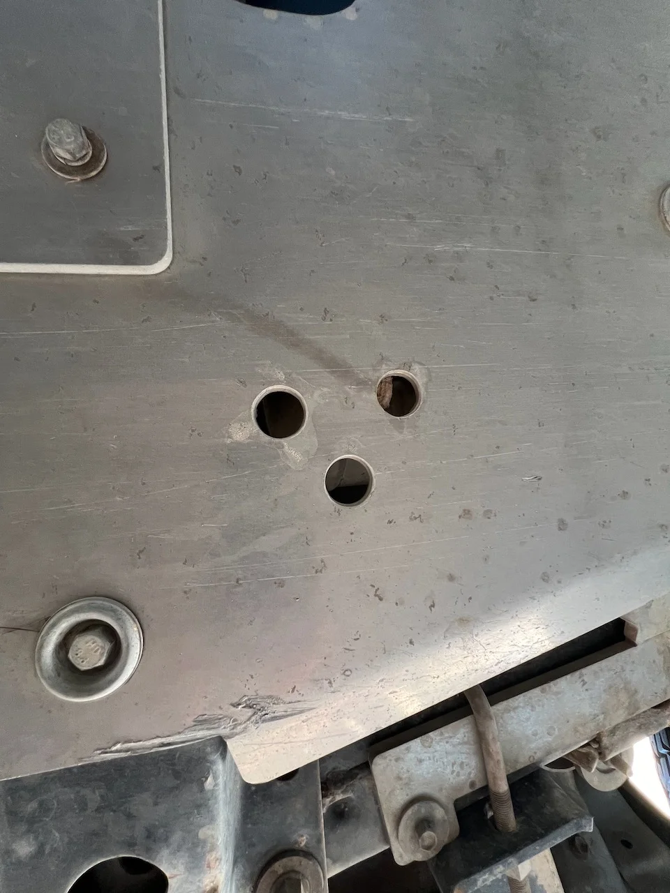

Here is a photo showing the 1-inch ventilation holes I drilled to expel some of the heat from the catalytic converter.
A closer view... Again, filed all of the exposed edges clear.

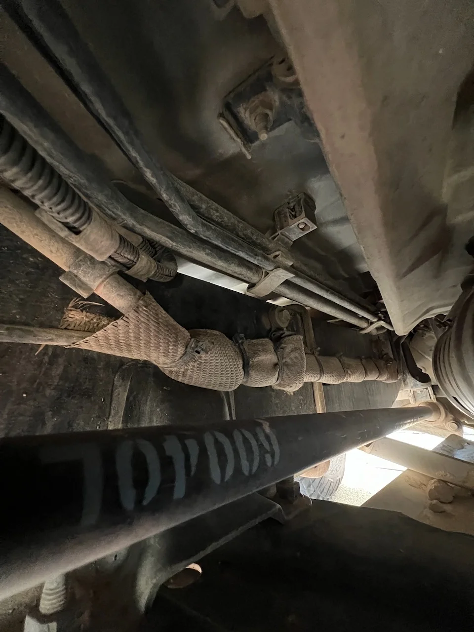

Here is a top view showing the insulation added surrounding the fuel lines. Adding this and drilling the holes has so far eliminated the "Boiling" fuel problem.
Note the trapped rocks on the skid plate under the brace...
