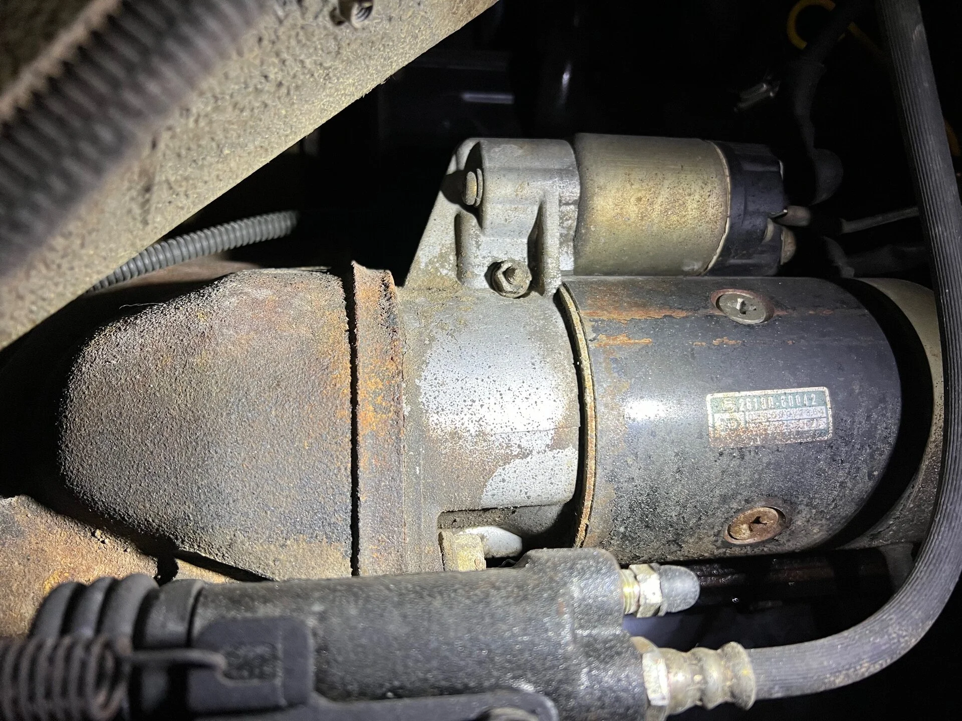

I still have the original starter on my 1981 US spec FJ40 and after trying to turn the truck over the past few months, it does start to bog down and struggle and feels like it’s on its way out. Therefore I’m looking for a “newer tech” gear reduction starter. I just need more “ooomph”!

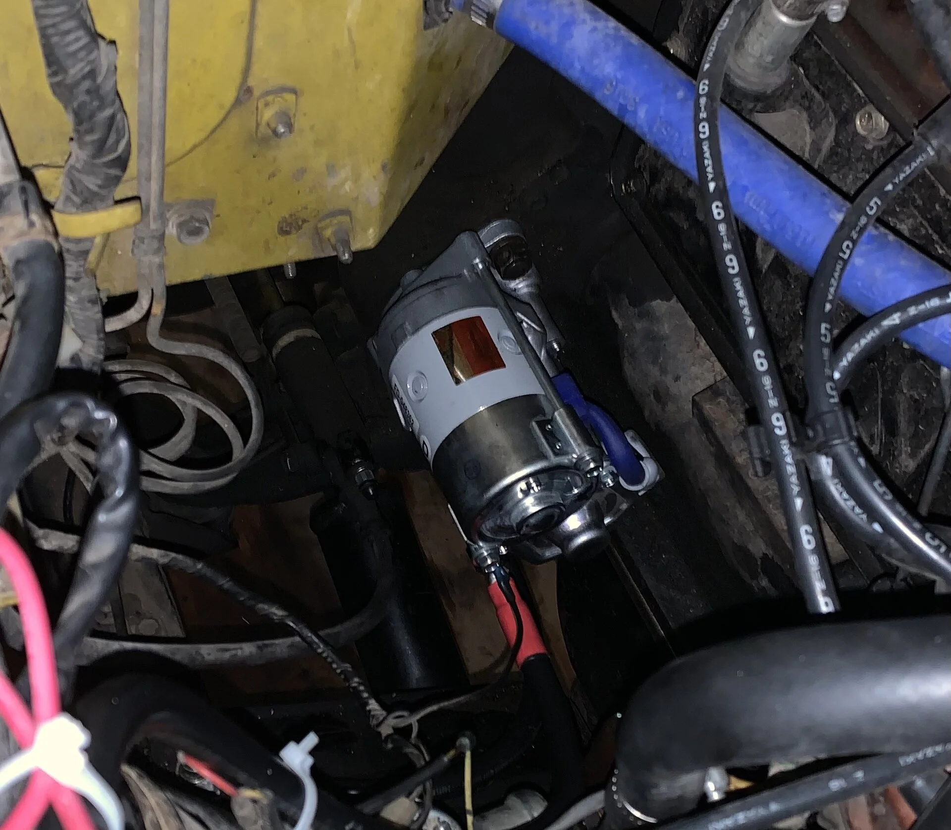

Special thank you to the OP, this thread got me off my ass and into the garage. New starter installed along with new cables from @Fourrunner This starter is a significant upgrade from my old direct drive unit, very easy cold start.

I went with the RMAN gear reduction starter and @Fourrunner cables - works and looks great. I dropped my old starter off at the local shop for TLC and it is rehabbed and on the shelf waiting for that day to get back into action. I'm a bit Klingon, for you Star Trek fans, like having redundant systems.

Thanks everyone.....I am ready to pull this one out. I reached out to @ToyotaMatt for now, but will look into all the great suggestions here. Some more pics of how old this one is (and sluggish).
Your starter will last much longer if you take it apart and clean/lube it every once in a while. Clean the commutator and check the brushes/springs. Use heavy duty cables to supply the amps and keep the terminals clean. Block heater are nice for winter places.
