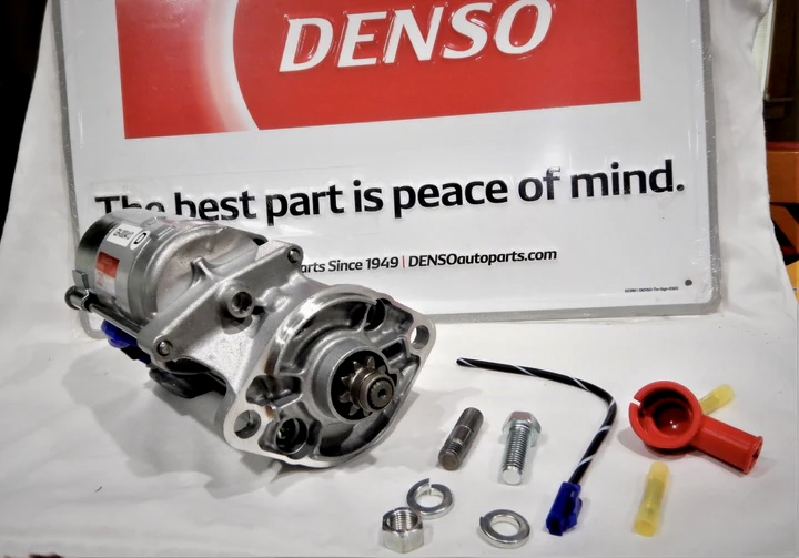

Another vote for Toyota gear reduction starter. Just installed one on my 1978 with @ToyotaMatt plug and play kit. Already had @Fourrunner cables.
Probably fires quicker with the old starter because the old starter bypasses the ballast resistor during cranking giving you a hotter spark. If you wired a relay to bypass the resistor with the gear reduction starter, you'd be amazed.Same.

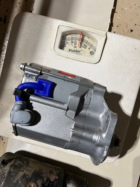

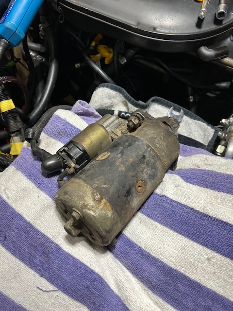

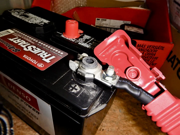

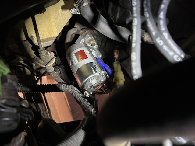

Where’d you end up getting your starter?Just wrapping up this thread here and wanted to give big thanks to @77mustard40 for helping answer small questions throughout the install of one banana for another smaller and lighter one. All I can say is what a huge difference this RG starter made for me in terms of starting power. Just really impressive....so working with @Fourrunner on getting some super nice 12/GND leads to finish off the install. Install was all of 40 mins and will take my time with the new leads to tidy up the wiring and routing - including reinstalling a ground lead on the block as well.
