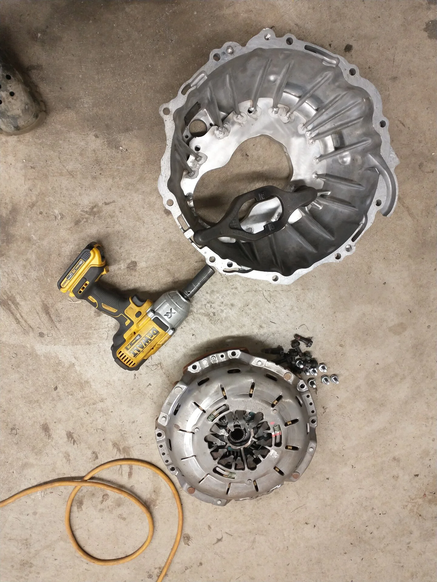

What bellhousing did you use?
Dellow Conversions?
I bought a complete 100 series bellhousing, milled off 1" from the trans end, made a 1" thick aluminum plate with the H55f pattern, centered and had it welded to the bell. It uses all the 100 series 300mm clutch parts. Has been working great! For the install I swapped the motor mounts left to right and then the pads lay flat on the frame instead of at a 45* angle. I did space the rear of the mount up 3/8" so it wasn't in a bind on the slope of the frame. I will see if I have any pictures.

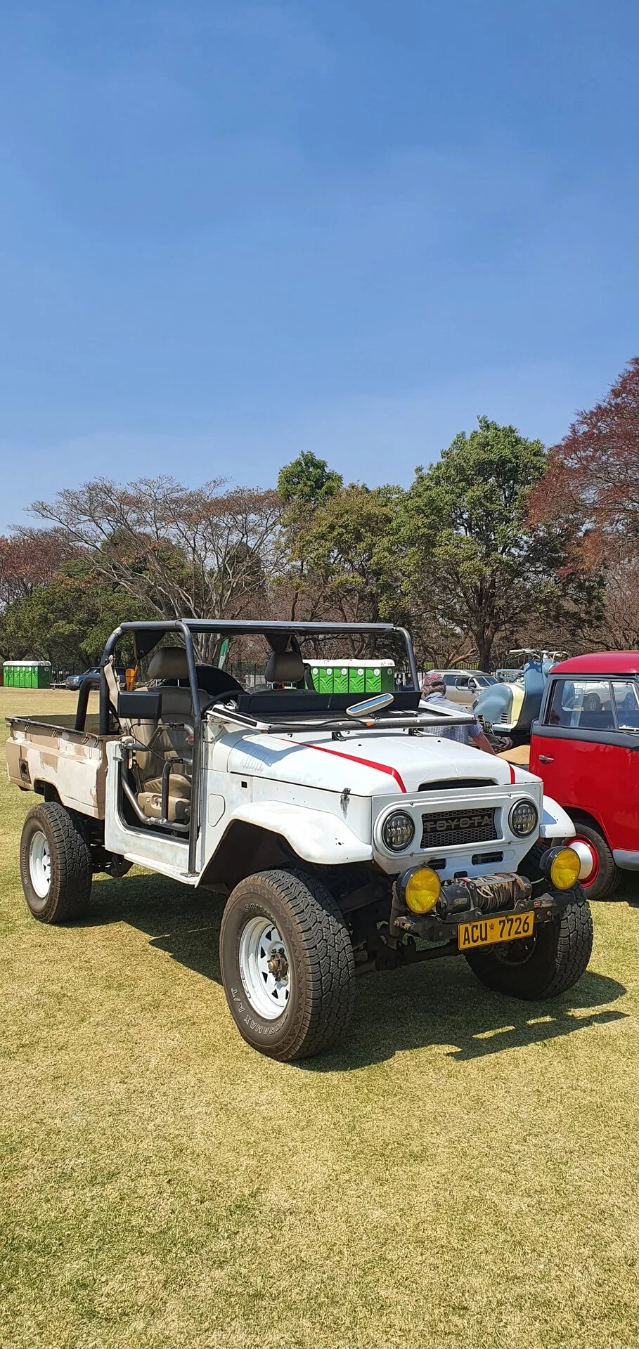

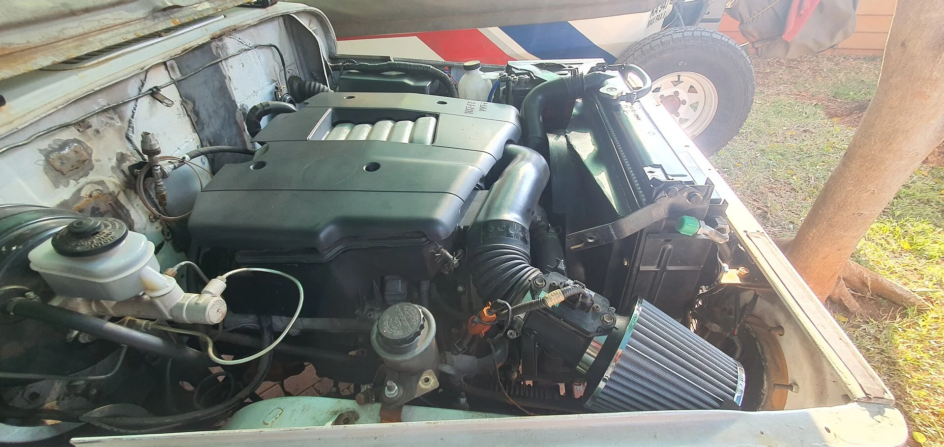

My build is a 1uz vvti on a stretched 2nd gen 4runner chassis with FJ45 body work.
Currently running the stock ECU and a650, but planning on going aftermarket ECU and a340 in the near future.
I drive it every day. Absolutely love my 1uz.
