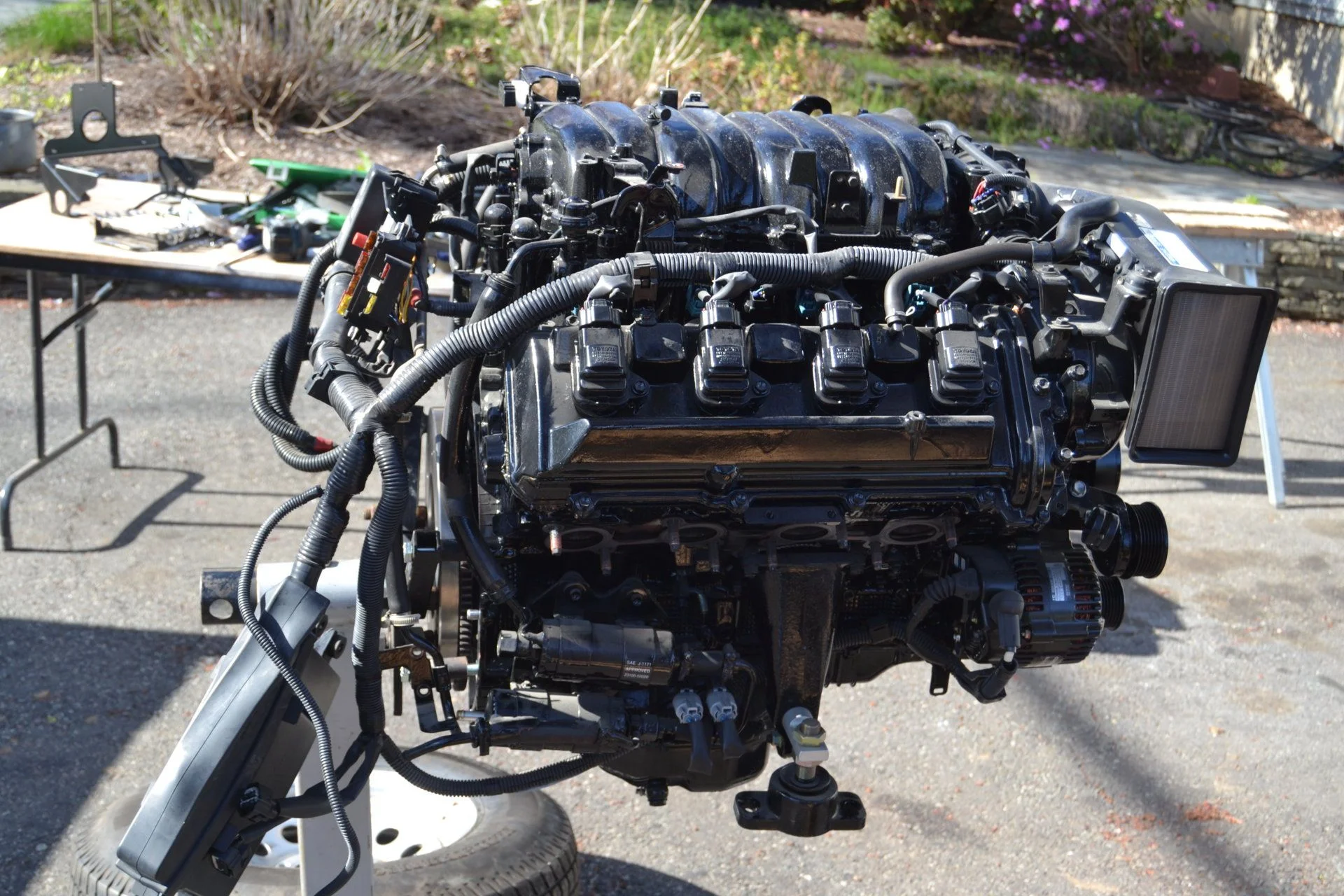

I have a 1UZFE and a Dellow bell housing mated to an H55f, a buddy of mine made the CAD drawing that Dellow used to make them. My 1UZ is from a Epic boat , made by Toyota for a couple of years. It has an ECU with no emmision controls , so no key lock out and three wire hookup.
I have two more ECU's that I would be interested in selling if someone can use one.
In Australia the 100 series comes with a 2UZFE and manual H151 5 speed, the same bell housing should fit the 1UZFE.
Problem is the H151 is a lot longer gearbox which could become a problem in a FJ40 unless you extend the wheelbase.
Those who used the Dellow housing were you happy with the fitment and quality?
I have two more ECU's that I would be interested in selling if someone can use one.View attachment 1575547
