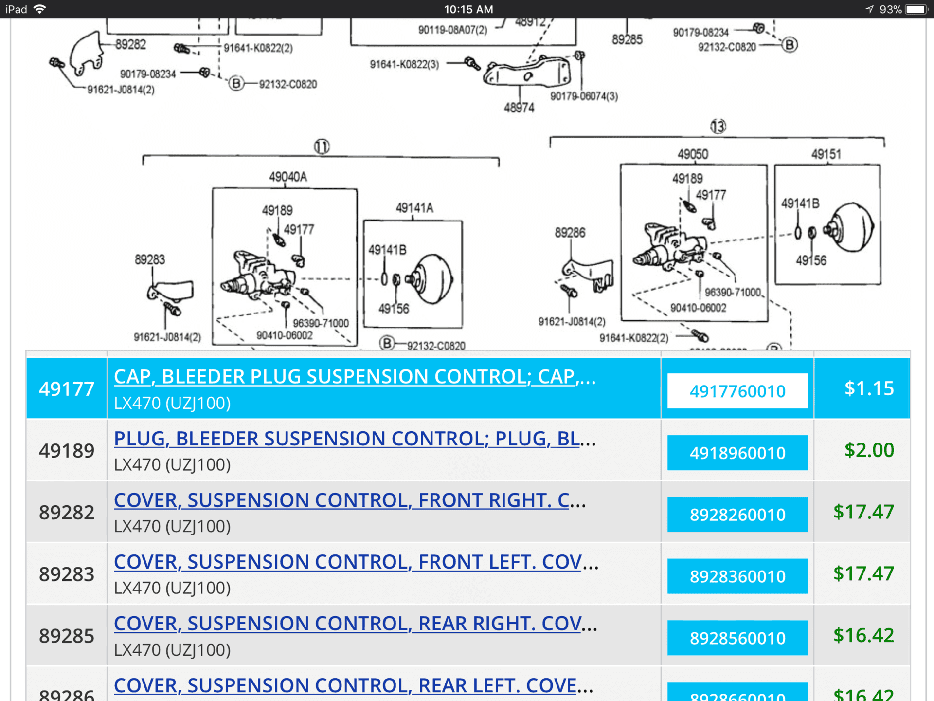

Stupid followup question... the rubber bleeder cap on the accumulator was ... ummm.. no longer rubber, and it crumbled. I'd like to replace all of them to keep road snot out of the bleeder valves. These took a 10mm wrench... others I have on other vehicles are 8mm. Will any standard bleeder cap fit? Don't have any spares on hand to try..
Any standard cap will fit just fine.

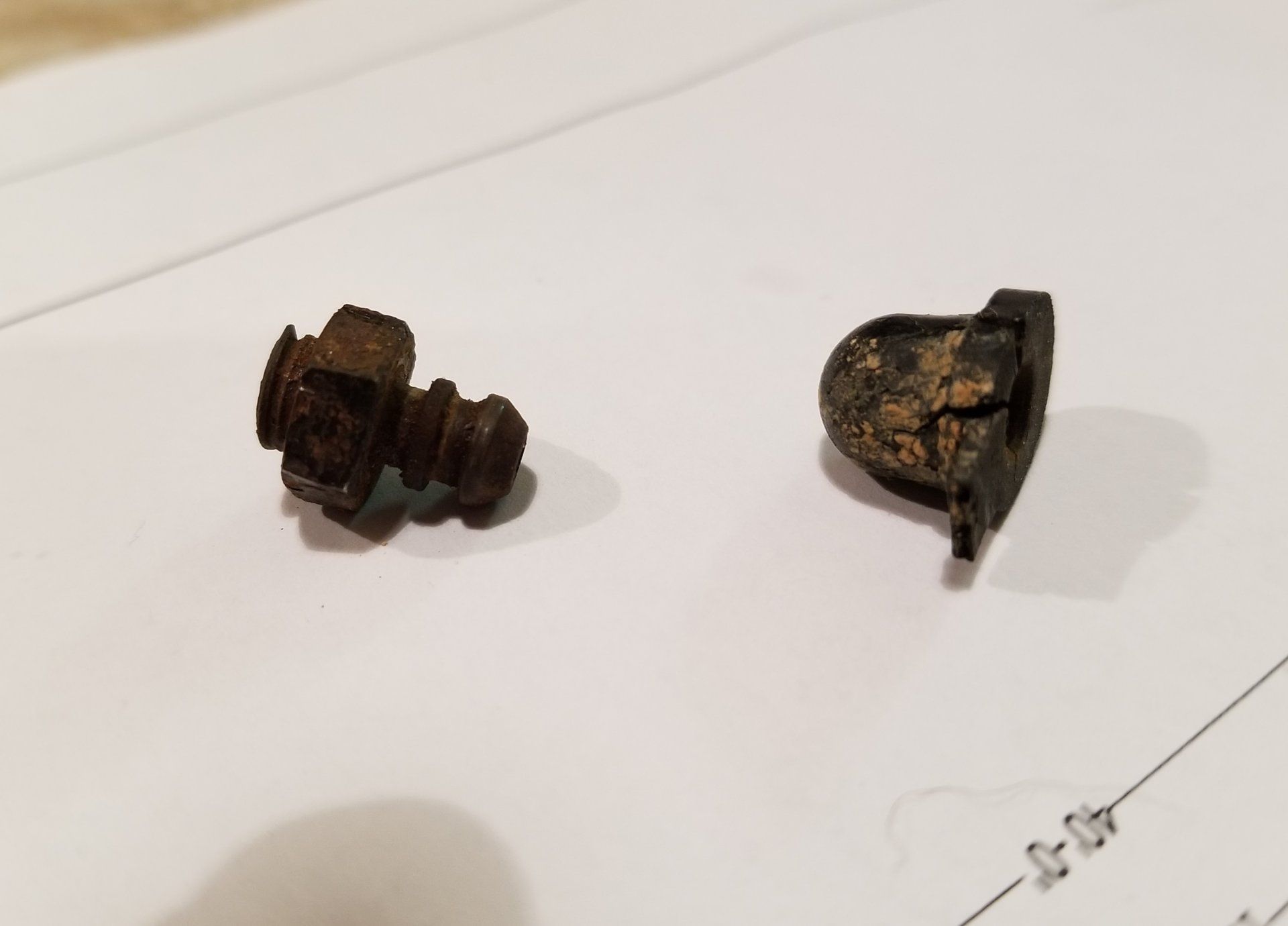

Well I too attempted to bleed my AHC this weekend, but I didn't have the luck that everyone else has had. Let me preface this by saying I can screw up a glass of ice water, so I'm not much of a mechanic. I did want to do this myself though, so I attempted it and failed. I don't know how but the bleeder valve/fitting on the accumulator sheared off while I was attempting to turn it. I know what you're thinking, but I didn't put much force on the valve at all. It didn't move immediately but soon did start to turn (or as I know now it actually wasn't). I soaked the fittings in pb blaster for a bit of time...I don't know what the heck happened. How screwed am I? No fluid ever came out of the valve, so as of right now I'm assuming it is still closed. I'll look for any puddles in the morning. Can this be fixed or did I just buy a whole new accumulator? I can ruin anything. Good news: One rubber dust cap now available in the classifieds section.
Get a good night's sleep, and don't worry. I doubt very much you will need a new accumulator. Bleeder valves are common stock parts..just need to make sure you get a replacement bleeder valve with the right threads. The trick is going to be getting the part that sheared off out of your accumulator; I've never had to do that, so hopefully someone else who HAS can chime in. It's probably going to make a pretty good mess because you now have no way of really directing or controlling the flow of the fluid as it escapes, but messes can be cleaned up.
Well I did the AHC flush today as part of baselining the LX, and the exact same thing happened to me today with head of the bleeder screw shearing off and leaving the other half in. Did you ever try drilling it out, or how did you end up fixing it?
None of the fluid has leaked out of mine yet...I'm debating just taking it in to the dealership and letting them take care of this one just because I don't want to fool with it.

For those who have to deal with corroded or broken bleeders and are reluctant to try and open them for your fluid exchange then the next best thing is to drive both the front and rear down to the bump stops in manual test [the active test] mode and then remove/replace the fluid out of reservoir. Doing it this way will maximize the volume of old fluid removed in one cycle and therefore reduce the dilution of your new fluid. Not as good as bleeding off from the five bleed points but much better than doing nothing.
Bleeder valves with rubber cap part numbers:
Thanks for the help and advice! I'm going to purchase a couple of extra bleeder screws before I attempt again.

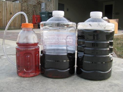

OK, finished my fluid change earlier today. There is a NIGHT and DAY difference in the ride. This took only an hour, and was a piece of cake. I used almost all of 2 cans of new AHC fluid. Other supplies cost approx $20.
I'll be doing the final update on the document later tonight. The steps used by RPMLX470 were by far the best.
I took a pic of my before and after AHC fluid. The jug on the left is the NEW fluid. The two jugs on the right are the OLD fluid that was pulled out. Notice any difference?
Again, can't believe how much softer my ride is after this...
Wow! Your old fluid looks exactly how mine looked. I though I was the only one that had fluid that dark. I agree, the ride is night and day difference. I've actually considered keeping my AHC after the flush now.
