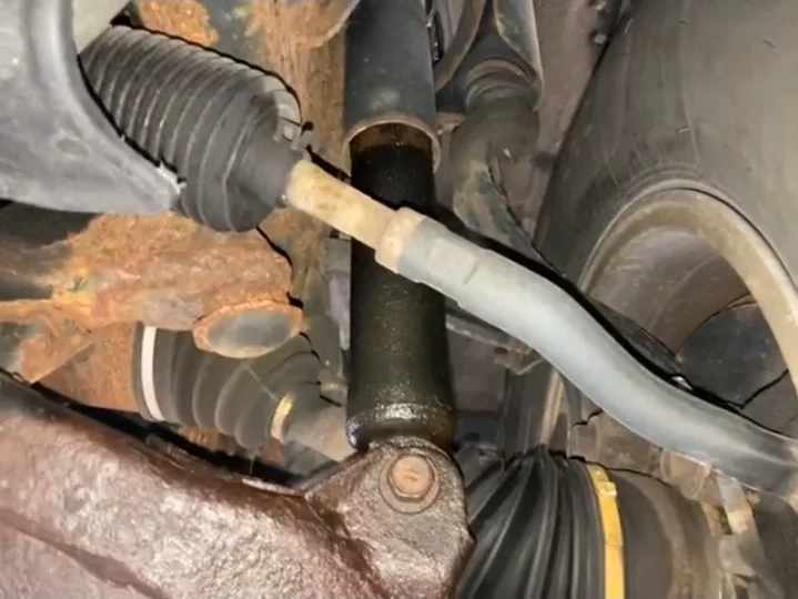

I took my 2001 LX470 to the stealership for a full inspection, I'm new to this and feel comfortable in fixing what I can. They recommend typical things like replacing worn ball joints and a cv axle with torn/leaking boot. One of the things they said was to replace all 4 shocks. From what I've read they usually don't need to be replaced, and that "weeping" is fine for the AHC 'shocks' but one of them is full on leaking with fluid all over the control arm. Is that a salvageable part or should that be replaced? The others seem fine, if a little wet, and can be ignored?
Videos I've seen only remove the AHC entirely rather than replace the hydraulic.
Any advice is welcome!

Given the amount of rust shown in your picture, you may want to have a shop or someone with decent AHC knowledge inspect the entire AHC system (all the lines) and see their condition. Rust is about the only thing that can kill these rigs and the AHC has a lot of lines and components that the rust can take out.
All/most the AHC bits and bobs are still available new, but once the rust starts taking pieces out it can get expensive quickly if you aren't replacing the components yourself.

Perhaps.... but "super cheap" ? An actual failed AHC piston is very uncommon but the weeping is not uncommon and a very manageable option that costs pretty much $0 ....which is super cheap.

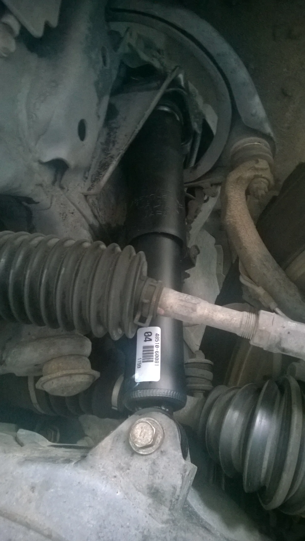

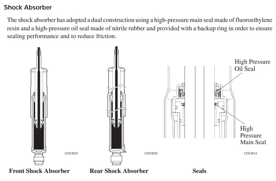

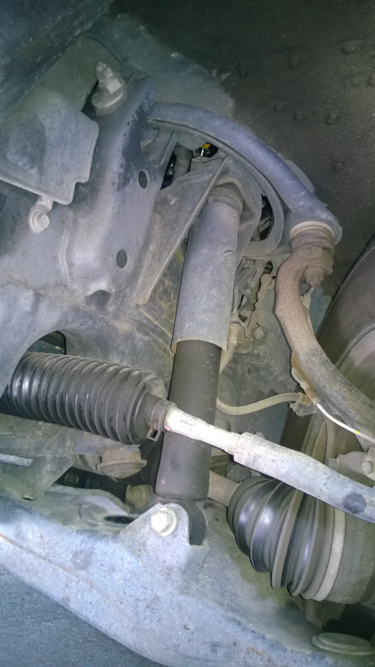

Way back in 2016, as an AHC beginner before I was MUD-trained by @uHu and others, I allowed a Dealer's Mechanic to pursuade me to change the Front 'shocks' (which as I learned later, are not conventional 'shock absorbers' -- no gas -- but simple hydraulic struts -- actual damping is done by the Damping Force Control Actuators to which the 'globes' are attached).
The change-out was completely unnecessary.
The weep was caused by failure to monitor AHC pressures over time PLUS having ARB fit an ARB Deluxe Bullbar (adding around 80kg or about 170 pounds) WITHOUT correcting Front AHC pressures by simple adjustment at the Front torsion bar adjusters, then hitting a few 'interesting' trails with Front AHC over-loaded!!
So step #1 is to use the Torsion Bar Adjusters to transfer load OFF the Front AHC system and ON to the Torsion Bars. This could take as much as 15 minutes per side! The correction may elliminate the leak unless there really has been damage to the internal seals at the pistons ....
If you decide to go ahead with change-outs of AHC 'Shock Absorbers', then the following link gives some good descriptions and pictures:
In my case Toyota/Lexus Part Number 48510-60081 was used for both RH and LH Front 'Shock Absorbers' -- there are some differences in Part Numbers for different Model Years (particularly relating to the details of the hollow tube at the top of the 'shock absorber' and the Upper Bush/Cushion) -- so it is best to check using the VIN for your vehicle.
