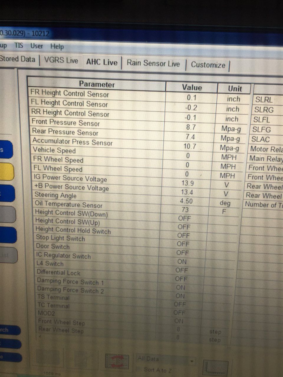

I happen to work at a Lexus dealership in the sales department and did the work at our shop on a Sunday. After the work I hooked up a techstream computer to the car and got an abnormal pump pressure code C1762 along with the attached AHC Live readings which made me nervous as there was no reading for front pressure sensor as well as accumulator pressure. I was in a hurry so I went about my day but I intend to hook the car back up to the techstream to get some new readings. In doing some additional research I saw that to "refresh" the reading, you could put the vehicle in the "L" setting and bring back up to "N", then look at the AHC live screen. I was hoping to try that then see what the readings are. The system seems to be working properly as it did before the fluid change. 9 notches of movement from "L" to "H". its an '03 with 72,000 miles.
Will update once I have new readings.. this is what I have now.
C1762 is a very common fault code, often as a result of some inconsequential transient hiccup. It could be ages old too. Clear it (the little engine with eraser symbol) and think about investigating if it returns. The one pressure sensor reads the pump output as the leveling valves and accumulator charging valves close - it's the leveling valves that actuate when you raise or lower - so the pressure sensor is working. I'd clear the dtc and redo and expect things to read normally. Nothing wrong with cycling between L to N back to L to N to check the pressures.

So I hooked up the truck to the techstream last night and Im glad to report that the code was gone. Yesssss!! The pressures do seem a bit high so I guess the next step toward will be to crank the font torsion bars to get the pressure inline with he factory specs.. The truck had a front brush guard installed by the previous owner which seems pretty stout and heavy. I have not yet decided if I am going to keep i or get rid of it but I suspect that its weight is adding some additional pressure to the front end. Here is a shot of the readings from yesterday. If anyone has any feedback I would love o hear it. What do you guys think of he brushguard. yay or nay...

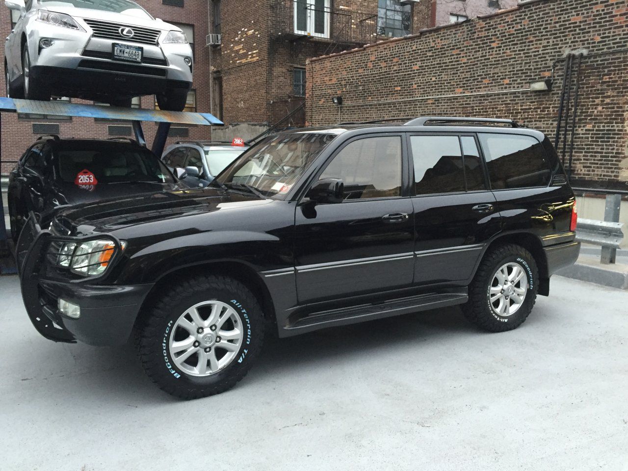

we have the same exact color LX! what tires are those, and how is the road noise? personally not a fan of the bolt on brush guards that leave the stock bumper in place. granted, you are in NYC, so it might prevent people scraping your bumper if they park in front of you on the street.
Pressures at 8.7/7.4 are rather high. Get them down around 6.9/6.0 MPa and assuming your 4x damper accumulator globes are still healthy your damping and ride quality will be much better. Standard approach: check and adjust cross level; check and adjust front/rear heights; install coil spacers w new coils if required (likely); adjust torsion bars for optimum damping which should be around 6.7-6.9 MPa front. Well covered in the "definitive list of AHC maintenance items" thread. Start reading at the end and work backwards if you like.

The tires are 285/65 R18 BFG all terrain KO2s. I had a set on my old jeep and loved them. They look aggressive but are relatively quiet on the road. They are load range E so a bit stiffer then the stock rubber but it's a trade off I was willing to accept.
I think I will keep the brush guard for the time being but I don't love it.

I've got to the do the same. Just did the AHC flush this evening and need to drop front pressure by about 1Mpa-g
