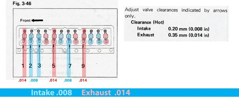

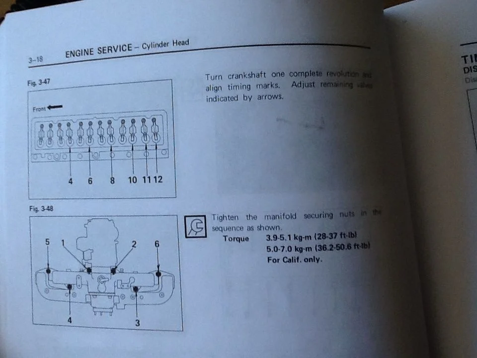

Here's the rest of the adjustment order (there's a second figure) from the FSM
