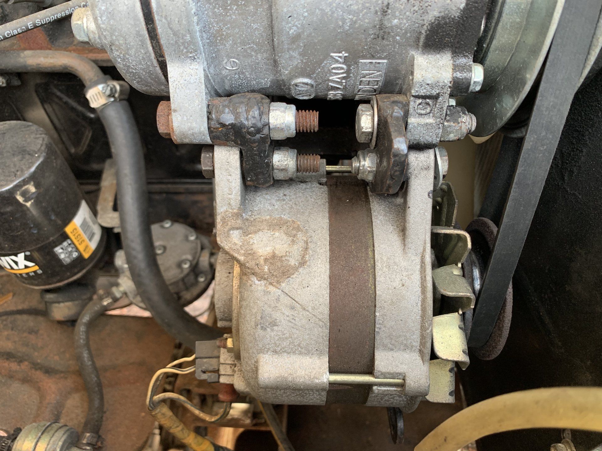

I wish I could provide more details on my A/C. Previous owner, BBQBoy, sourced an original pig system and had @Trollhole install. System used all factory components for the interior but I know the parts under the hood are not. Have a video of the engine compartment which shows the compressor arrangement but I’m not smart enough to attach it. Here are the only stills I could find in my photos.
