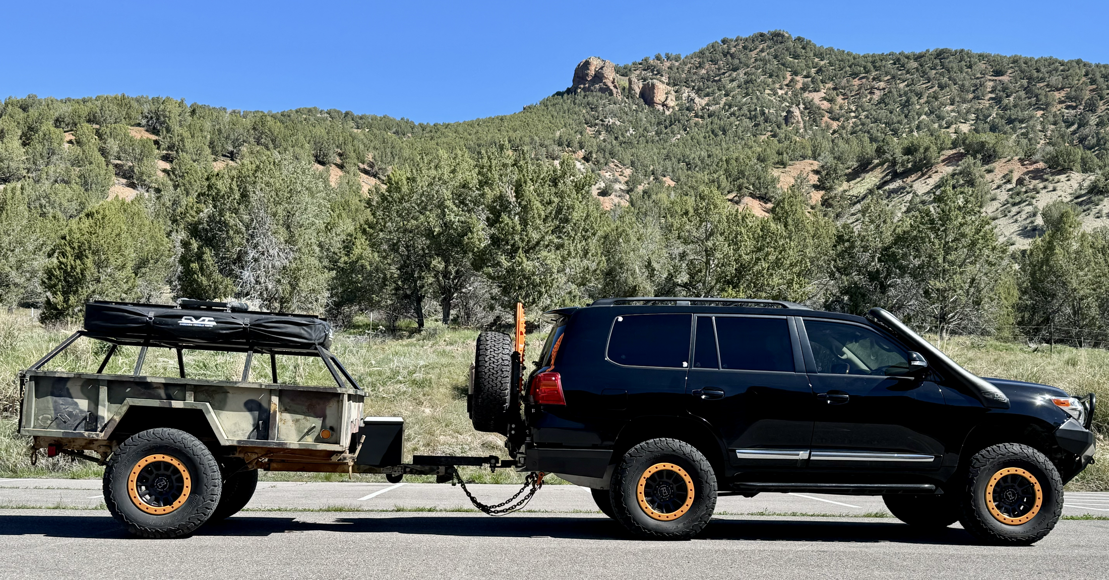

Would love to see your rig on 37s and there are definitely things that can be simplified over my install with narrows and some other tweaks

I can’t speak to anything KDSS related since I’ve never even laid eyes on one. Having just switched from a 7.5” +25 with 37x12.50 ko2s to a 8.5” +10 36x11.50 toyo it does have more poke and may end up rubbing if I try to wheel it or when I inevitably tow 8500lbs. I thought my old setup would rub when I first put them on 3 years ago, but it was almost flawless.
