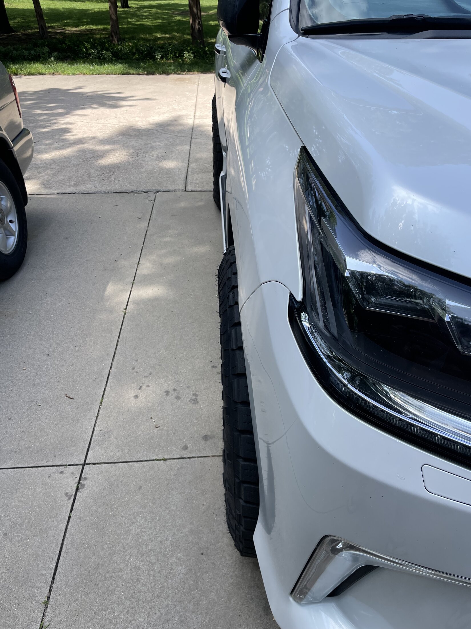

Just FYI, I had to trim 2” off the dissent wings on each side to clear at full bump/lock
Do you have the NST body lift on your truck? I had the boys at Dissent make me a custom bracket that accounts for the 1.5inch body lift, so hoping that will give me the extra clearance needed to not have to cut the wings.
Yup, 1” - you’ll be shocked though at how high you can actually stuff the tires at full bump. I use this picture a lot as the example. I trimmed more after this but you can see the issue.
