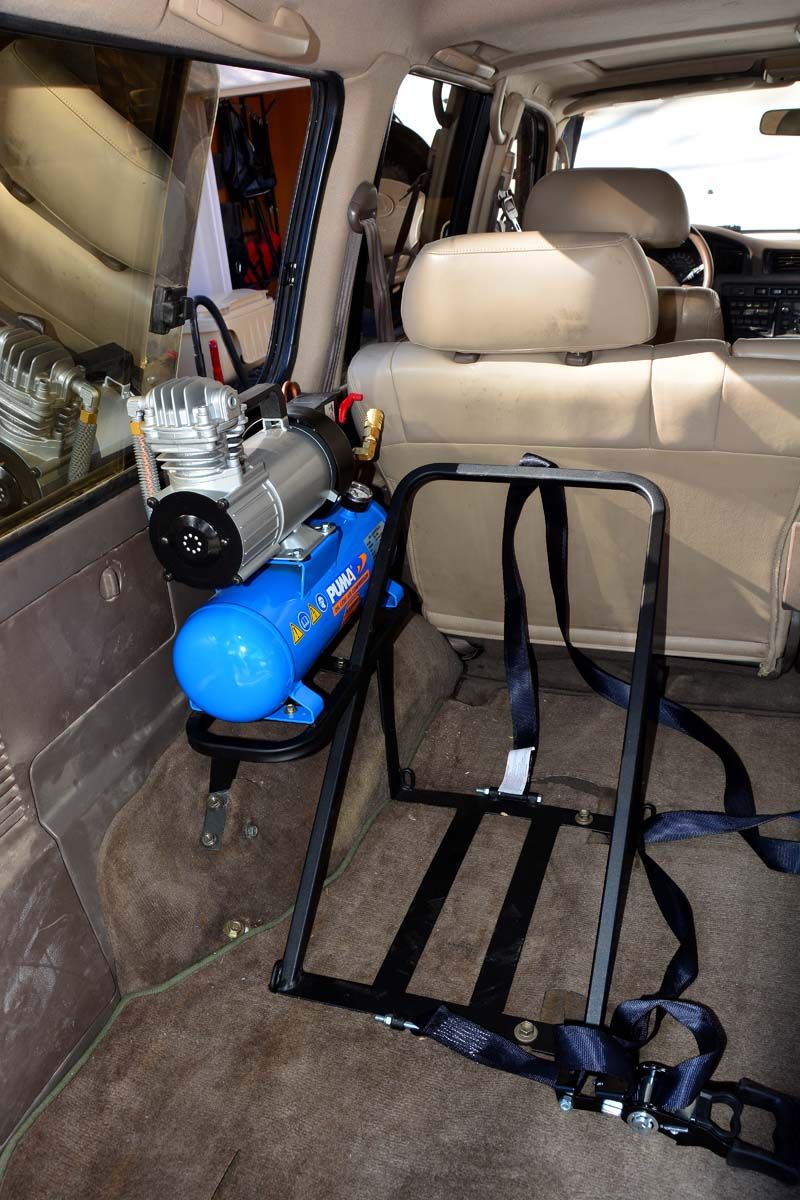

News for the LX - thanks to Tools R Us for the tire carrier/Puma mount:

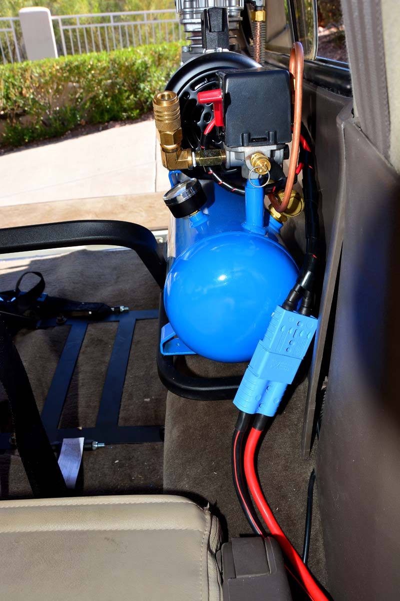

For the Puma, SB120 onto the stock Puma harness, then 4 gauge to the battery, with a 60A breaker:
So, this is the first Puma compressor I've set up with a 60A-rated breaker instead of a simple 60A Maxi fuse.
Of course, on the first air-up yesterday, it tripped the breaker (none of my two others had ever tripped the fuse...) - which then refused to be reset ... It did comply after a while, and no more shenanigans while airing up the rest of the tires. We'll see how long that breaker (I got it on amazon a while back, originally destined for something else) remains on that truck.

Check your wiring in the pressure switch if you rewired it for interference head bleed valve, Rudster had a problem after his was rewired. FWIW I know of many PUMA's running off a 50Amp Buss breaker and never a problem.
Thanks for the info; I didn't touch the wiring on the Puma itself, just added the power pole connector.
The breaker sits on the back of the battery box, facing the evap canister - maybe there's a temperature issue.
As I said, after a few minutes (spent rummaging through the boonie box in order to cobble up a temporary solution for the problem...) the breaker could be reset, and it held for the rest of the tires. We'll see what happens next time.

P.S. LX Puma compressor wiring: breaker is gone, we're back to a maxi-fuse, no more problems since.
