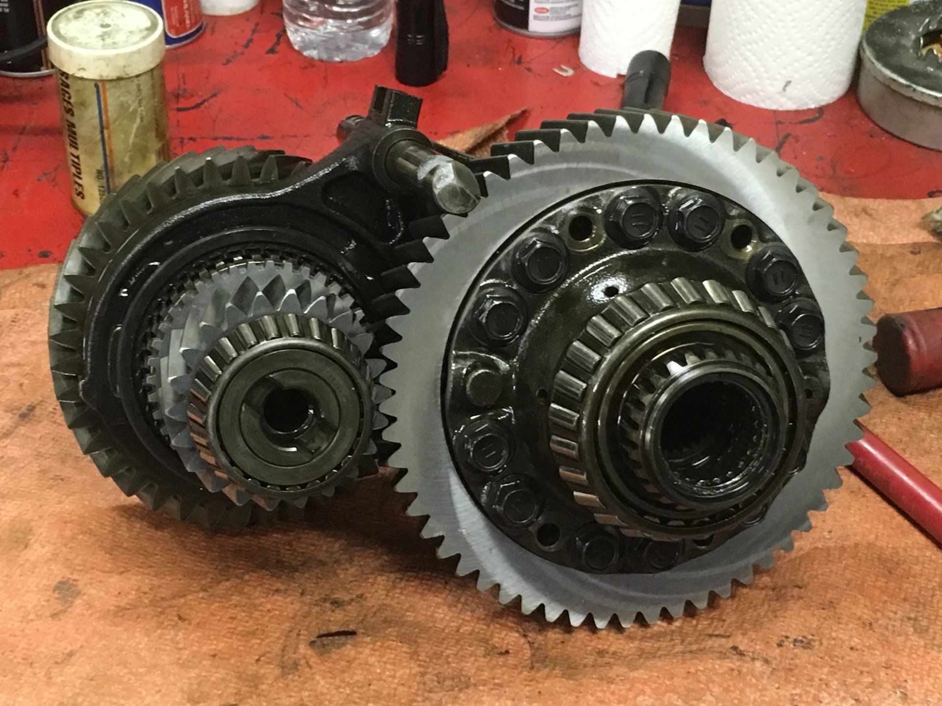

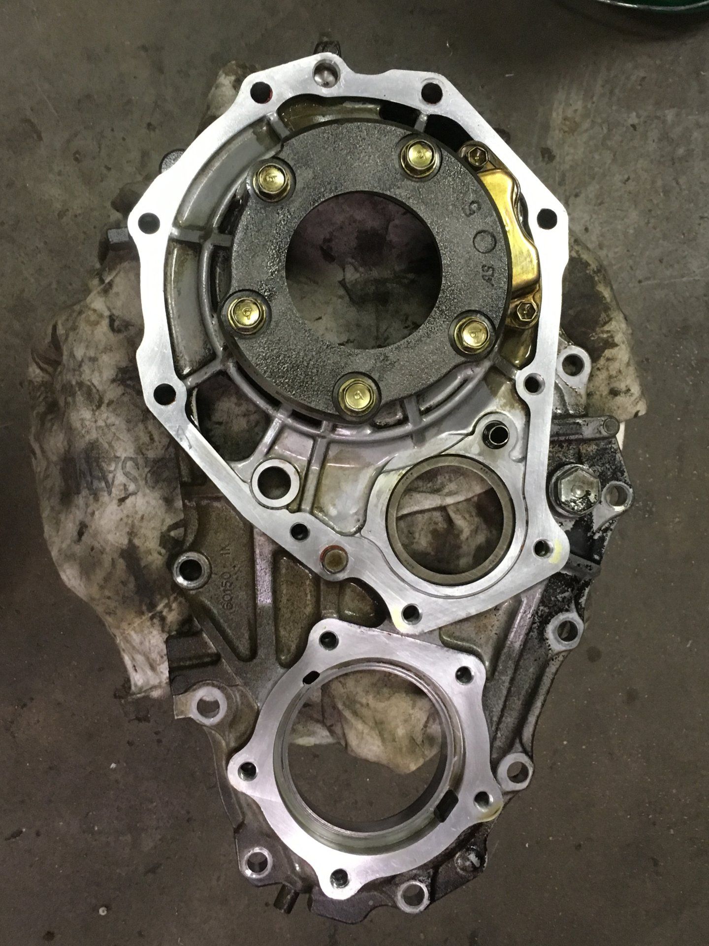

I may not have mentioned it before, but the LX also got crawler gears recently
one got the Marlin's (which had been sitting on a shelf for several years :rolleyes:), the other got Trail Gear's (with a discount from Low Range Offroad :grinpimp:)
