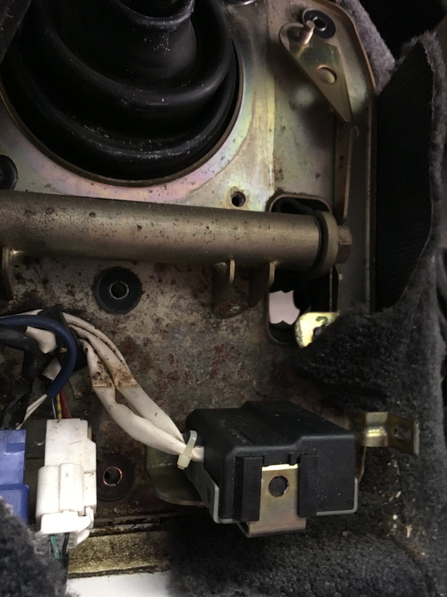

ratted out leather on the shifter handle
there's a big hole in the black rubber boot right where the shifter linkage in the middle of the pic goes down to the transmission . . . just to the left of that shiny brass tab looking out from under the carpet on the right side . . . (looks almost like an Apple logo)
couldn't get the right angle to make the red creeper underneath the truck show through the hole, sorry
