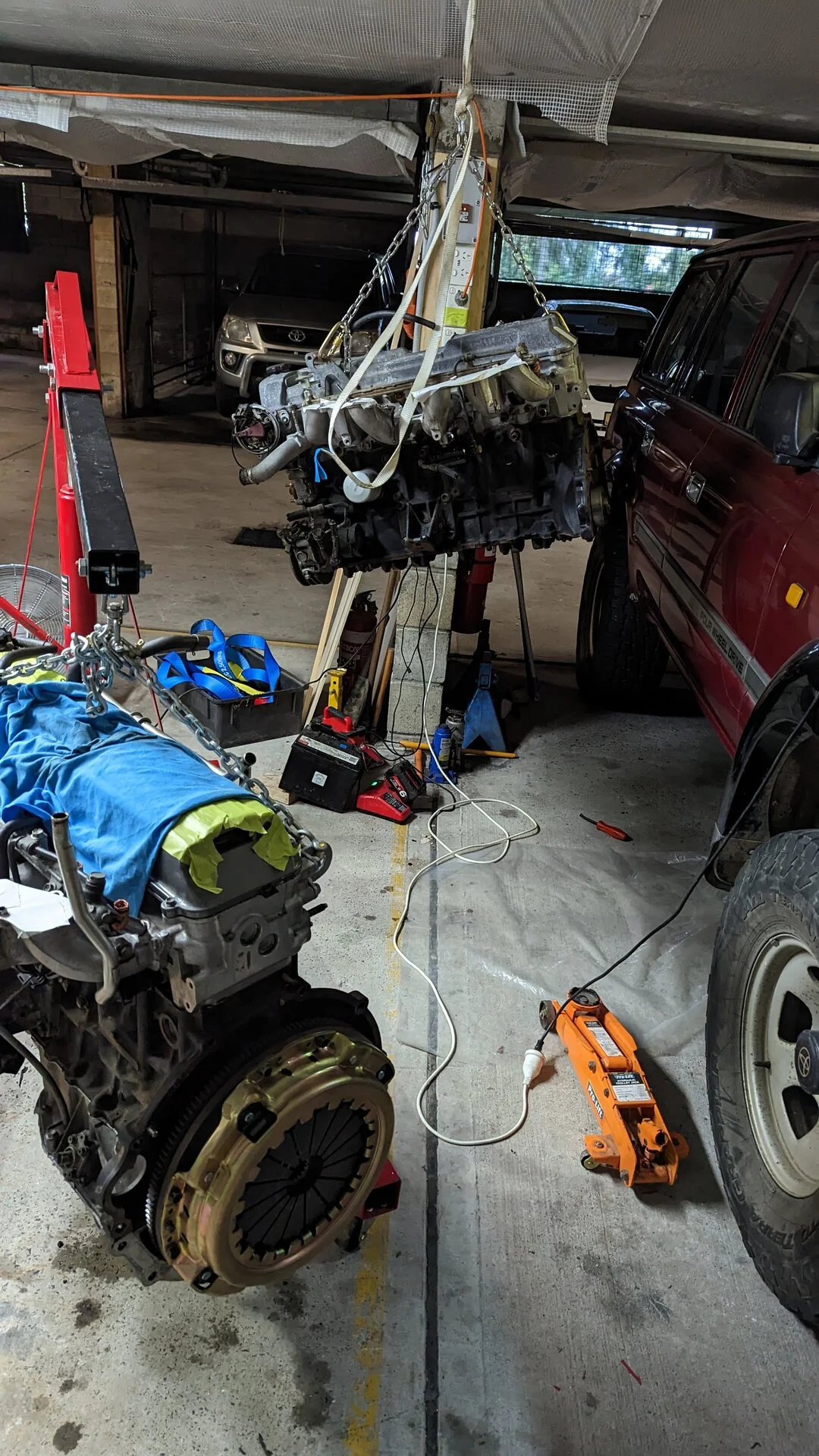

After reading through @80 Life thread, I decided the most sensible thing right now is to swap out the original engine with a used one. Then I can take my time to diagnose and rebuild the original engine

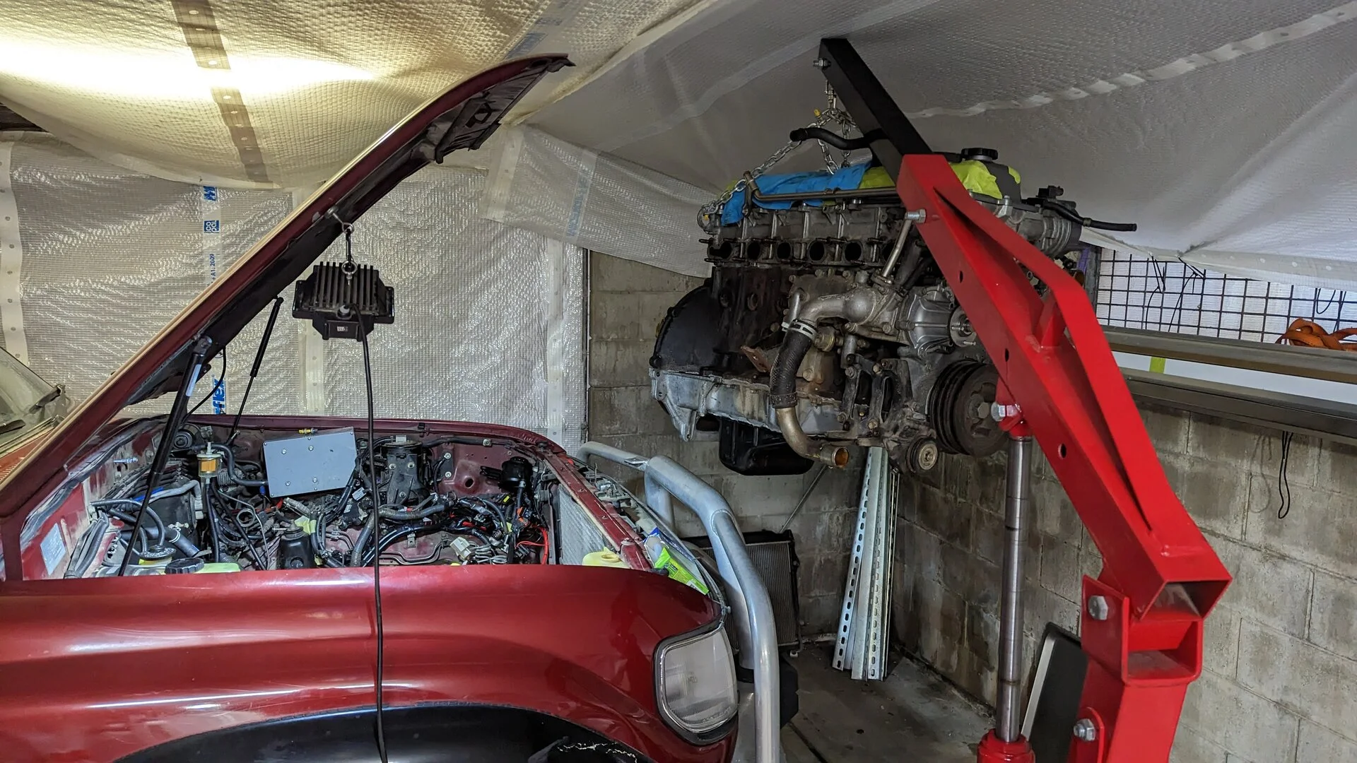

Used engine cleaned, and hanging from the roof.
My engine on the engine crane
Picked up a used engine for $900.
Spent Thursday degreasing and pressure cleaning it, the stripping unwanted parts like cut wiring harness, cut hoses etc.
Discovered several sensors were broken or missing. I knew the oil level sensor, and oil pressure sensor were missing, but a temperature sensor, and both knock sensors were broken.
If I knew how much all these puppies cost, I would have bargained harder on the price.
The top sump had some damage that means it needs replacing, but I got a spare from the engine seller.
Because I'm taking the sump off, I'm going to change the rear main seal too.
With a bunch of new seals, sensors, some hardware, dizzy, plug leads etc etc I've got over $1000 in parts coming
So long as the engine is good, I think I'll recoupe my cost.
Spent time yesterday removing the sump, and flywheel, rear main etc, cleaning old sealant of etc.
Then today, spent time stripping and disconnecting parts off my engine, and pulled it out.

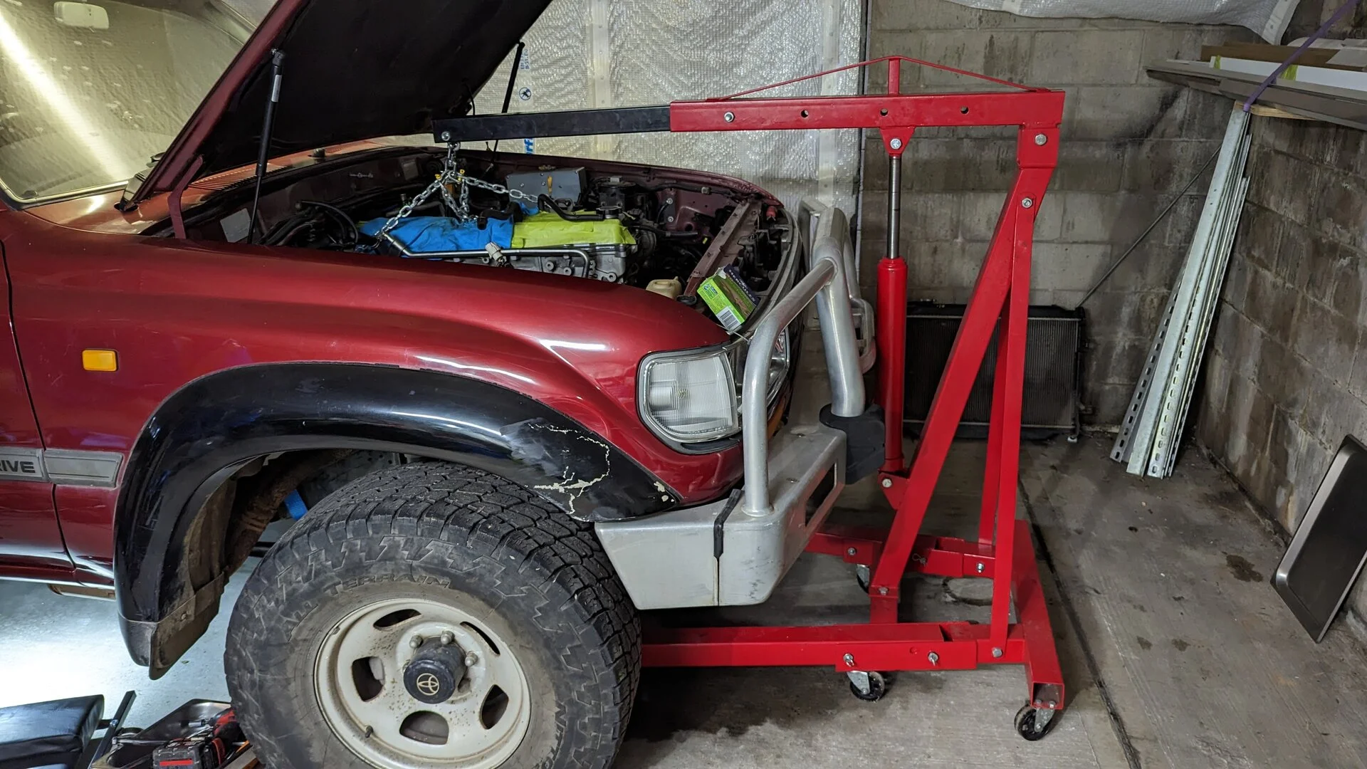

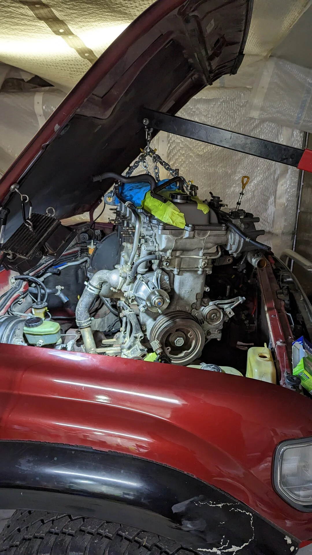

I left the hood on (forgot to take it off)
This meant I had to keep chains on the crane super short.
The crane just cleared the hood to lift the engine. I had to turn the engine sideways and move the crane forward to get clear of the rad support
@jaymar my 2 tonne crane at full stretch. And pushed hard against the bull bar
Turned sideways to get more clearance to the hood.
It's out!

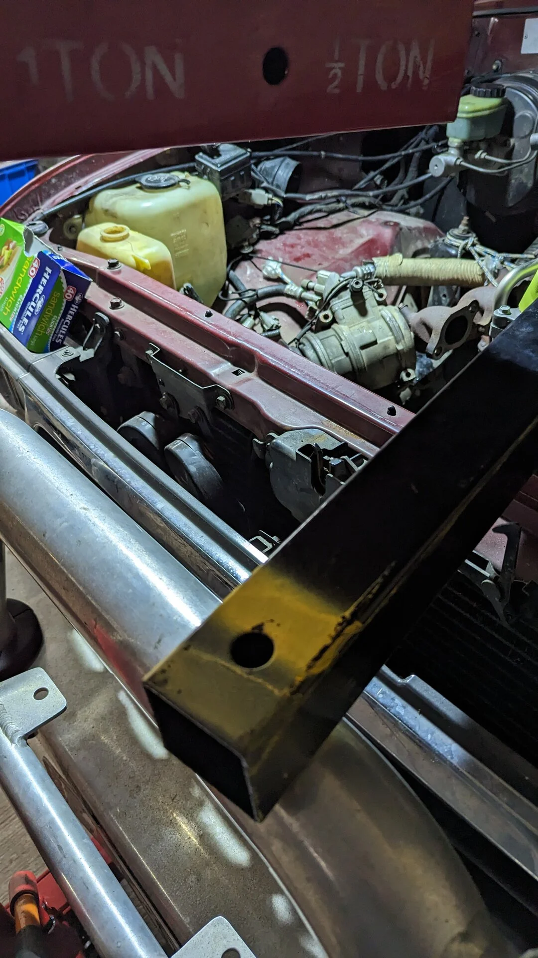

Sketchy moving there crane with the engine so high, and at full stretch. Needs to be on a smooth flat surface.
A little tip, I sprayed some yellow paint on the extension tube for the jib.
It makes it super easy to line up the holes when changing jib length. As you side of in/out you see the yellow spray as the holes approach alignment.
