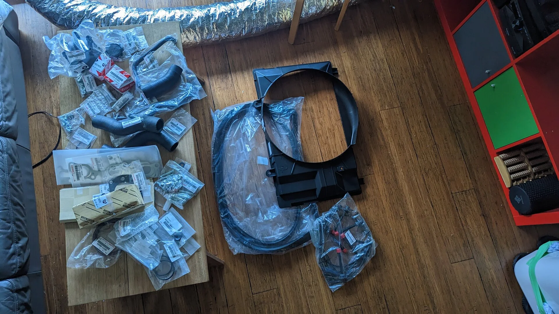

Welp, here's what nearby $2000 worth of parts, shipping, and customs duties buys me.

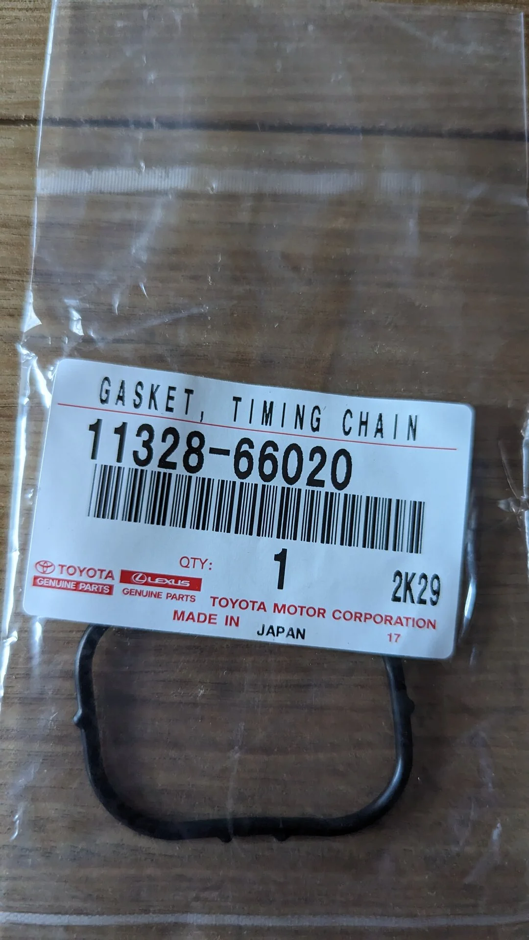

Gasket, timing chain 11328-66020 this gasket goes between the sump and the timing case to seal the oil pick up tube from the sump.
This is one thing I suspect may be responsible for the oil pressure issue I have with my engine

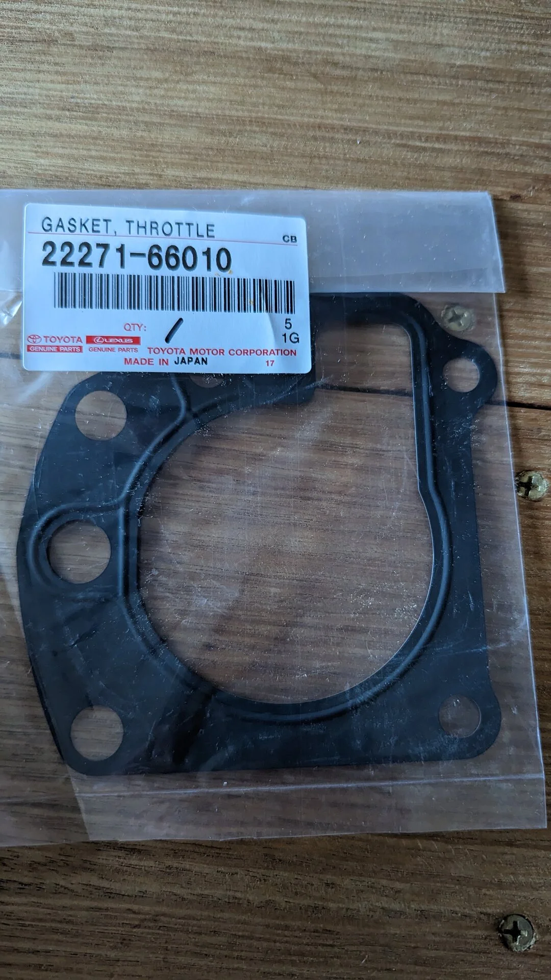

Throttle body gasket 22271-66010

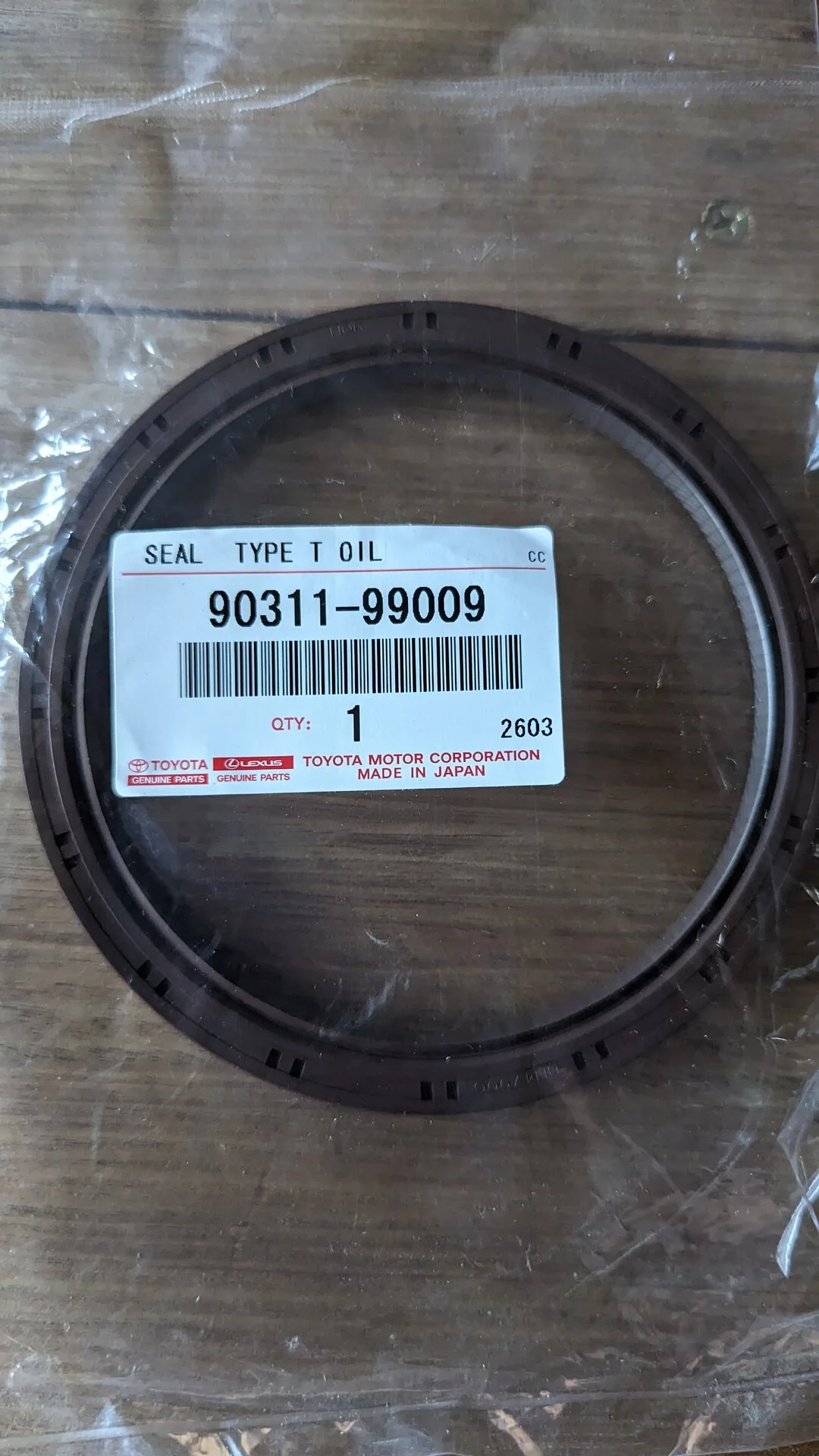

Rear main seal 90311-99009

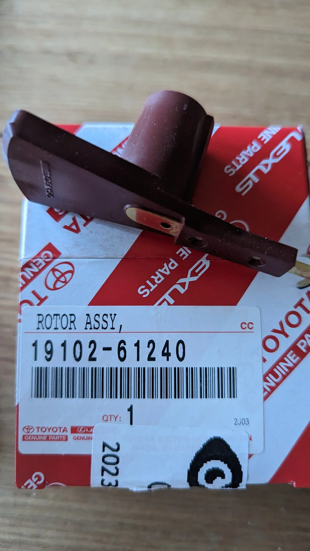

Rotor button 19102-61240

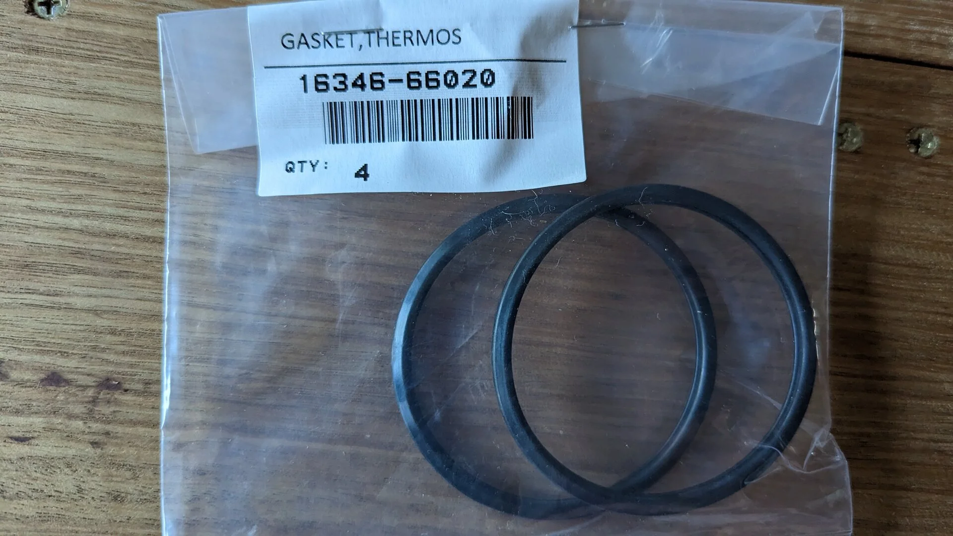

Thermostat housing seal 16346-66020

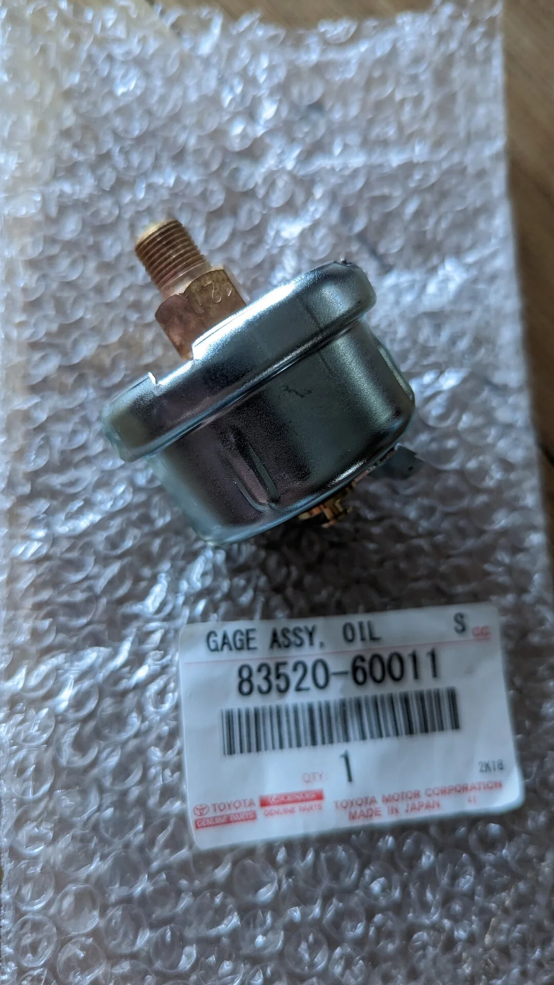

Oil pressure sensor for oil pressure gauge 83520-60011

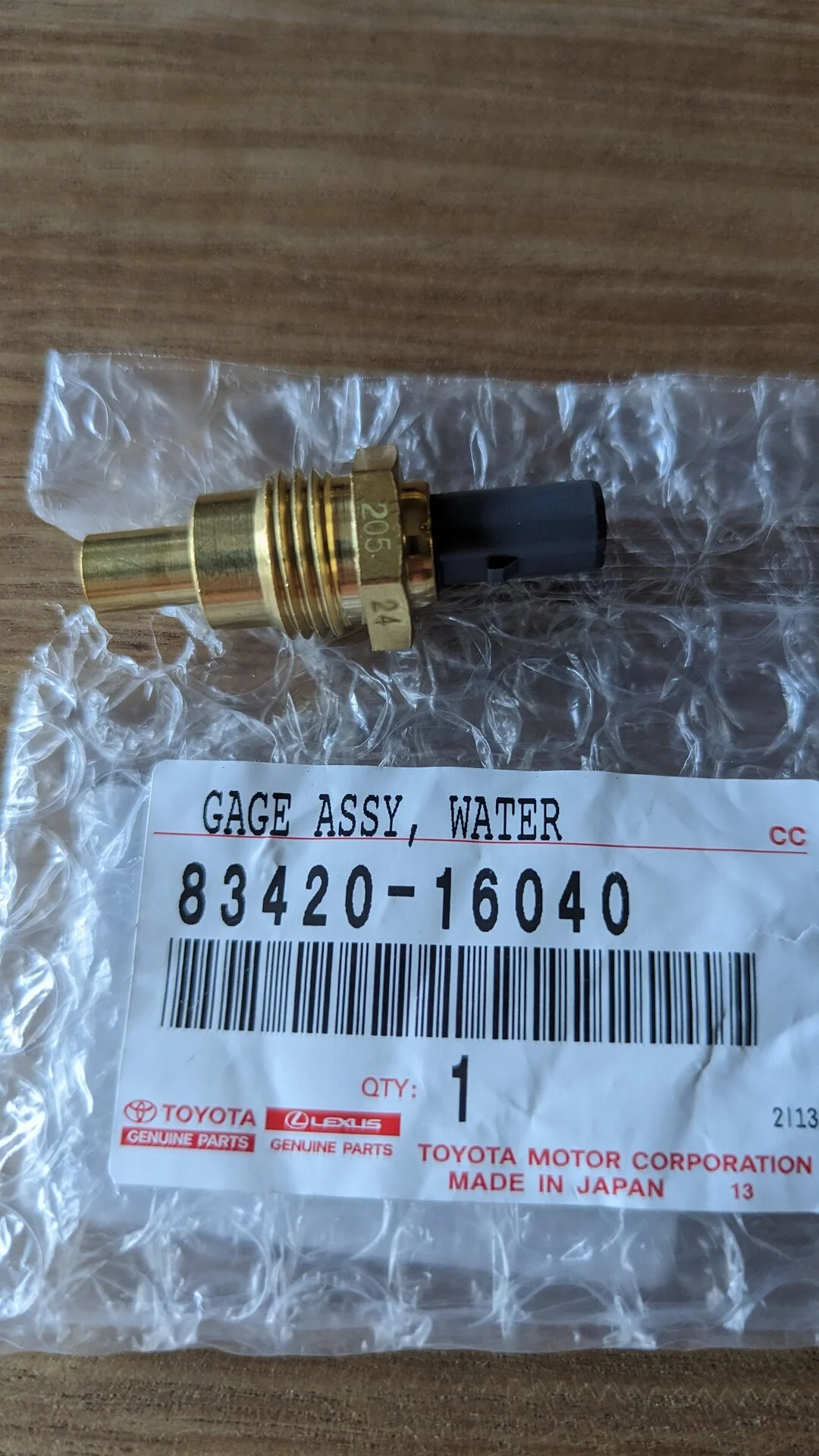

Temperature sender for gauge 83420-16040

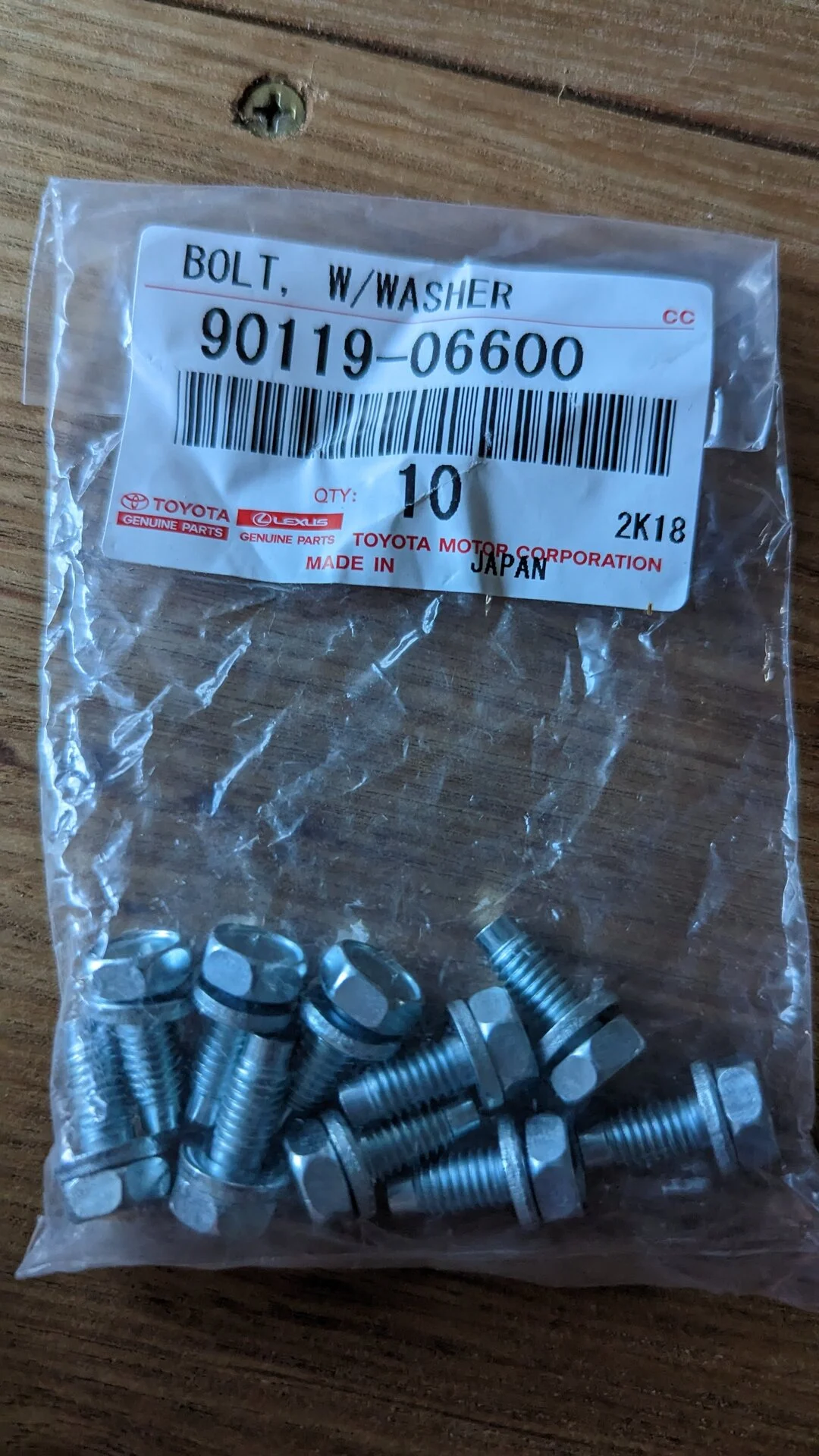

Lower oil pan bolts 90119-06600

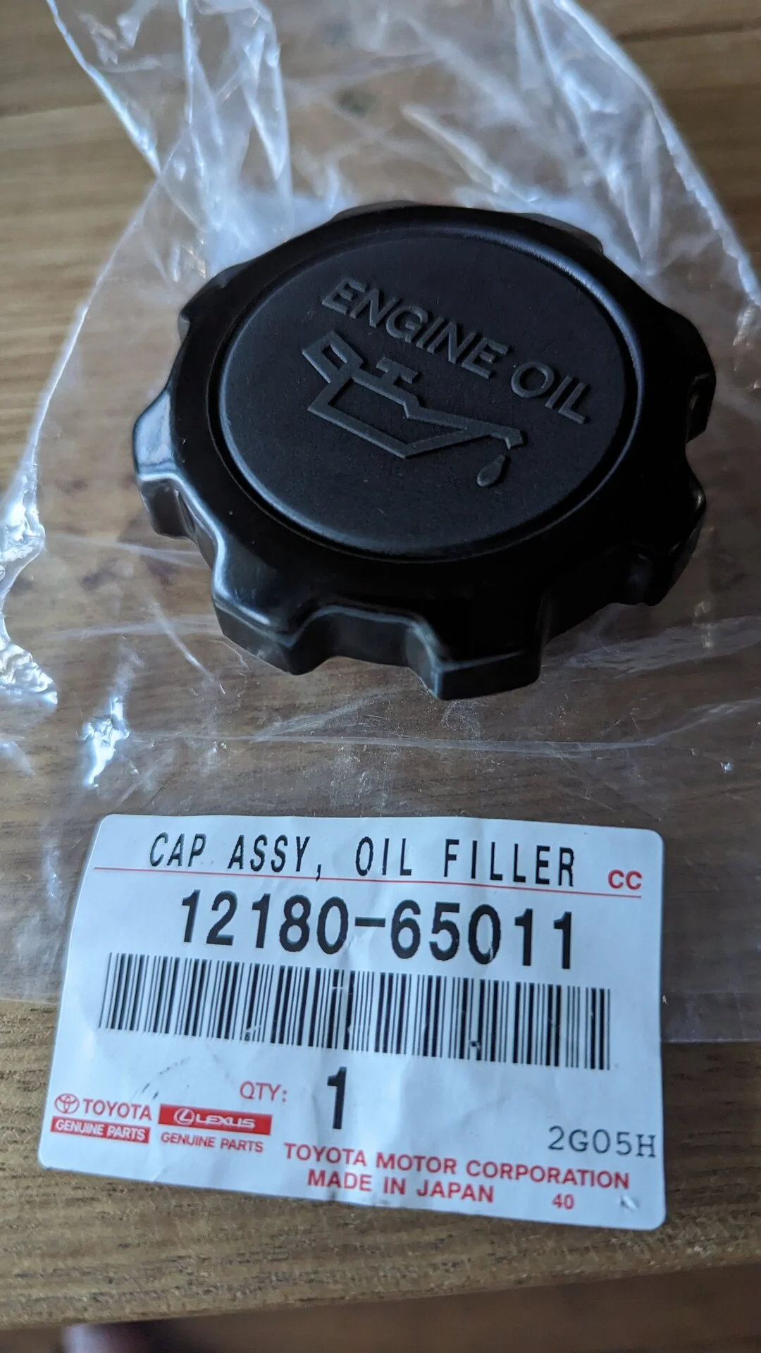

710 cap 12170-65011. The rubber seal on the original for this engine was rock hard

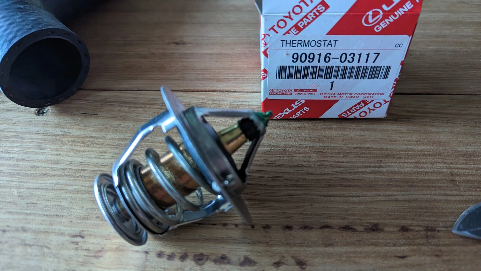

Thermostat 90916-03117

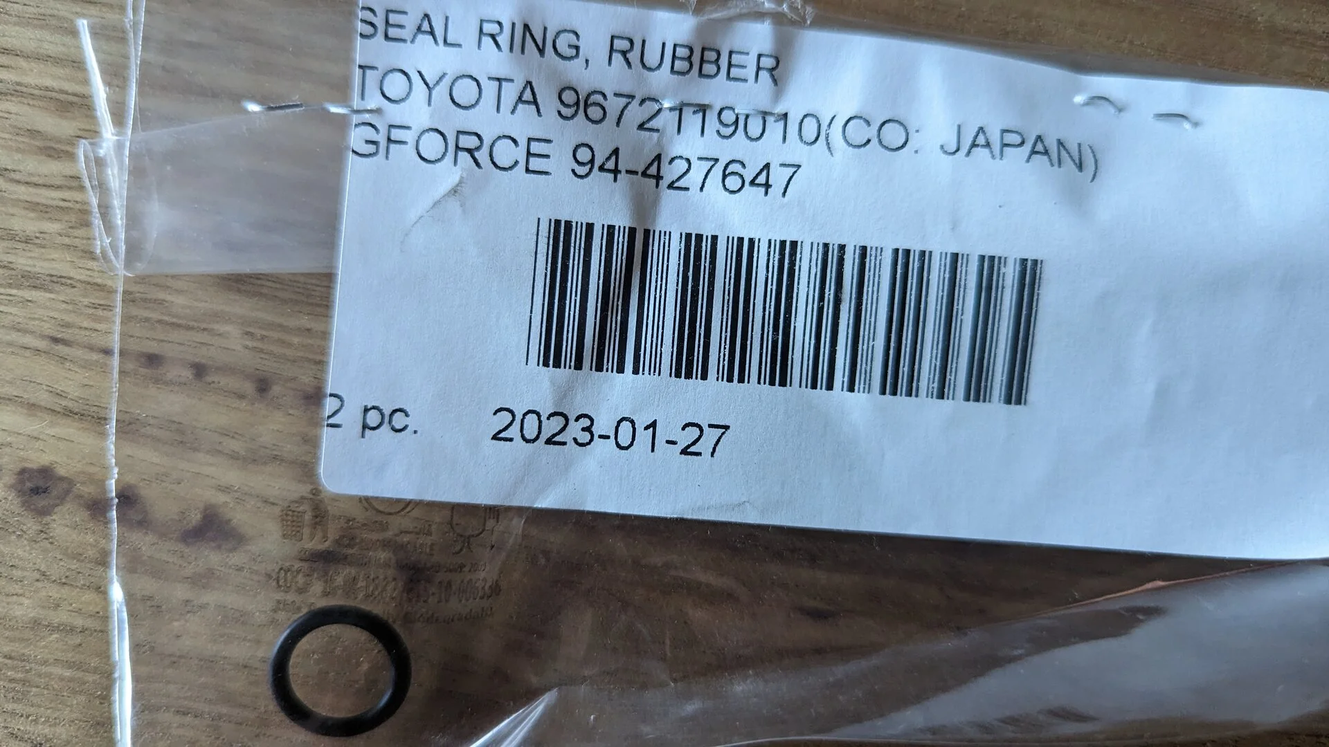

O-ring for dipstick tube 95721-19010

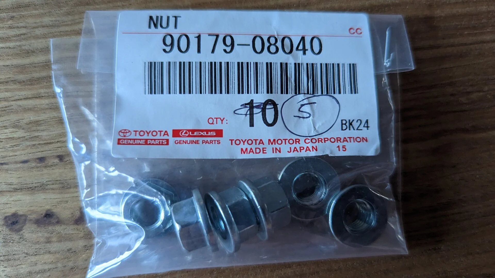

Standard part. Nut for intake manifold studs, and other bits and pieces around the engine 90179-08040

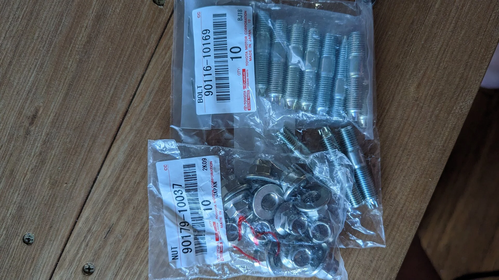

Exhaust manifold studs 90116-10169 and nuts 90179-10037
