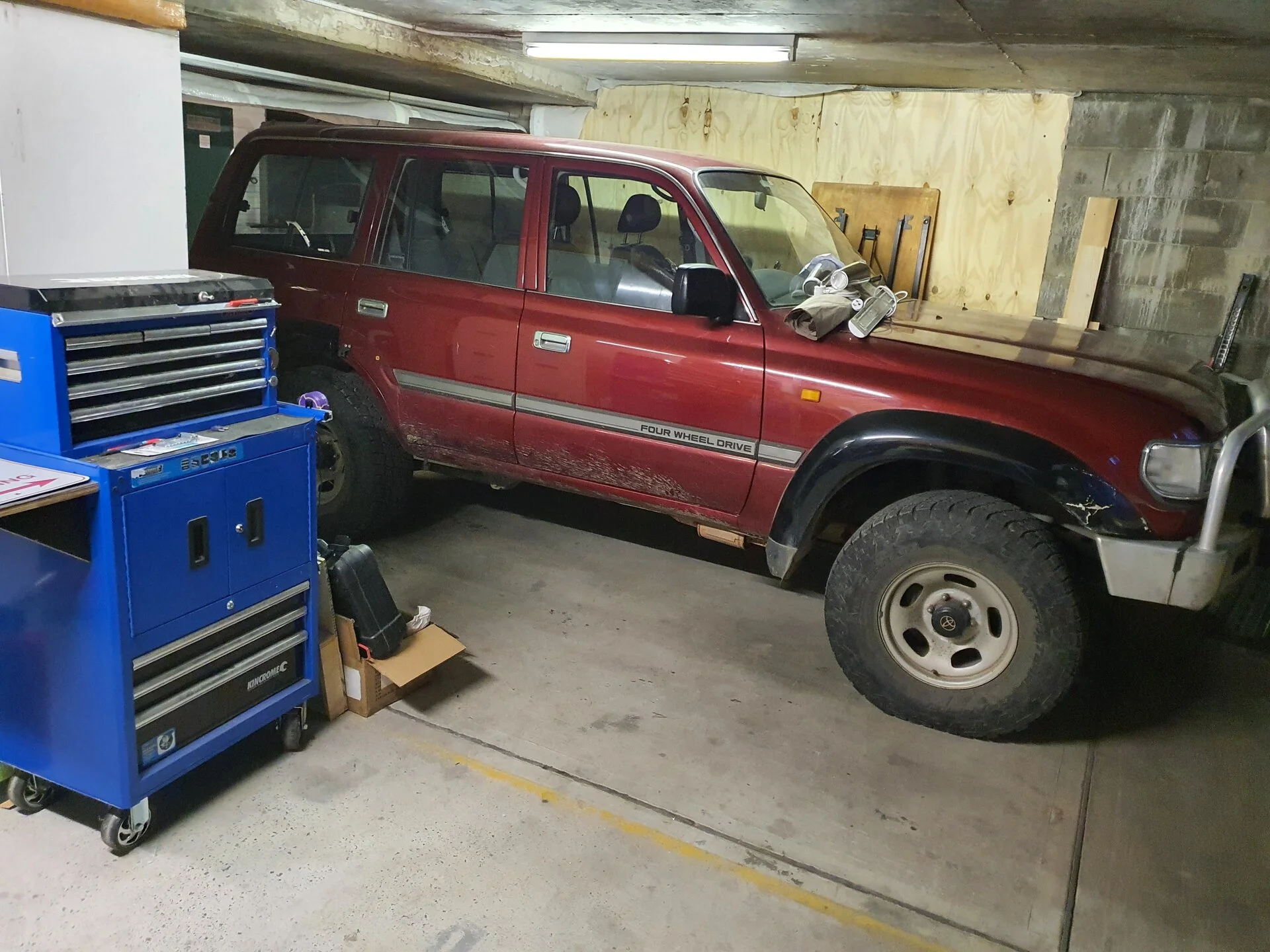

'93 1fz-fe engine knock. Main bearings = toast = cracked crank
Definitely take the hood off. Take the radiator out.
It's definitely easier with the hood off. I had no-one to help me take it off, and I had the crane set up before I thought about taking it off. I've lifted it off and on by myself in the past, but the crane was in the way.
Zero lift. OG springs, so probably negative lift. 33" tyres, not aired down.

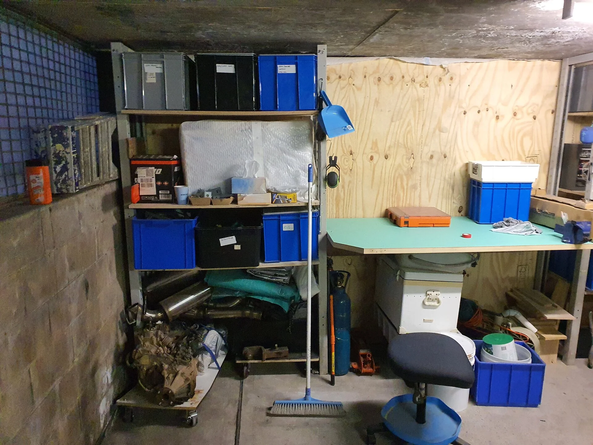

Garage looks like a crime scene because the concrete roof leaks like a sieve. I live in an apartment block. The landlord has refused to do anything to fix it, so I haven't been able to use my garage. 90% of the stuff I normally have in a garage is in a storage facility.
Truck is red, coz red (maroon) is the best colour!!
Before garage decided to be a subterranean water feature

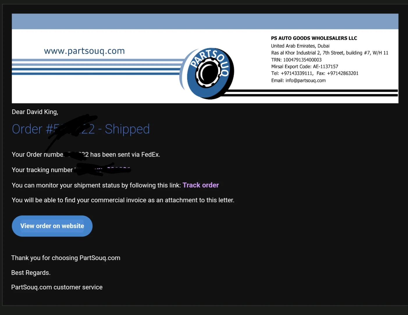

Ooof! Just got a call from the freight company. Because my order is over $1000 in goods value, I'll cop GST (10% Tax) on all of it, and customs duties on some of it!
Still, I told the guy it's cheaper than paying the Toyota tax at the dealership. The guy laughed and gave me the run down on how to avoid duties etc as much as possible for future orders.
Care to share his words of wisdom?
Basically, keep orders below AUD$1000.
Big orders, break them down into smaller orders spaced a few days or a week apart.
Some parts for vehicles over 30 years old don't get customs duty.
Duty is different for petrol vs diesel engine parts. If an order is above $1000, say it's for a 30+ year old petrol vehicle.
Basically, stay under $1000
