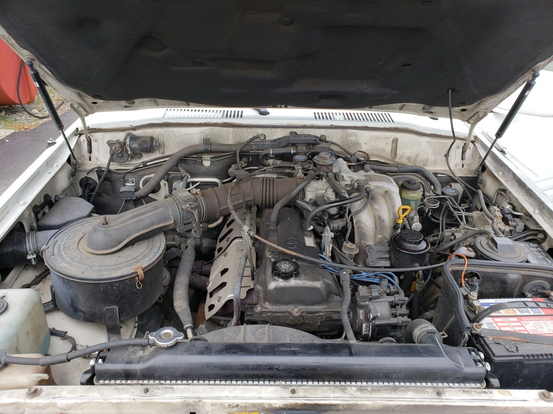

questions everyone asks... they want to see the engine bay pictures and want to know if the headgasket has been done..
also picture of the coolant would be helpful.
they will also ask if it is a k294 or k292 on the vin sticker on the driverside door (locker or no lockers) if that even matters to you. at that price you can add them later if you even want them.

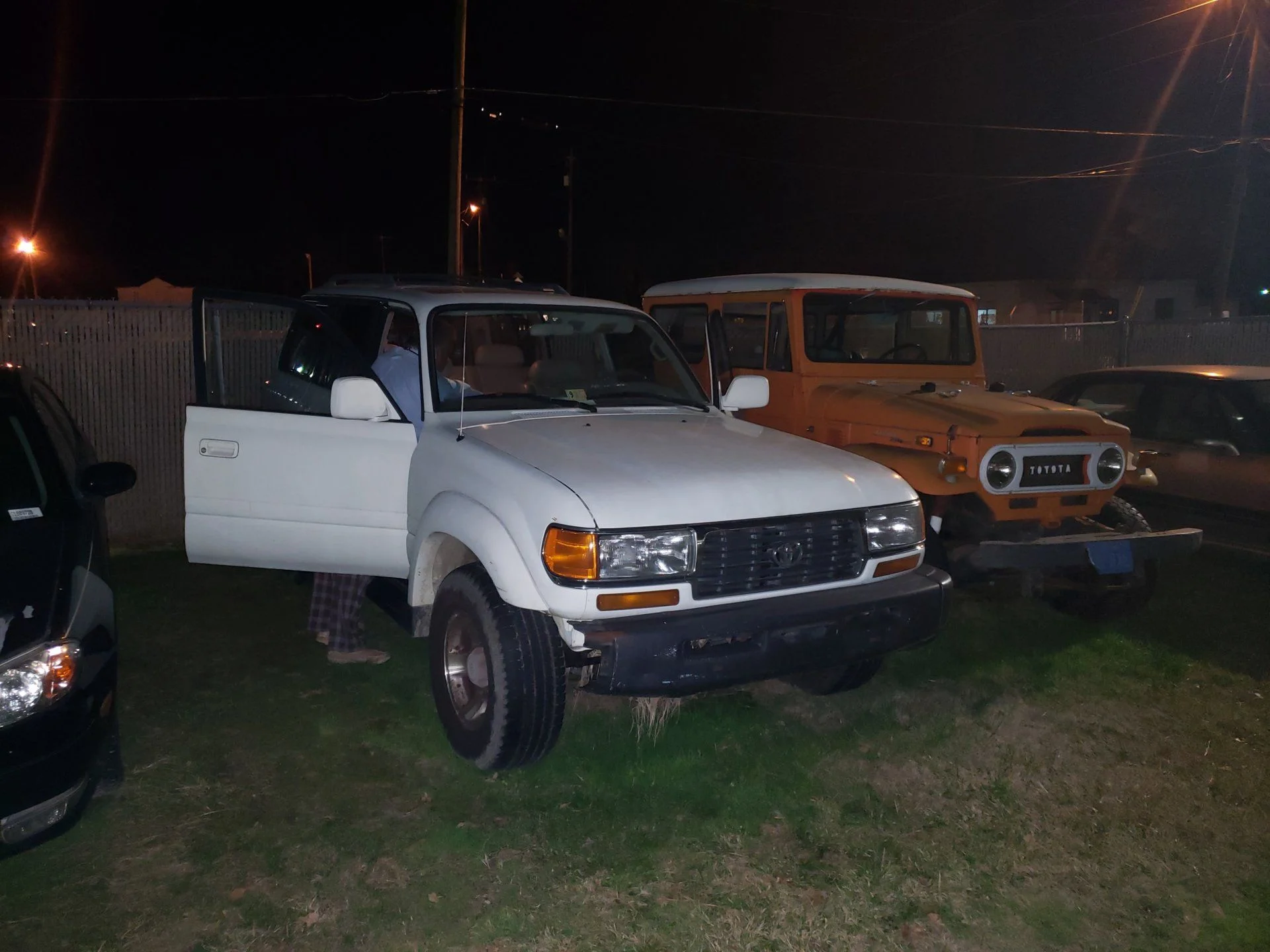

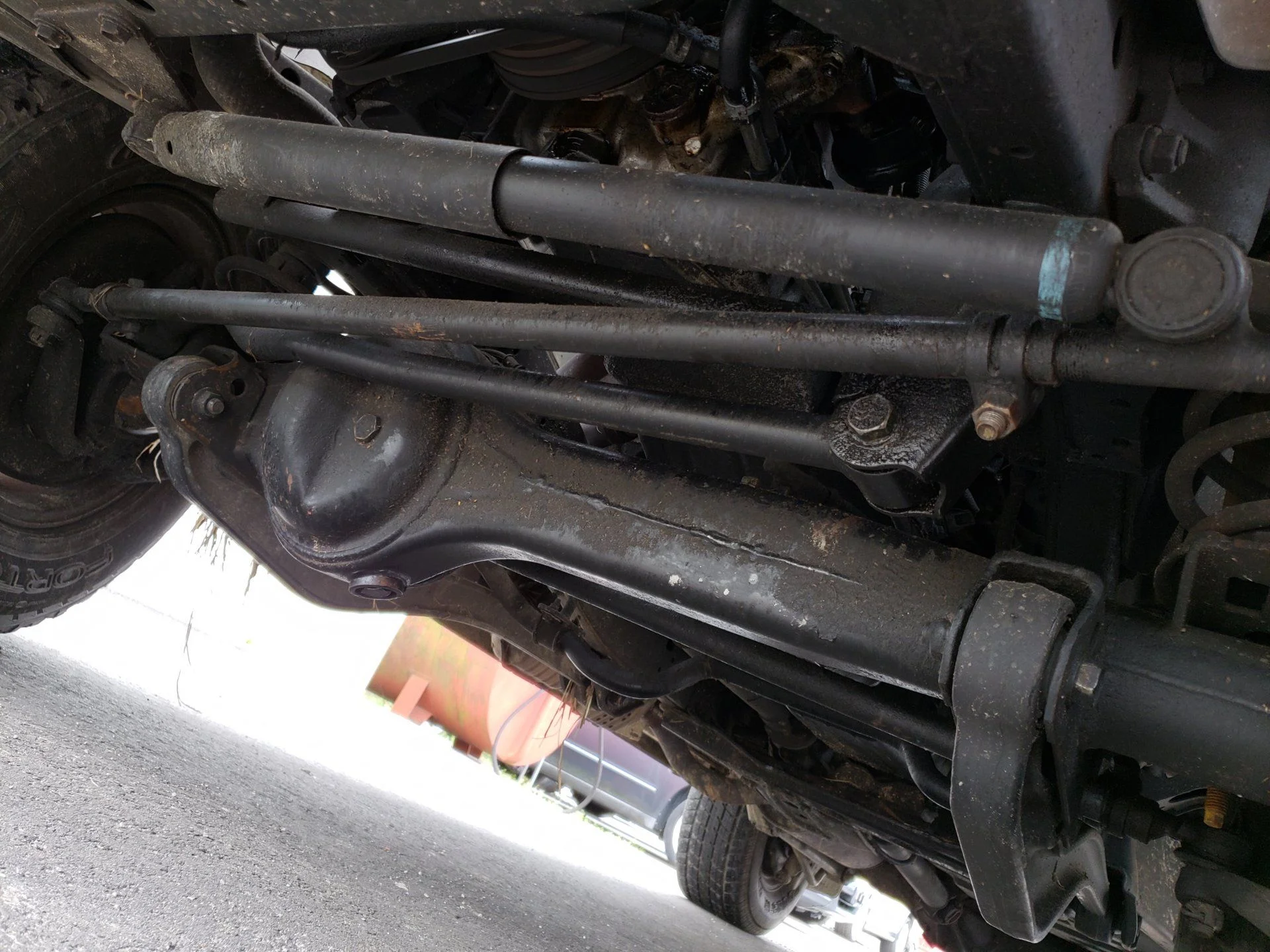

look at the oil and smell the transmission fluid for a burnt smell. grab a picture of the underneath for each front wheel area so people can see how well the gaskets are for the birfs and if that suggests neglect or a serious problem. ..... however that orange one next to it makes me think the person probably knows a thing or two about cruisers and you might be getting one in good shape.
is the orange one for sale?
Ask him if he will sell me the 40 series right next to it.
The Orange one is his son's project it came to NC from California and is a 1970 FJ40 and is all original except for a roll bar some old chrome wheels and the faded orange paint. It was originally grey. He said that he would probably let it go for $15K LOL It would make one heck of a project though.
I checked the coolant and it looked good except for being the wrong color (Green) the oil looked good and no white stuff under the oil cap.
The power steering fluid was the proper red color and the transmission fluid looked ok and didnt smell funny. The Engine starts good and didnt make any loud noises. I left a message for the mechanic who maintained this vehicle for him but have not heard back yet. I will get more pics when I go back on Sat. Thanks for the help...

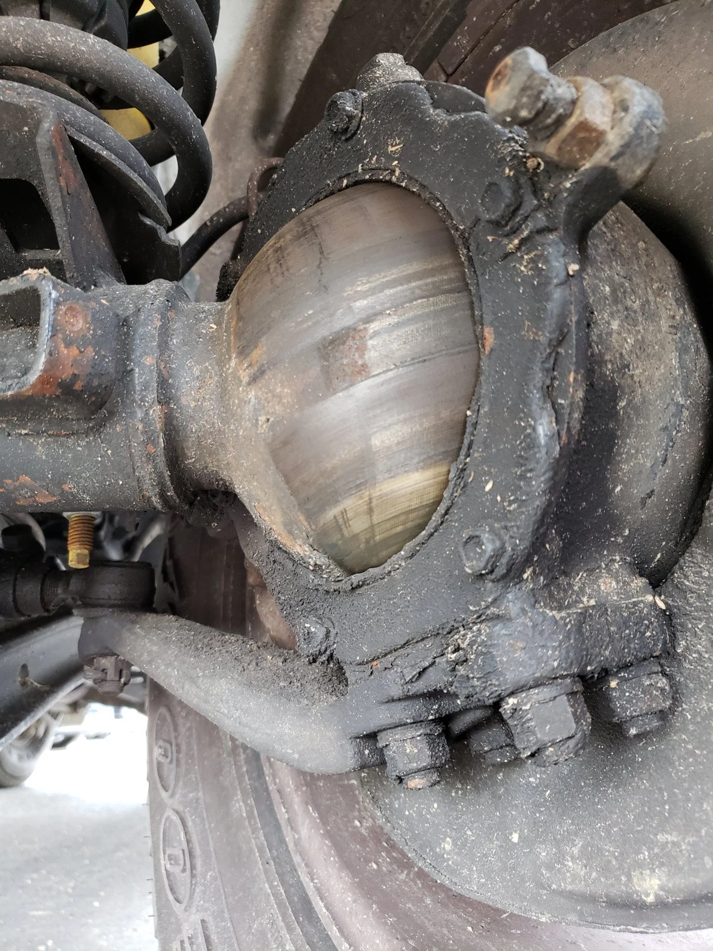

Looks like mud and grass crammed behind the passenger side of the front bumper, does it have any signs of water damage. And the wheel on that side looks like it has grease/gear oil on the outside of it. How do the knuckles look?
X2 on the question of water damage. That grass hanging there looks like it might have been in water for a little while . But can't understand why a seller wouldn't clean that out of there?
And in the picture the hood looks a slightly different color and doesn't appear to line up correctly.
He said I could have it for $15K its a 1970 model
just in case you buy it: the windshield bumpers on the hood are mounted in the wrong direction
I asked him about that grass and he said its where his son took it through the field behind his place? It was just some loose grass but it did have some mud on the frame but it has been very wet and muddy here this year. I will look closer at everything in the daylight on Saturday but I didnt see any obvious water damage. The hood looks funny because it was not latched all the way FYI thanks everyone for the input
