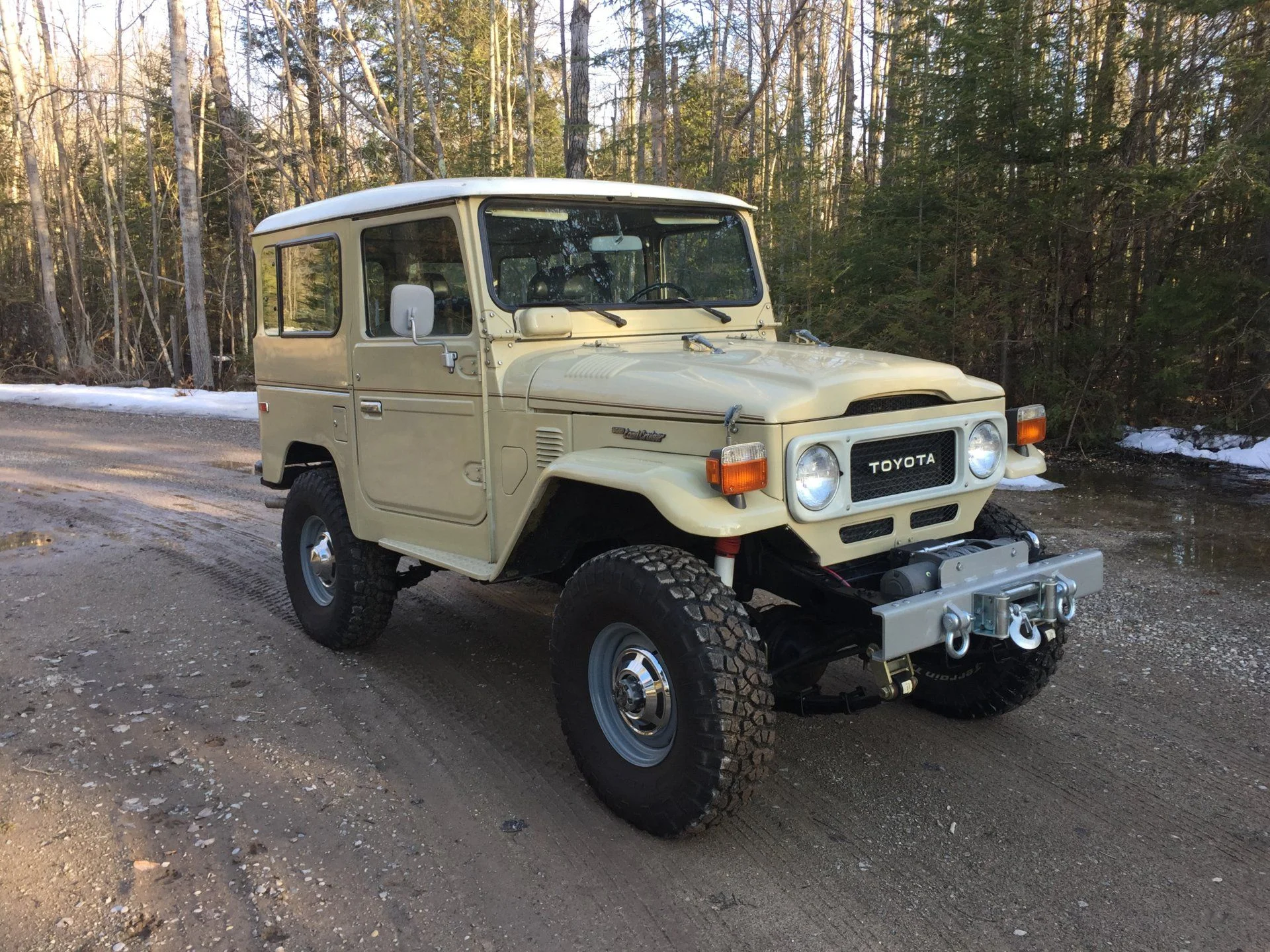

Thanks, everyone for your responses and suggestions. Much appreciated. Here's some follow-up, additional info, and a couple of photos:
Yes, it cranks fine, I smell gas while cranking, it just takes forever to actually start sometimes.
Air filter is clean.
Wire connections for the starter, coil, and battery are good.
~66K miles, but really more as the speedometer wasn't re-calibrated after a lift and bigger tires were installed.
No remote starter switch.
I do not know if the carburetor and distributor are original, but I would guess they are.
Plugs were dirty (I've seen a lot worse), so I changed 5 of them (all I had on hand). No change with the new plugs before it started as above.
Good info re the starting procedure. I have tried everything from few to many pumps on the pedal before and during starting, but haven't been holding the pedal down as long as it said in your post, FJ50Jim. After it not starting all morning as well, I went out and tried pressing the pedal more slowly, and it started on the first try. Hopefully that's the answer.
If anyone has any other ideas, let me know. I'll post back after it has not been run for a little while and I try the starting procedure JF40Jim posted again.
Thanks again, guys.
