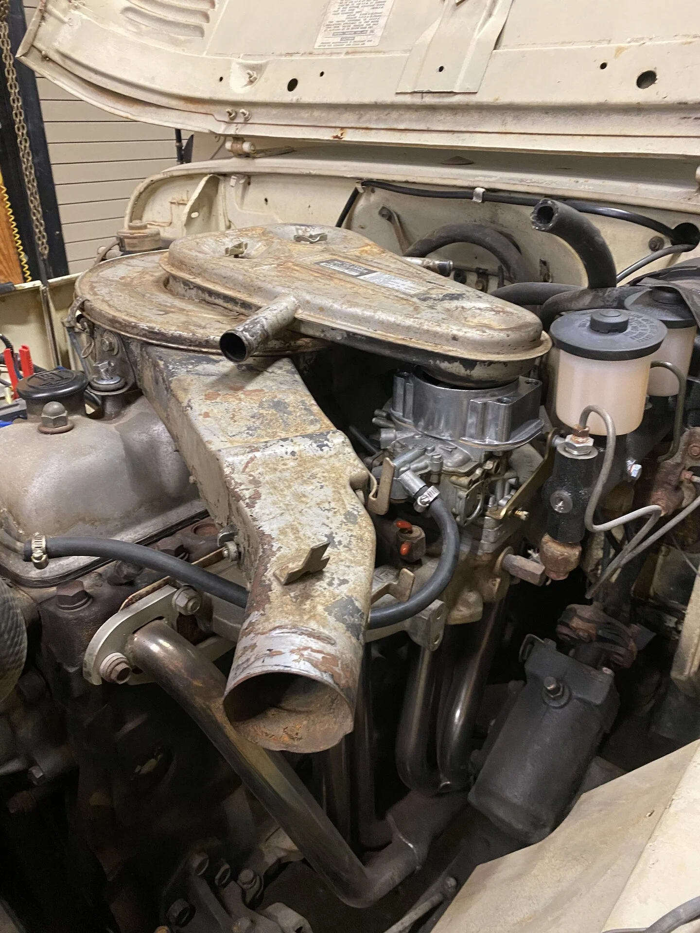

Here is my issue. It has the stock F2, with a Weber carb on it. I added the Man a Fre adapter so I can run a stock air cleaner. Once it starts, it runs great! Problem is it takes multiple attempts to start cold. Warm boom! Cranks great! A spray of carb cleaner starts great. My question is should I replace the mech pump with a Carter 4 psi electric pump? Oh, problem was there before I added the man a fre adapter, so we can rule that out.

I'm sure that you will get a multitude of opinions... Just my 2 cents: You may want to consider going back to a stock setup. You could acquire a used Aisin carb and a rebuild kit; or some folks have had good luck with the knock offs. I would stick with the mechanical fuel pump. Post up some pictures of your rig,.
First pic is before the adapter. I plan on dumping the bumpers and top(spare is already long gone). It’s un molested rust free, although the prior owner did repaint it….with a paint brush. I have a set of FJ Corp wheels and KM3 255 85r 16’s that will be on it by weekend. Pretty sure I’m going to stick with the Weber, I’ve used them on many of the J**ps I have owned.
