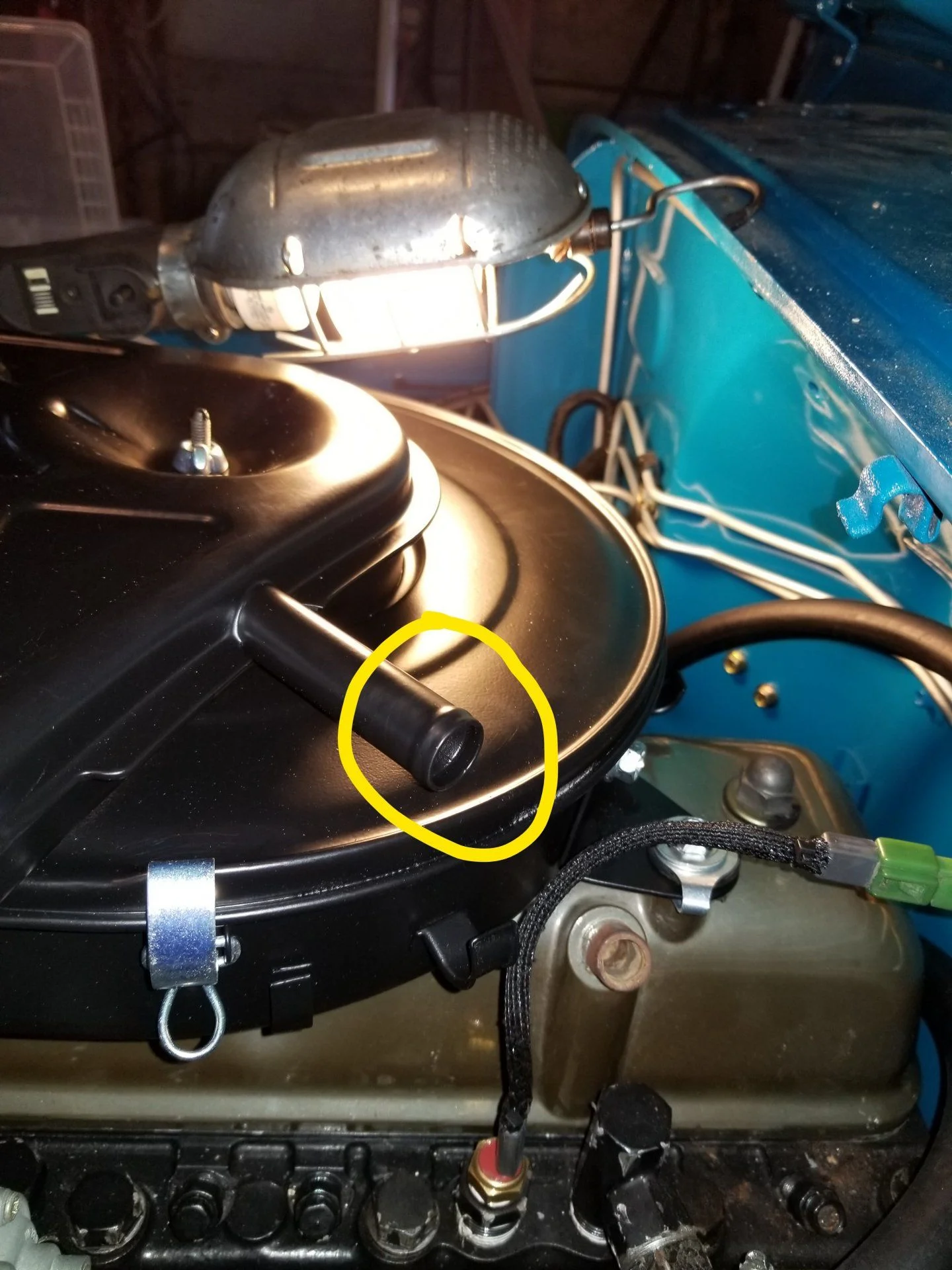

any ideas for a plug?

how about just hooking that up to the valve cover, like it should be, there should be a hose going from the valve cover to the air cleaner. the barb on the valve cover is right below it

i do have one connection to the valve cover. thoughts?
I found something at HD for that plug, echo that my connection to the valve cover is located towards the firewall side of the air cleaner. Sorry, don’t have a pic.

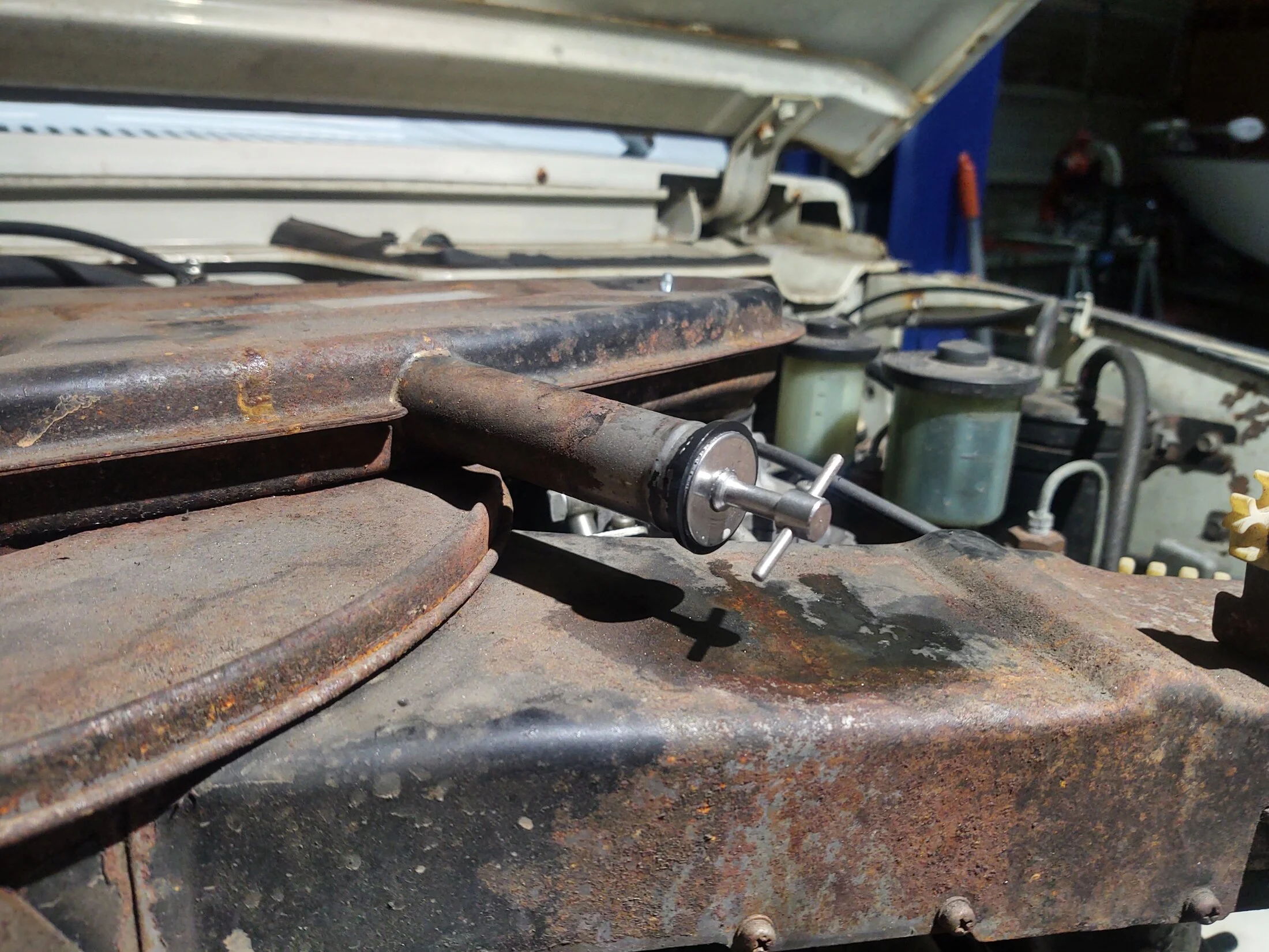

The stub is actually the emissions air pump intake...they started showing up on air cleaners about 68 or so. I plugged mine with a tubing cap....not even sure where I found it....but it fits LOL.

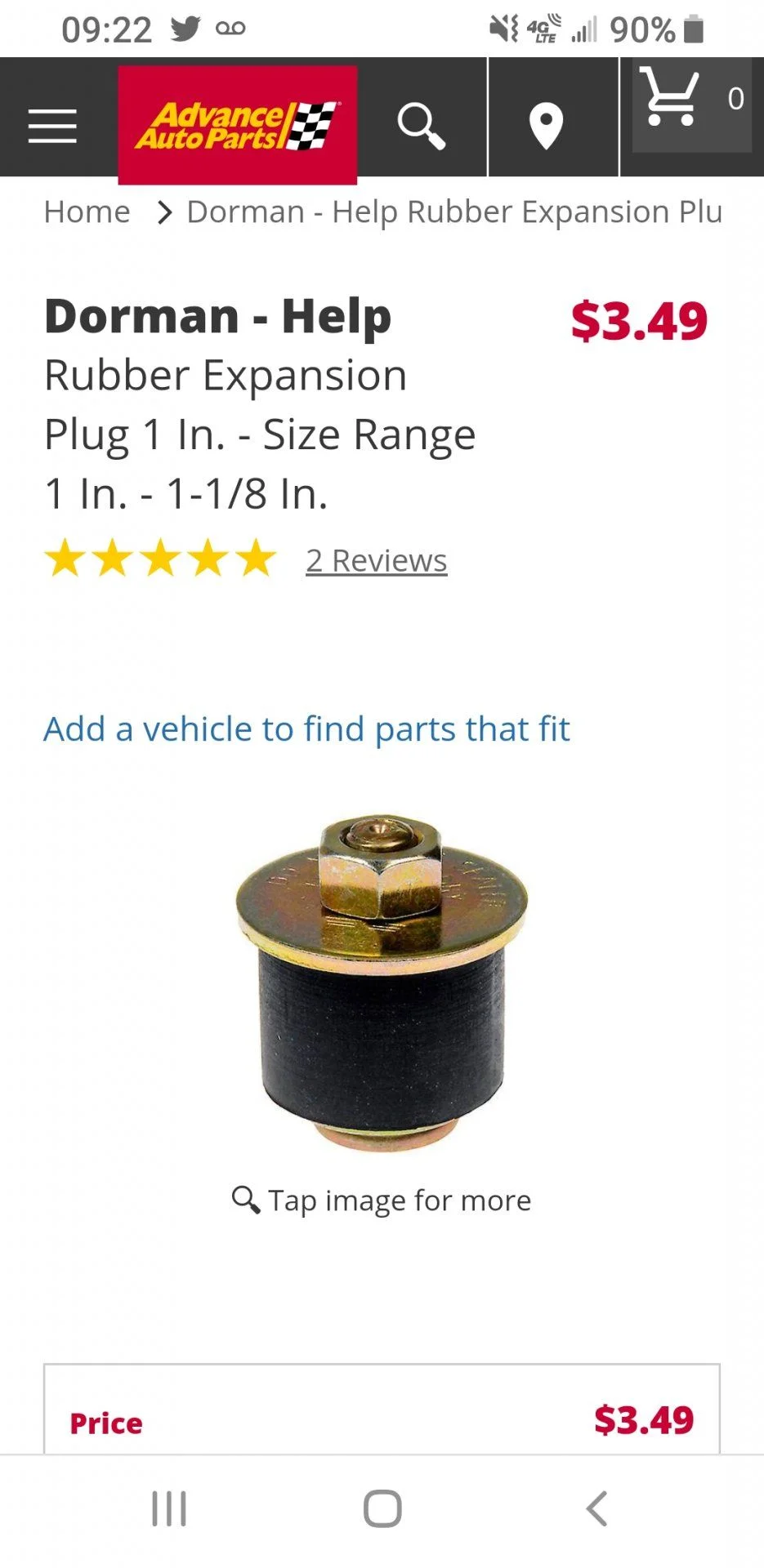

Have used these. Come in various sizes. I got mine from PepBoys but they are available at other places also.
Probably over kill for that spot but will last forever..
Here’s a photo of mine- not sure if I got it from Jim C or picked it up at Ace
