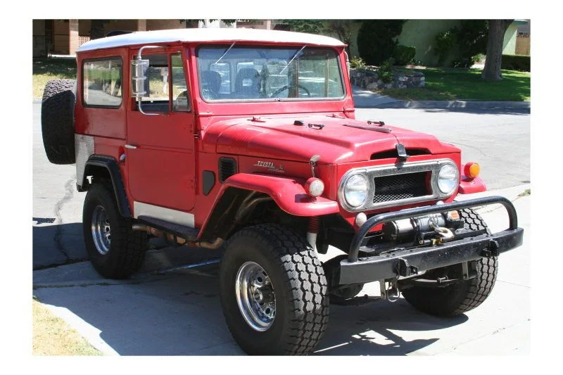

BTW, nice paint job and nice cruiser!:cheers:
thanks spdwaver1 - BTW if you have a picture of the damage I may be able to better help out. I did a LOT of body work on my cruiser.
Thanks, I can get a shot of it later and post it up (this way everyone can see what I am talking about).:cheers:

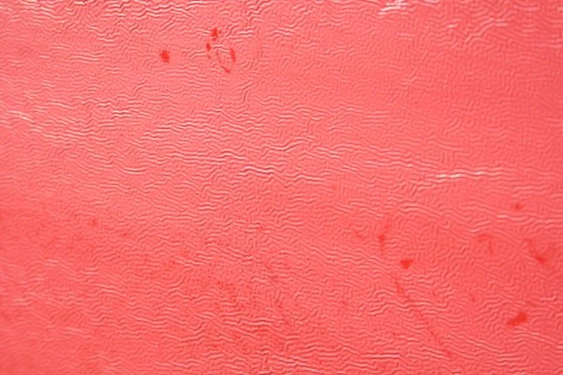

Off the subject, here is a nice picture of thick paint:
