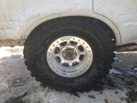

37" tires
Delancy what are your specs? as far as suspension is concerned? wheel spacers? what lift springs? any body trimmings? etc....
That's KR's (search " akrilo ") PP 80.
Think he's J's with 1" wheel spacers.
Keep in mind that standard sized KM2s are notoriously small. Run 35x12.5x17s on another rig and they were around 33.5" new.
Not sure what akrilo's measure, but probably less than 37".
The 345 KM2s are a very wide 35-36" tire on the OE rims.
They almost look like balloons, not that it matters.
Another respondent stated more runner = better ride, but don't know that there's anymore than butt dyno to validate, and mine can't tell the difference.
Only reason I swapped was NOT benefitting from lower air pressures on a trip through slick rock in Clayton. At 10 psi they wouldn't grab anything, but wet rock.
The Krawlers, on the other hand, can run at 6 psi and stick like gecko paws....and I don't rub at all.

Yup. That's my rig. Figured I would post a feeler ad on clist. If they sell for the $2500, good. If not I will just keep them on there. Figured I would buy 5@ 345/75/16 KM2's for my oem rims if they sell. A little more road friendly. BUT the beadlock 37's sure look beefy on the 80.
For reference. The 37" Krawlers measure 36" tall mounted on the 17x9" wheel.
Yup. That's my rig. Figured I would post a feeler ad on clist. If they sell for the $2500, good. If not I will just keep them on there. Figured I would buy 5@ 345/75/16 KM2's for my oem rims if they sell. A little more road friendly. BUT the beadlock 37's sure look beefy on the 80. For reference. The 37" Krawlers measure 36" tall mounted on the 17x9" wheel.
