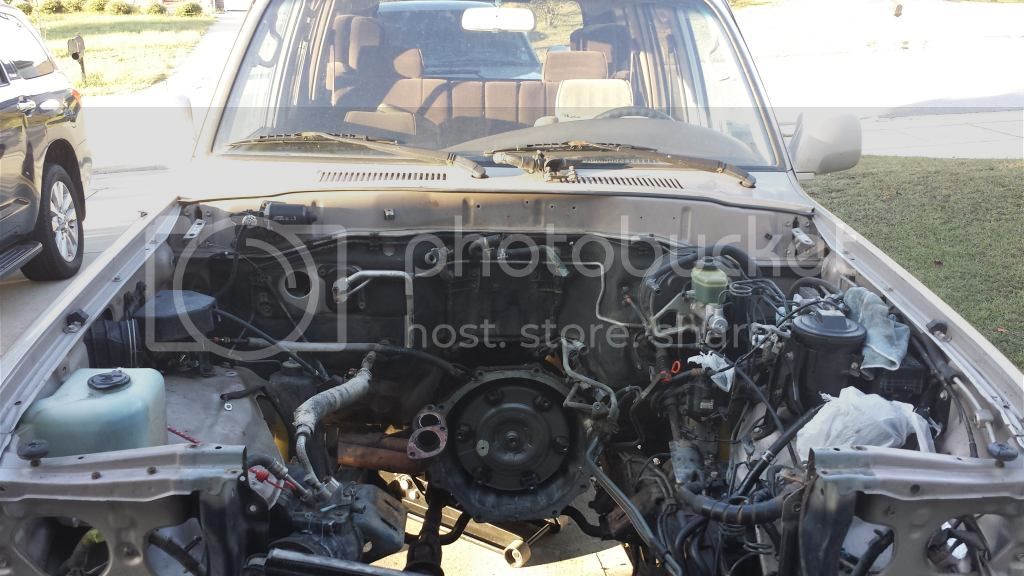

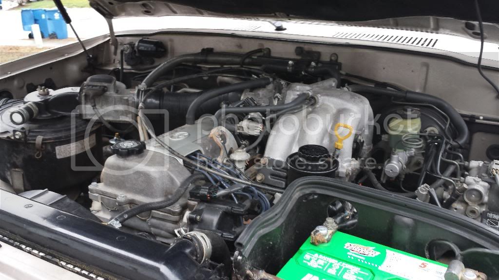

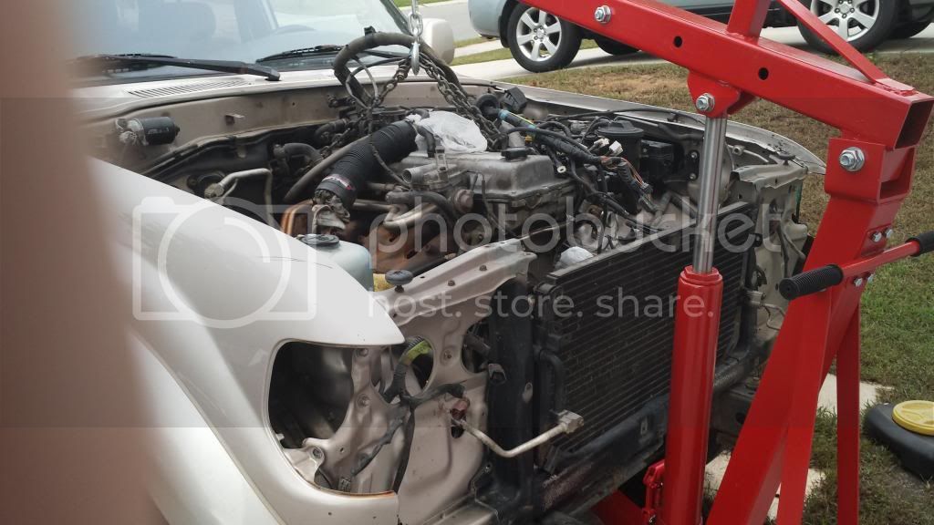

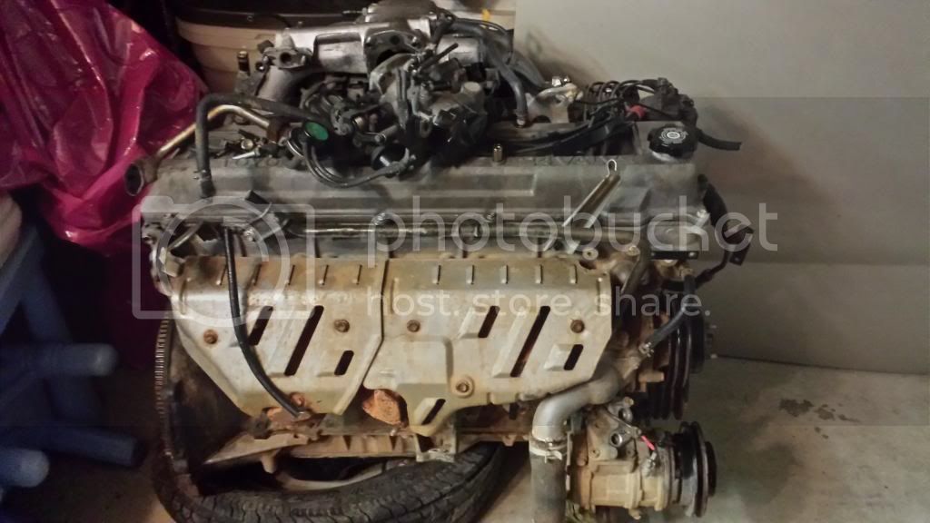

Next up I found a motor here on Mud for $1,500 but when I looked into who had the motor it was an old buddy of mine and I pick it up the next day after getting my 80 and paid $900 for it.
Now my truck is a 94 and the engine is a 97.
After lots of research, I swapped just the motor and kept the original wiring harness.
I deleted the EGR and some other stuff to clean up the engine compartment.

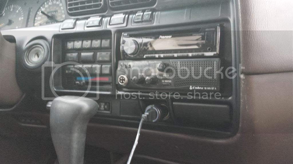

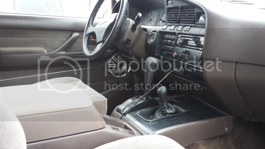

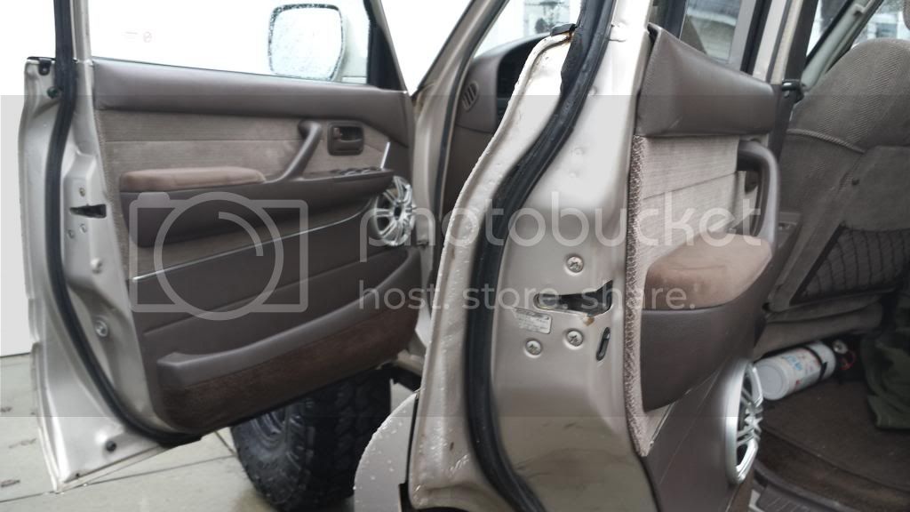

Next on my list were the Stereo and the crappy speakers
I chose a Pioneer DEH-6600BS… http://www.pioneerelectronics.com/PUSA/Car/CD-Receivers/DEH-X6600BS due to the Bluetooth and 3 RCA outputs
I also chose Polk Audio db651… http://www.polkaudio.com/products/db651 due to others here and they Marine rating (will paint grills to match interior)
All purchased from Amazon for just over $200
I have also wired for 2 amps (going in the space where the factory sub was) and a JL 12” sub that I had sitting around for years but have not installed any of it yet.
I had a Cobra 18 WX ST II from an old rig and this has been wired up to a 2’ Firestik 2 and placed below the stereo

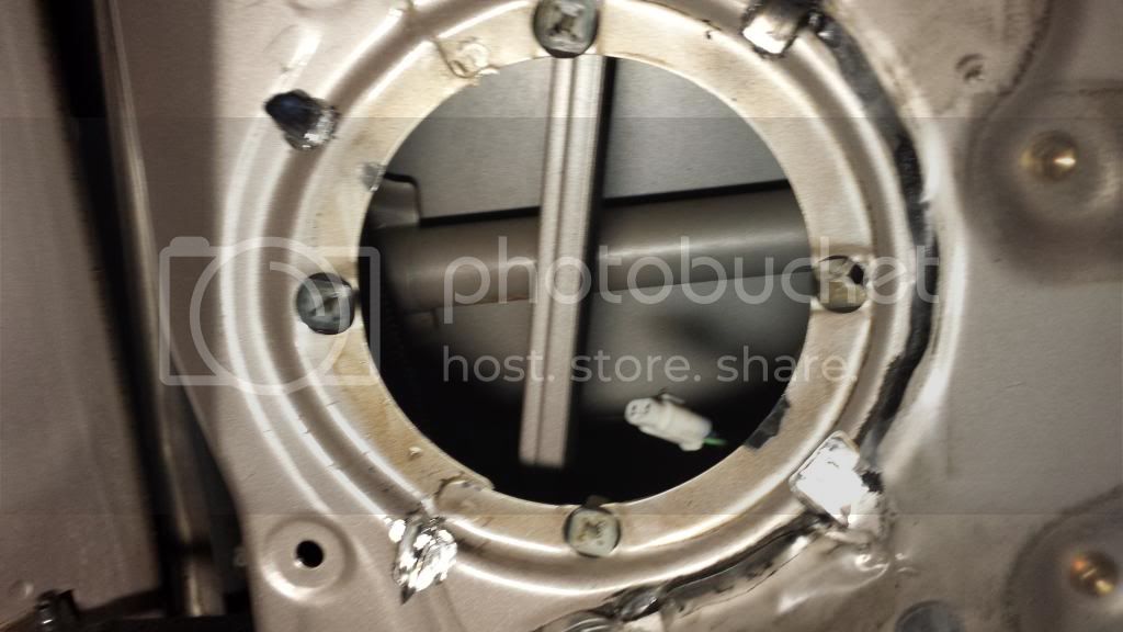

My install I did use the spacers in between the door frame and panel
For the front doors, I notched where the “wings” of the spacers were so they would fit more flush.
In the rear doors, I used the tin snip method to widen the openings.

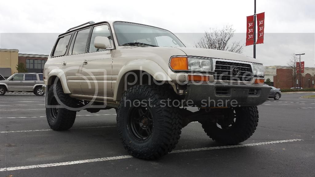

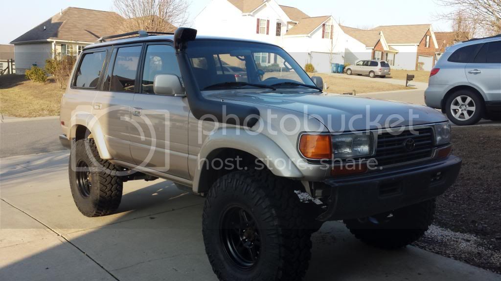

Wheels and tires were next…
After looking at lots of pics here and getting approval from the wife, I ordered some Level 8 Strike Wheels in 17x9… thanks jcardona1 for the wheel specs because according to Discount Tire these will not fit the 80. Found them on ebay for $452 shipped from Discount Tire and the local store matched the price.
For tires I decided on Nitto Trail Grappler MT in 37x12.50
Discount Tire also matched a local Craigslist add for $1,440
After mount and balance, tax and new locking lug nuts, I am in these for just over $2,100

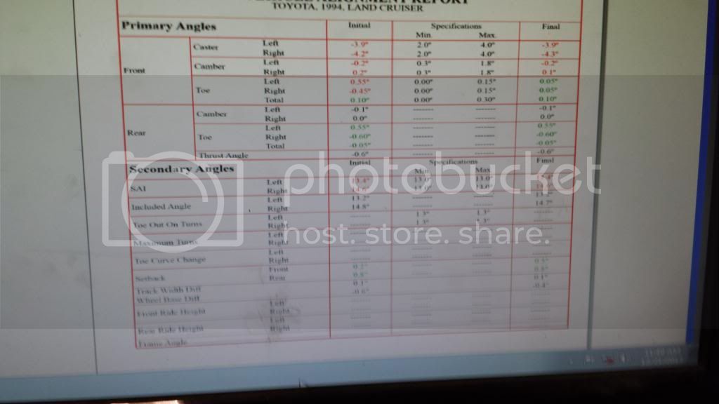

I went to get an alignment directly after getting the tires installed and they royally f’d it up at Tire Kingdom… I spent 3 hours there and they couldn’t get my steering wheel straight.
Told me it was due to a faulty return to center switch and I had to get that fixed before they could fix it…. What a load of crap…. They did refund my money though so I’m happy to fix my wheel myself.
Probably with whole new draglink setup.
They did fix my toe and gave me a spec on my Caster -3.9 & -4.3 as I have not installed my MetalTech plates yet… if the rain stops I will have those in today… just hope it is enough without extra weight of bumper and winch.

Best year, color, and interior combo. Ask me how I know. Mine wasn't locked, but got e-locked axles from a 96 LX swapped in. Nice job on saving what looks to be a great cruiser!
has it been wrecked? I ask because the grille is the wrong type, hats are 95-97. or maybe the PO swapped out the front end parts. Either way, congrats, you're doing a great job so far.
What back spacing on the wheels and what bump stops? Or when you get to that point
I do have the stock "Toyota" grill and a LX grill... hasn't been wrecked PO just swapped.
I think the BS on the wheels is 4.5".... bump stops are on the list.. so is rear sway bar spacers that I will make out of 2x2 stock.... front swaybar has been removed
80 looks great. I am jealous of the wheel/tire combo.
I see sliders and bumpers in your near future by the way you are going..hahaha
Nice looking rig
Great job, can't wait to see what's next!!

I ordered a Trail Gear HD steering setup and installed the drag link and straightened out my steering wheel.
I also couldn't resist the $110 shipped snorkel on Amazon, ordered it up and installed yesterday.
