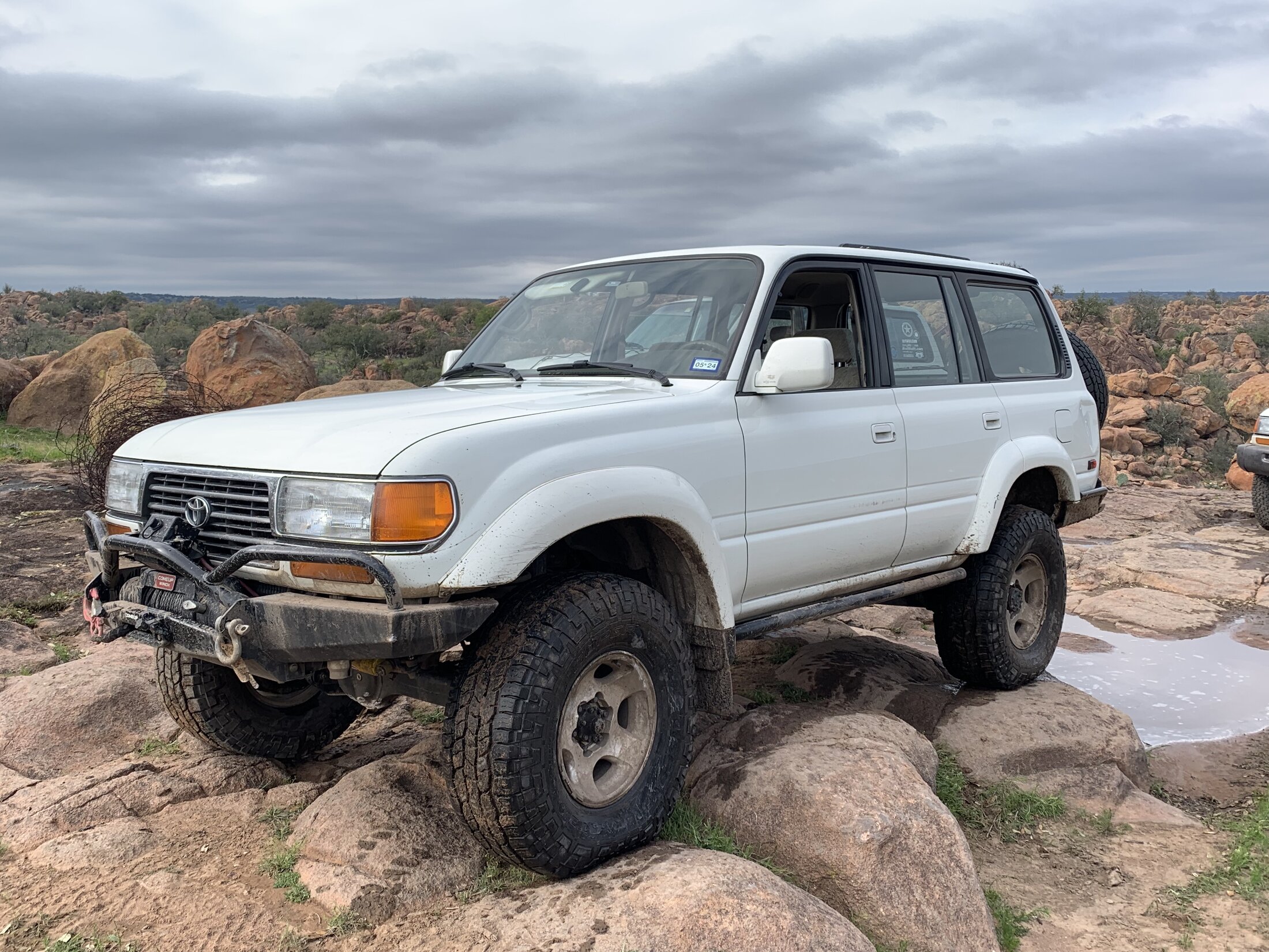

Current set up:
Dobinson's 3.5" VT springs
MRA Shocks
Delta VS Sway Bar Drop Kits
Delta VS Panhard Drop
Iron man control arm drop bracket
Icon 17" Rebound Pro Wheels
Spidertrax 1.5" Spacer
Longer Toyota brake lines
Yokohama Geolander G003 37x12.5R17
No rubbing at all with daily driving. 3.5 VT springs are a bit firmer but it still rides really nice. I suspect once the snow melts and I can get it out on some trails I'll be needing to trim some of the flare inside the wheel well. We will see. These tires mounted with weight on them measure around 36.5.
