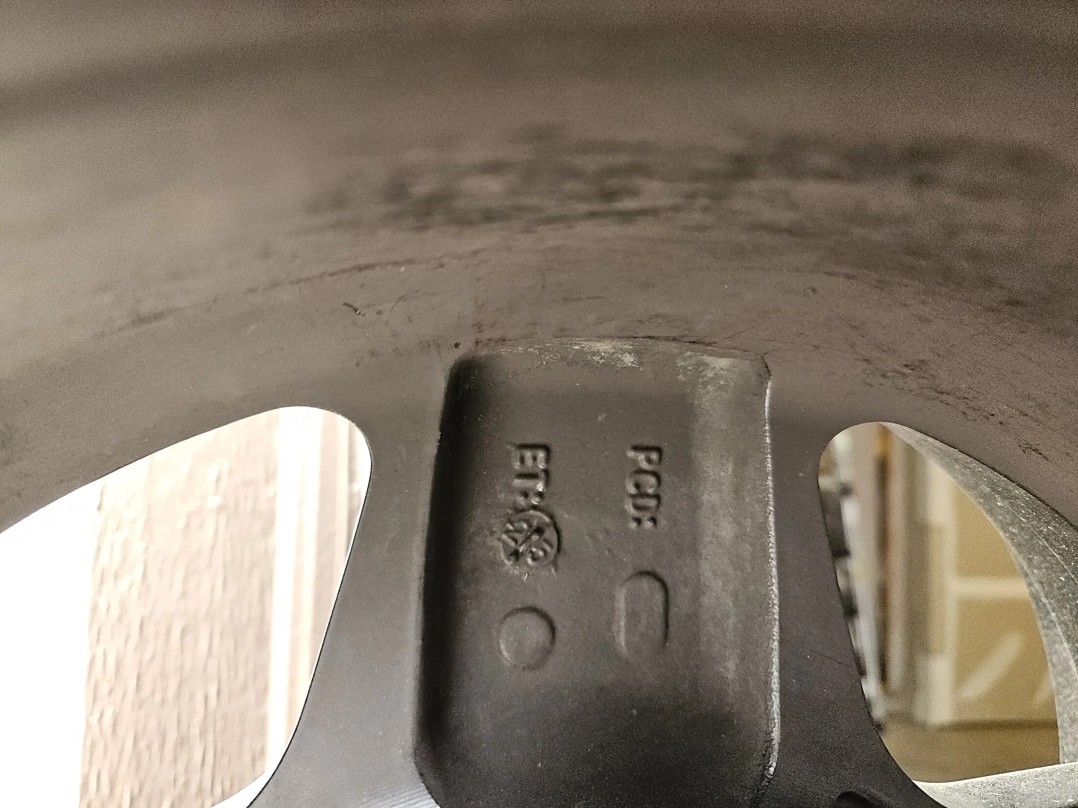

I'm 99% sure I just discovered that my wheels are 16X8et-25. This bodes well for being able to slap on 315s with no issues with frame contact, but I need to confirm that. I need better weather (or forklift).

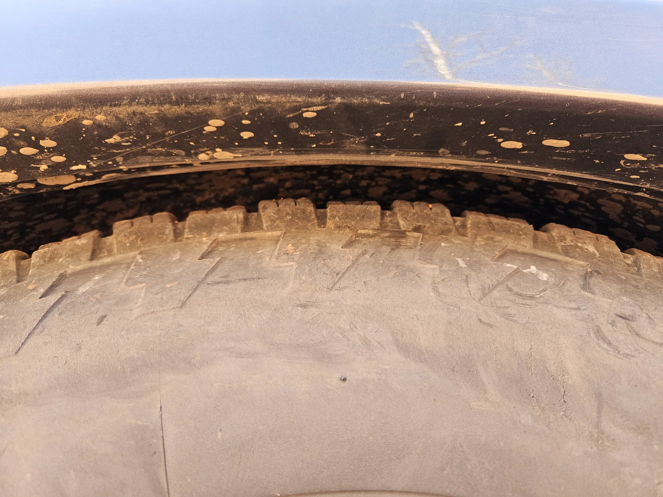

I went back and found these pictures, which are not conclusive, unfortunately, but help me somewhat. Somebody else showed up right after I started trying to get measurements (the nerve!), so I had to quit before I got any measurements or even a look at the bump stops.
^That's the LF. I was able to deduce, through measuring the real tire and then the picture, that that gap is 1 1/32". I was further able to determine, by comparing specs and measurements on the current tire and the target 315, that with 3/32" treadwear factored in, the new tire would fill 0.614" of that gap. I should be in good shape for this upgrade, assuming I'm on the bump stop (not a safe assumption).
I do intend, of course, to verify this with real measurements, but this bit of trail, the "Shakedown Moguls", is closed until May and the alternative moguls are covered in snow. I'm in no real hurry.
