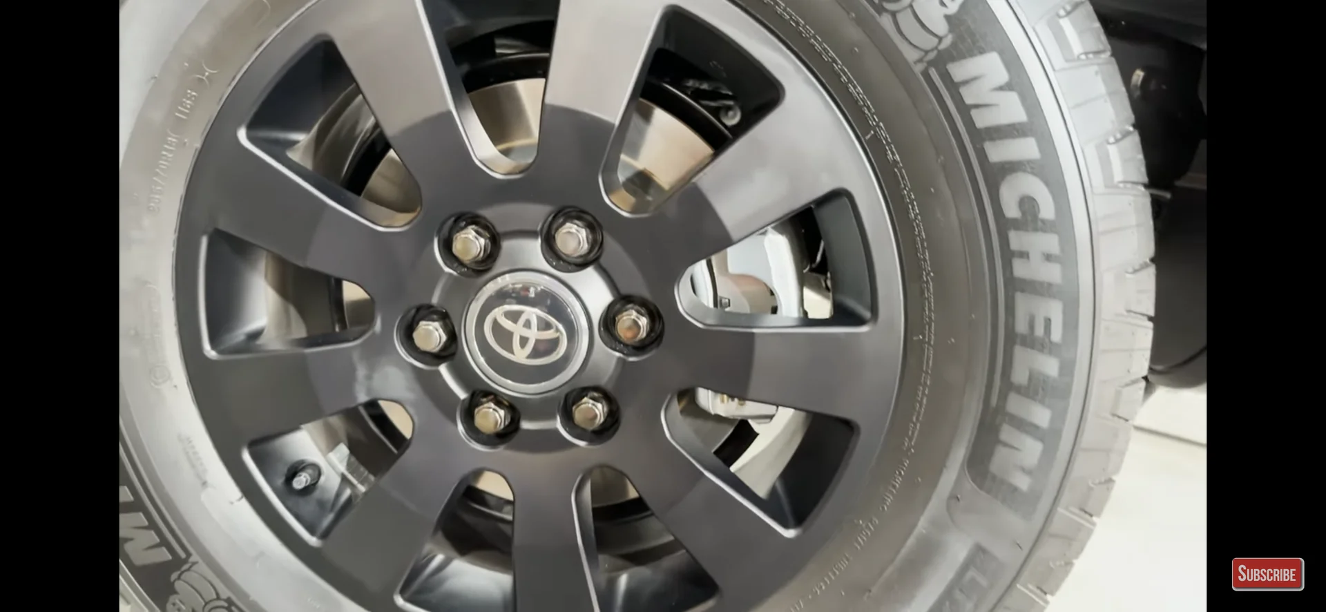

There are reports that 17" wheel might not fit due to bigger brakes.
This is a screen grab from ToyotaJeff’s (link below) reveal video. There appears to be plenty of space between the caliper and wheel on the stock 18’s. We won’t know for certain until Toyota or a buyer fits 17 inch wheels though. I’m really hoping we get some kind of announcement from Toyota soon. Like I said previously, these are all GA-F platform vehicles.
That looks like the rear caliper to me.

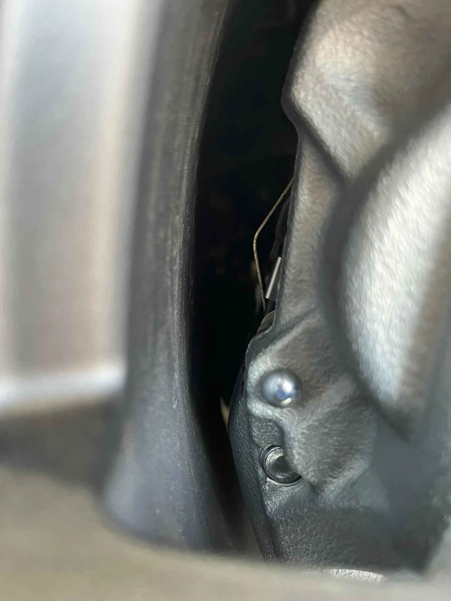

This is the new GX on 18s:
