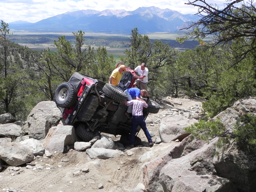

So I'll agree with you. For what are listed at Very Difficult or Extreme 4x4 trails in Colorado and Moab, you'd be better going with 35s.... but, these are the trails you want to do with small kids? First pic of Chinaman Gulch comes up with:
Thus it depends on what you want. Thus, I'll agree 35s are required for Very Difficult 4wd trails and 33's cannot do everything that 35's can do. I guess that I, personally am happy enough with Difficult 4wd trails, considering I have my wife, and 18 mo old, and a 4 yo in the car.
Thus, it's a matter of what you're gonna do with the rig. 35's for Very difficult or extreme rock crawling, but then you can't tow anything, worse MPG, less power... the list goes on.
Obvious newb move there. Yes, get the rug rats started as rock crawling copilots early on. You can do any trail in a stock 80 if you want to get right down to it but why would you? The vehicle damage and work involved would be no fun.
