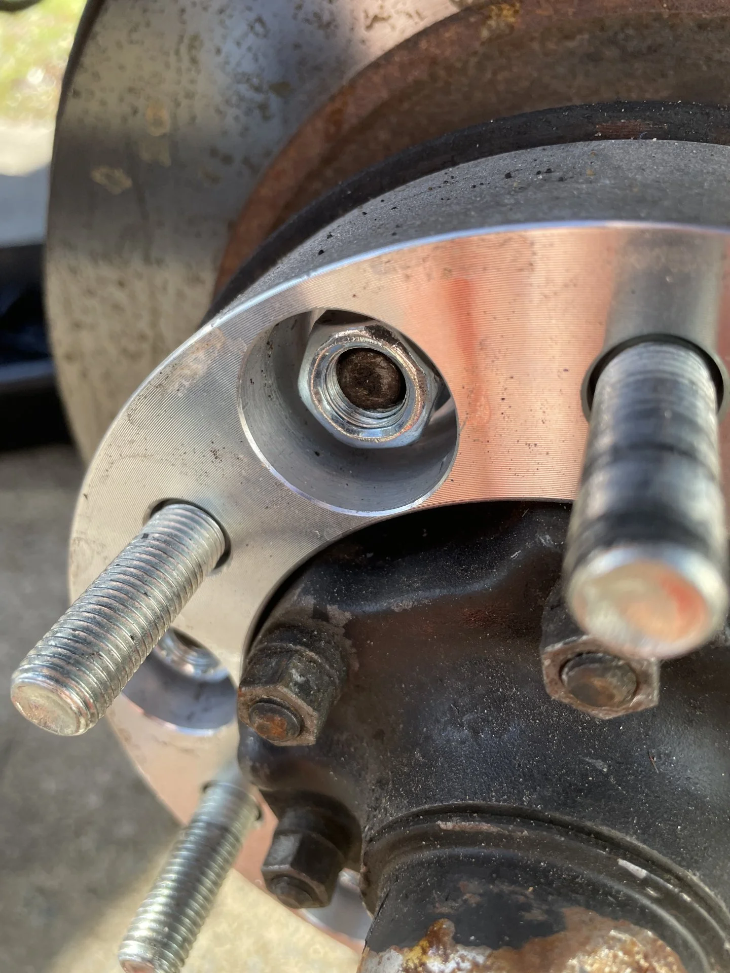

these:
however, this is how all of them were installed:

Yes, wheel spacers
It appears that the previous owner cut the wheel stud shorter ( sometimes necessary to install spacers ) but it looks like there cut to short.
I would definitely not run those with only half of the lug nut holding them on.
You may have the same issue with out the spacers.

I measured the studs last night 48.36mm on the rear, replacement studs appear to be 49.5mm long for the rear
I measured the studs last night 48.36mm on the rear, replacement studs appear to be 49mm long for the rear
I'm not sure how long the studs should be.
I would try to mount up a wheel with out the spacer, the lug nut need to be fully engaged.

Not the stud on the spacer. The stud that the spacer is bolted to. You don't even have the full engagement of the nut on them. That's frankly terrifying.
yeah, that measurement was the stud that is attached to the vehicle, not the stud on the spacer.
The spacers are getting removed until a better solution is found

Then you may need extended studs. I ran a 5mm spacer on my 2018 gt and even with those, and the wheels I'd run I needed extended studs to ensure proper lug nut engagement.
