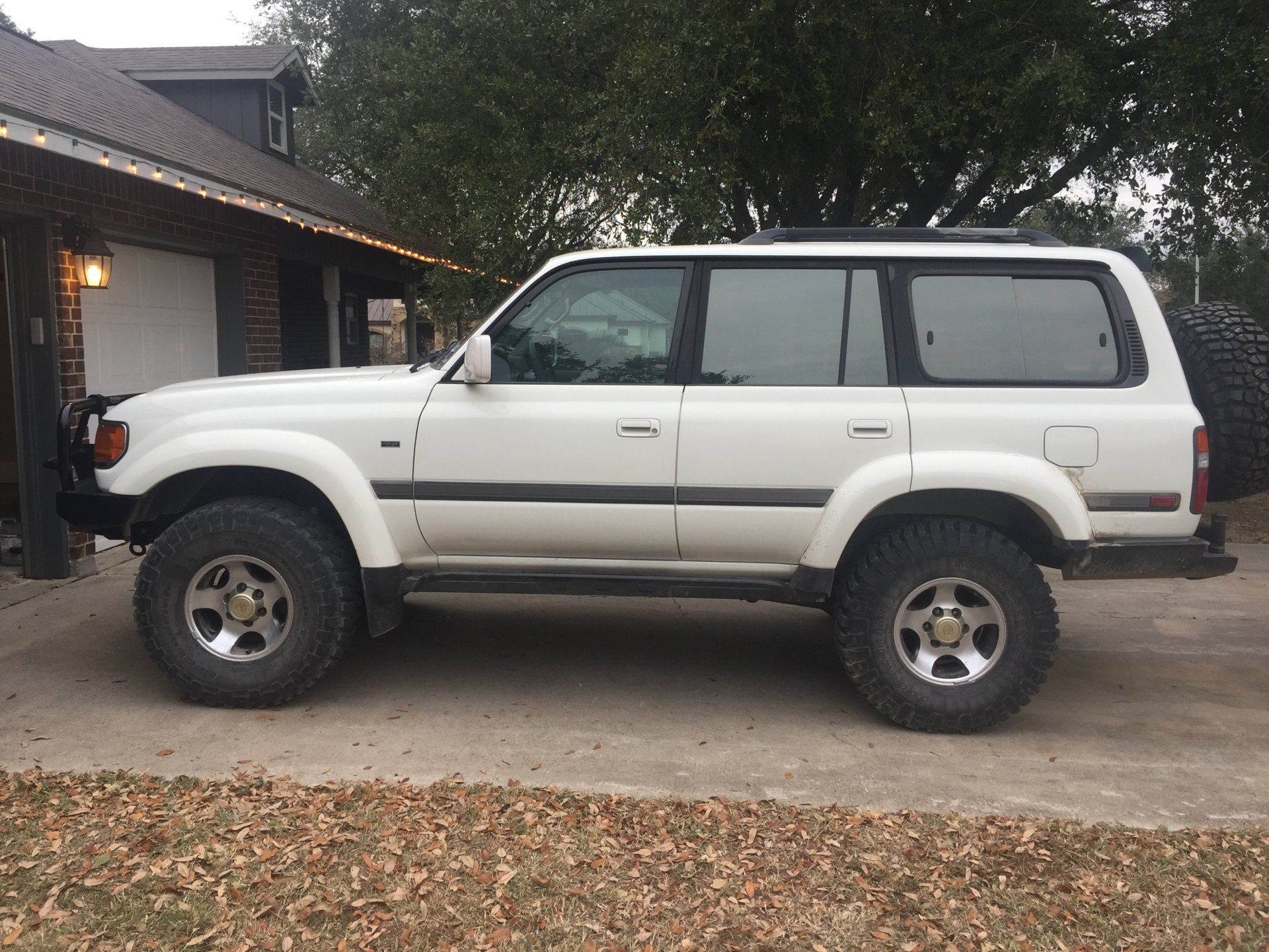

35s if you regear. Here is a pic of both. 33s on top and 35s MT on bottom. My pooch approves my 35s =)

I looks awesome. That back left driver tire is really tucked up in the wheel well. Are you saying there’s no touching there as well? I also noticed you took your flares off/fendors. Is that because they were hitting?
No touching anywhere on that thing. I took the flares off because I didn't like how they looked, wouldn't be an interference if I had left them. Sold a friend some Method 9" wide rims for his LX450 and they stuffed too.
Of note, I do not have any bump stop extensions anywhere, and do not have interference. I do have the @deltavs radius arms up front, which are narrower than the stock ones.
Edit: definitely a difference in getting up to speed and going over long passes, etc with the 35s though. BUT, once I get UP to 70/75, I can usually keep it there without issue.

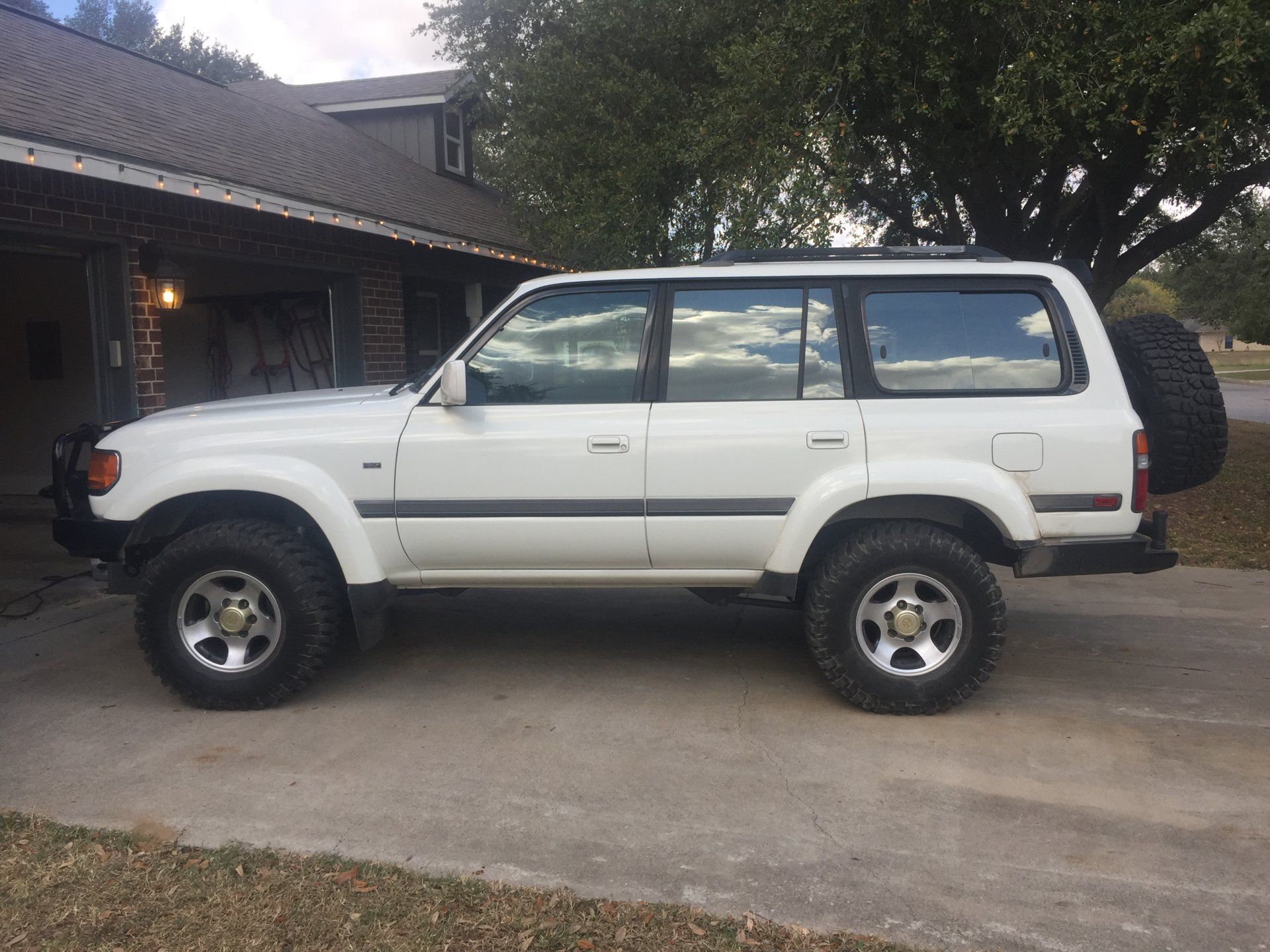

Definitely lost some power when going 33” to 35”. 4.88’s are my next mod. 33” tires look tiny with a 3” lift.
Top is 33” bottom is 35”
View attachment 1822531 View attachment 1822532
Thanks for sharing those two photos I really helps me decide. The larger tires as everyone says definitely look better on the Land Cruiser. Tough decision but commonsense says go with a 33’s but by ones cry once also leads me to want to do the 35s., Especially since I plan on to use it only for over landing and road trips. It’s not going to be my daily driver.
