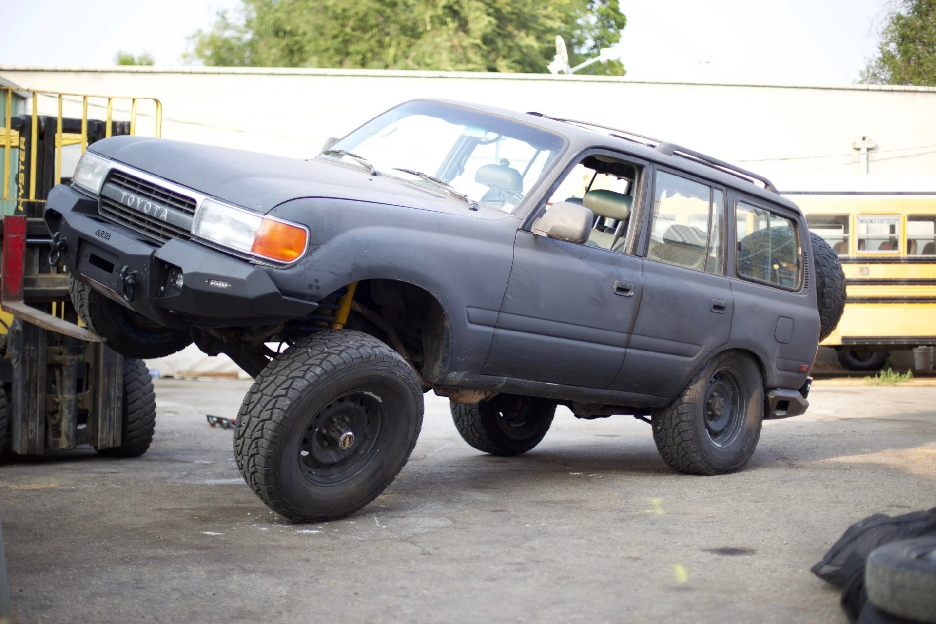

35s is the only answer. I have 315/70/17, 2.5 OME, FJ Cruiser 17" steel rims and can do this (with the tiniest bit of rubbing on passenger radius arm when fully cranked/flexed) :
I looks awesome. That back left driver tire is really tucked up in the wheel well. Are you saying there’s no touching there as well? I also noticed you took your flares off/fendors. Is that because they were hitting?
