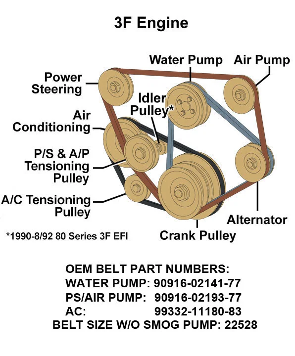

The 3FE has a poor belt design for the PS pump. As you tighten the PS tension idler pulley, it decreases the wrap on the PS pump pulley. I've had issues with the belt slipping on the pulley when the wheels were bound up in the rocks, but never on the road.
Use OEM belts and make sure the belt routing and tension is correct.
