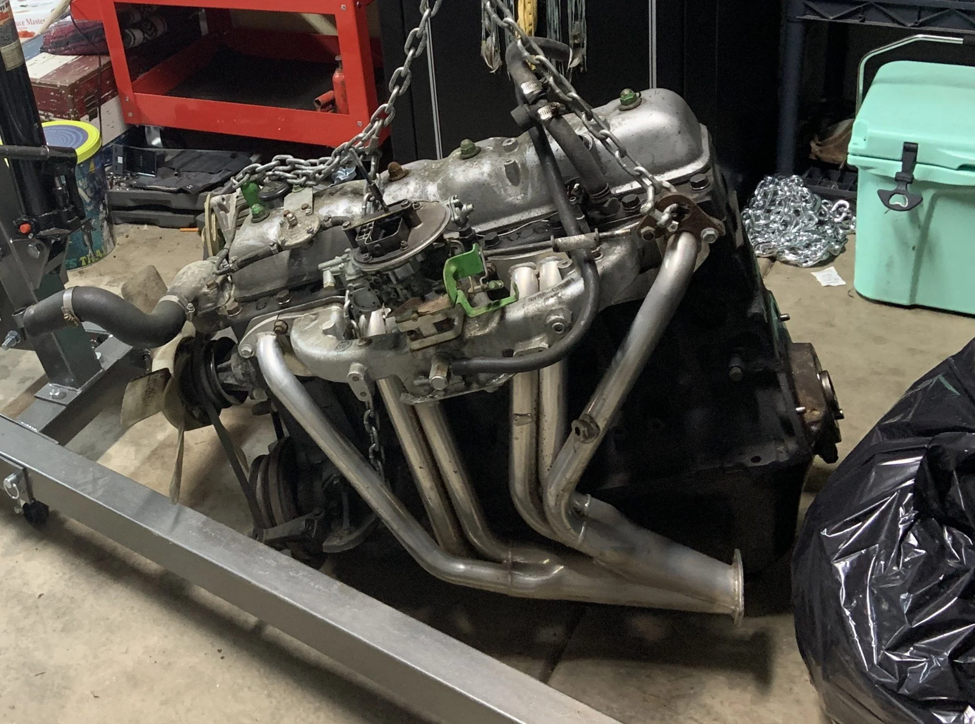

Thanks for all of this ! This is what I’m working with I guess I will just trial and error when I get to that point with the linkage.

That is preferable for fitment of other things around the engine bay. Headers are notorious for creating vacuum and/or exhaust leaks.
I hope you didn't scrap the old F engine (probably an F-and-a-half?)
no I still have the f motor, what are you saying about vacum leaks ? it was running in my buddies 1975 when we pulled it and runs fine like a top curious on what you are suggesting
That's not an OEM carb, looks kinda like a Rochester(?).
I think @FishTacos means that getting a header and intake to seal properly can be a pita due to flange thickness and stud size differences. They bolt on together with a single gasket.
I wasn't clear. That is exactly what I meant. It can certainly be done and it has been. If by some miracle (or by the vigilant work of a very good machinist) the flange on the header and The flange on the intake are the same thickness (+/- .001") the system will not leak if provided with equal clamping pressure. The original equipment intake/exhaust manifold also must be flat and the "ears" (the relief into which a washer sits where the studs and bolts pass into the head) should be checked with a micrometer to ensure they are the same thickness. But that happened once in a factory in Toyohashi, Japan so it is likely to be much closer to spec.
Also, there is no real performance benefit realized from a header on the 2F. Some might disagree, and there is the benefit of knowing you will not crack your intake manifold with hot exhaust gasses. But freezing the flapper in the diverted position or installing a block off plate between the two halves of the OEM I/E manifold ensures this also.
Short version: if I were in your shoes I would put the intake from the old F engine on the new 2F engine eventaully. Check it with a straight edge to be sure it is flat. Do the same with the head, get an oem toyota gasket, and torque it together. Unless you have an engine stand it would be safest and easiest to do that after you install it in the truck anyway.
It may be tempting to leave it as is because it is all together and ran just fine. I wouldn't blame you if you did. Come to think of it, just run it with the header for a while. If it works well...great. But dont get rid of the old engine and it's I/E manifold, carb, and down pipe. You may want them. They do swap directly.

That is a Weber, and a crack-repaired intake manifold. I fairly certain that mid-F and 2F locate the carbs at different locations; don't know about .5. What did it come with for a fuel pump?
